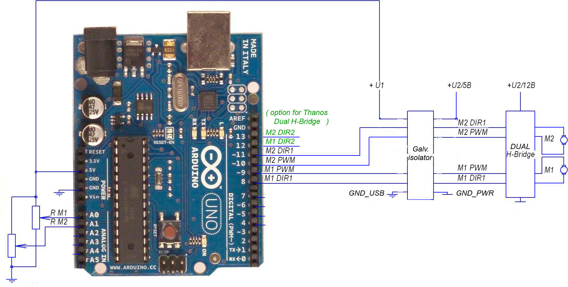

    I recommend to use the board with galvanic isolations ( http://en.wikipedia.org/wiki/Galvanic_isolation ) for each control lines. It may be based on opto-isolators as 6N137 (and you can use Thanos opto isolators board). And it may be based on transformer isolators, like ADuM1400 (http://www.platan.ru/pdf/datasheets/analogdevices/ADuM1400_1401_1402.pdf)

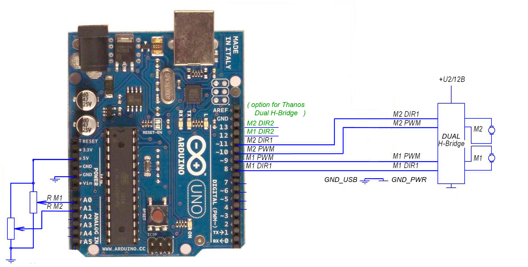

    Ups... Sorry, but some yours question I can't understand.
    At the topic you can see connection diagram. If you want to avoid galvanic isolation, then the diagram will look like this
    What do you mean?
    You must connect potentiometers to Arduino, not to H-Bridge.

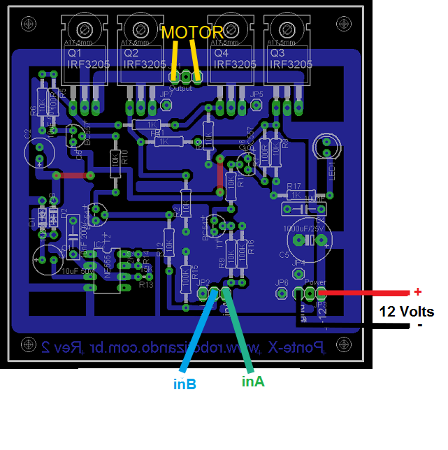

    this is my tread about my h-bridge,,,, its a simple h-bridge with pwm input signals.. all the h-bridges that i have seen theres a ton of pins to be connected... and my one only have 3 pins... 2 pins for directions and one ground pin
    http://www.xsimulator.net/community/threads/h-bridge-12v-40amps.4731/#post-45150
    could u help me connect it to the arduino if possible? i don't understand very much the diagram,, were i connect the pots?..I'm planning to build thanos h bridge its very simple but limited,, this one can handle 40 amps 12v.. thanks

    Hi Trust,
    As Prilad mentioned, you do not connect the potentiometer to the H-Bridge, they are attached to the Arduino. You can see the pot wires attached in his picture there to ports A0 and A1 (for the potentiometer wiper wires) and the positive and negative potentiometer wires are connected to v5 and ground.
    The two pins that you have on your H-bridge are for the PWM wire and the Direction wire coming from the Arduino. On the Arduino pin 8 is motor 1 (M1) direction (DIR1) and pin 9 is Motor 1 (M1) PWM. You will also need to run a ground wire from the Arduino to the ground pin on the H-Bridge but NOT to the same ground port where you connect the 12v power supply or connect the motor wires.
    I am not sure which of the two pins on your H-Bridge are PWM and DIR though. You might post the schematic here that you posted in your build thread.
    My own 2DoF platform has a similar setup using the Arduino but also using two Pololu755 driver boards.
    David

    this is the diagram of the hbridge,, as u can see inB and inA are for directions

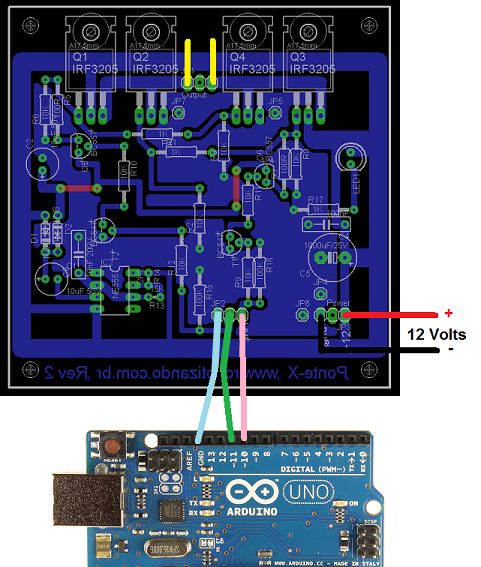

    i have discovered one thing.. the guy who made it,, says
    (to use pwm signals to control the direction speedy.. just connect the pwm wires to the input directions pins) and thats it... no direction wires needed... only the pwm to control directions ...
    can this work? look at the pictures

    Can you post the original site where you found your information? I am pretty sure he has one PWM and one DIR (and a ground).

    NO. Unfortunately it doesn't be work correctly. You can't connect your bridge directly to Arduino. You should modificate your schematics...

    I found the website where you are getting your information on this H-Bridge:
    http://www.robotizando.com.br/artigo_ponte_h_pg1.php
    Interesting read. It looks as if the author only wanted to make a circuit that could drive an electric wheelchair through direct user input so used an Arduino controlled by buttons. One button would turn off PWM A and one would turn on PWM B allowing polarity change and therefore reversing direction. This circuit does not indeed have a DIR input type as it looks like both inputs are "live" and having them both active high would result in magic smoke being released.

    Yes. This schematics can be modified with adding one chip 74ls02 like on this example

    prilads can u help me with the pot wiring? u diagram is confusing me...
  19. Historiker
    2,162
    9,205Coins
    +2,173 / 19 / -1
    The pot wiring is pretty simple. Look at the picture that he provided. On the bottom left of the UNO are ports A0-A5.
    He has motor 1 (M1) potentiometer wiper wire connected to Arduino UNO port A0
    He has Motor 2 (M2) potentiometer wiper wire connected to Arduino Uno port A1
    The wiper wire is usually the center wire on standard potentiometers but it would be best to verify this by looking at the specification sheet for the potentiometer that you plan on using. Multi-turn pots often have the wiper connector on the back or bottom of the pot.
    A potentiometer has three connectors or wires coming off it. A positive (+), a negative (-) and a wiper. Read the documentation for the particular potentiometer that you plan to use! ;)
    You can connect the positive wires from both pots together (common) and connect them to the v5 port on the Arduino UNO (see Prilad picture)
    You can connect the negative wires from both pots together (common) and connect them to the ground (GND) port on the Arduino UNO (see Prilad's picture).
