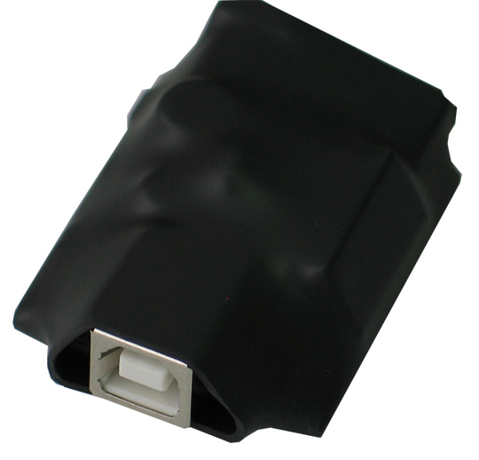

  7. doctorxeno
    doctorxeno Member
    Nov 10, 2013
    33
    607Coins
    +20 / 0 / -0
    I use a USB galvanic isolator.
    I am thinking it is something like that. Maybe use the 5v supply from ATX to power pots and controllers?
    The USB isolator has also a power jack. Is it an option to connect 5v to that jack?

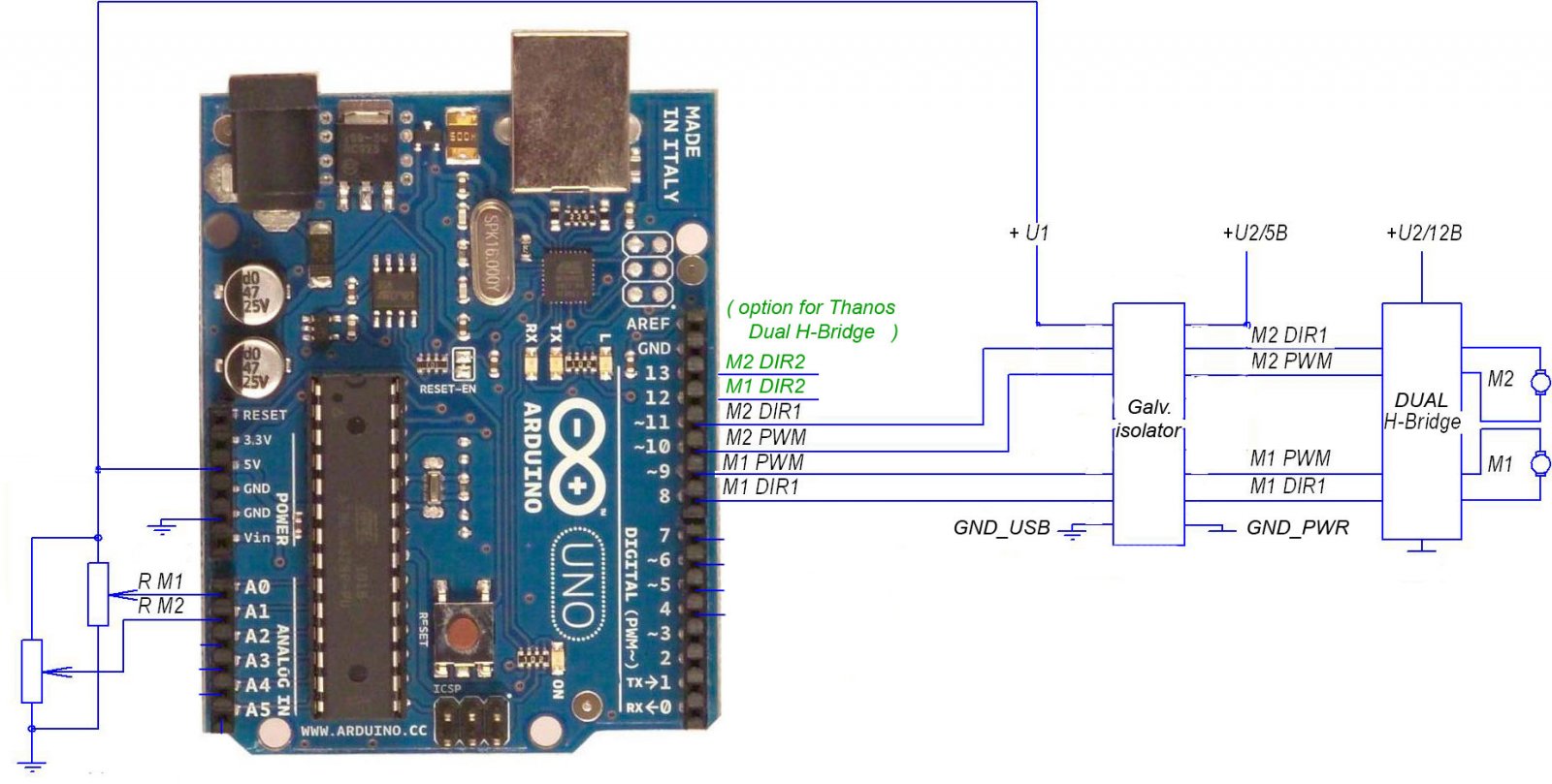

  8. RacingMat
    2,233
    21,073Coins
    +2,092 / 21 / -2
    hello!
    can you share a link about your galvanic isolator and your wiring?

  10. doctorxeno
    doctorxeno Member
    Nov 10, 2013
    33
    607Coins
    +20 / 0 / -0
    Well I found the problem. I had to set the KP parameters to a lower value and I have increased the minPWM. Now it keeps running.
    I will do some more testing for a while...
    Thanks for all the replys.
    Jeroen
