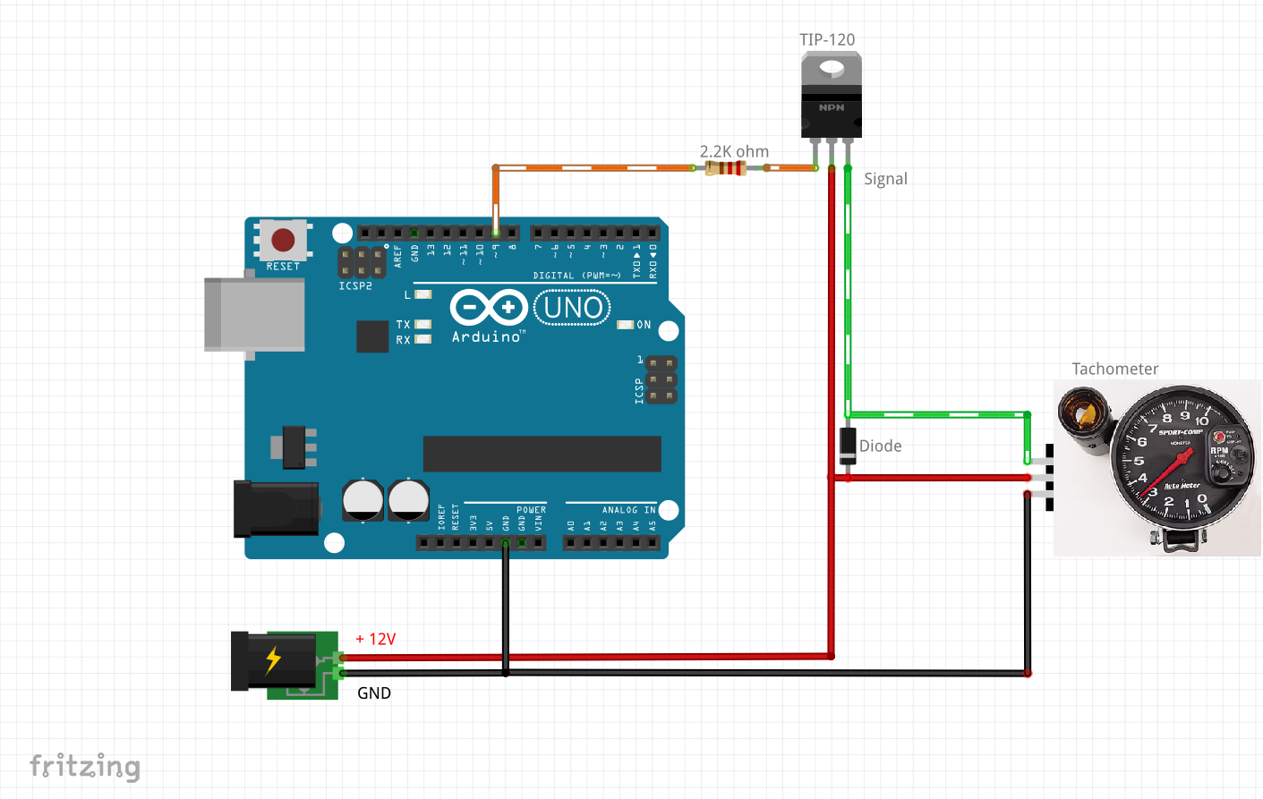

    I finally got it working removing 12V zener diode...
    I don't know why but it seems to be embedded in my aftermarker tachometer gauge

    hello experts, please help. If I connect the tachometer according to the original instructions, it does not work. However, if I connect the GND from the Arduino to the emitter, the tachometer works correctly. Why is that so?

    @peel , you just saved my life. I've been trying everything I could try, replaced all the components, with no luck. I just did the ground trick you suggested and now it works.

    Hey, all!
    I tried using the provided circuit for my tachometer (Auto Gauge 8000RPM) nothing worked. Then I checked my tachometer by quick taps to +12V with the green signal wire - the hand moved. So I realized that my tachometer is switched to a positive signal. Accordingly, I had to use a PNP transistor to work, so I chose 2N3906 - as I had it in stock.
    The total circuit looks as follows:
    Best Regards

    @AVSTech, After a week of fiddling around without a multimeter I had no way to understand why my Tacho was not working properly. Your explanation got me on the right path though. I could also get the needle to move by tapping the green wire to 12V. I searched around my old pile of electronics boards to find a suitable PNP transistor and used your diagram as a reference. It also happens to be a very small TO-92 transistor, even weaker than yours. I also used a very small glass zener diode and I don't even know it's specs, can't read it. Anyway it finally works! Thanks a lot! Signed up here specifically to make this post :)
