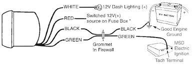

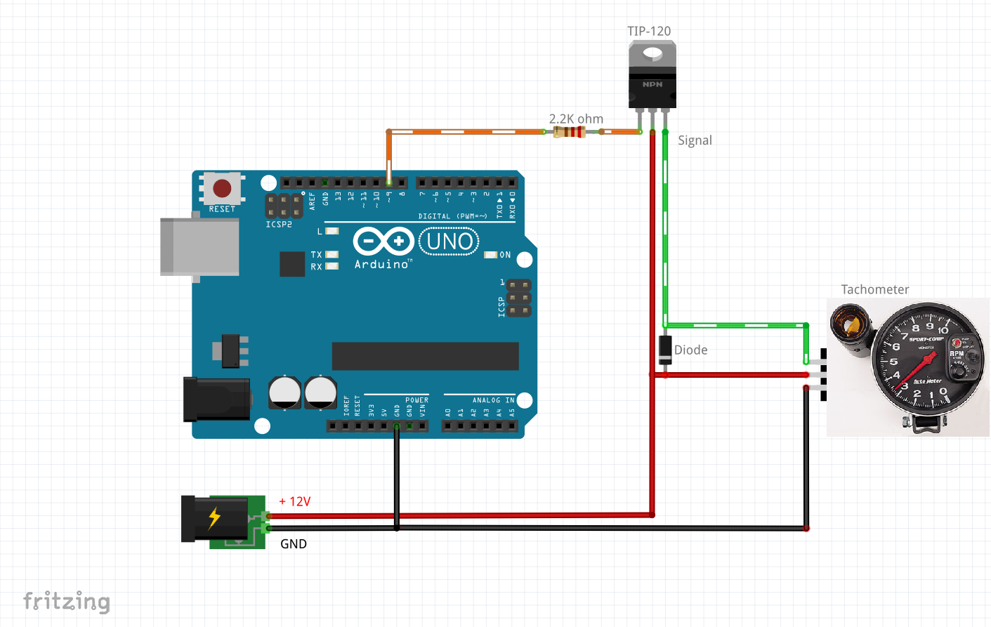

    # Wiring Diagram
    ※As of Oct 17th, 2014, I corrected the Wiring Diagram and uploaded it. refer to the picture below.
    In general, After market tacho. uses signal for Green wire like below.
    Mine is Autometer Monster tacho gauge, so I refered to wiring diagram above.
    But I think this diagram can be adapted to other after market tacho.

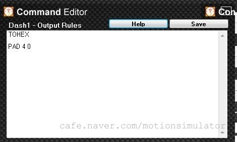

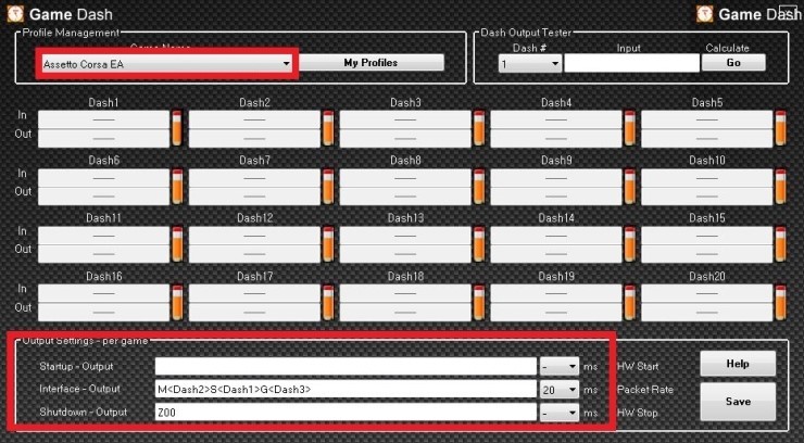

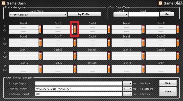

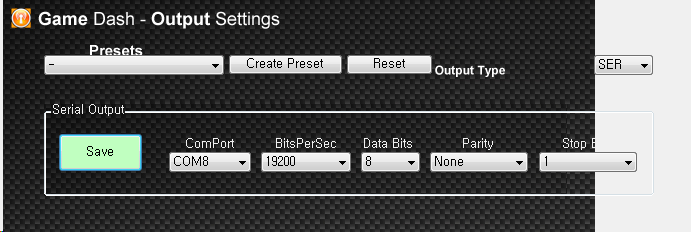

    # GameDash Settings

    Oh. My mistakes! I drew wrong wiring diagram. don't use above.
    I'm going to redraw and upload ASAP.
    So sorry for my mistake!

    I posted wrong diagram again on Oct 13th, 2014.
    Now I've corrected it and uploaded.
    please refer to the diagram on the main thread.

    Do you inted to light on the Dash Lightning?
    Maybe you could screenshot the GameDash profile while the game is running so you could figure out the names of data

    Hello ,
    what arduino UNO version do you use?...can i do the same with UNO R3?...
    also...don't you connect the power supply to arduino board?

    Hi, f1simgames.
    You can use arduino uno r3.
    I've confirmed arduino nano, uno and mega all of them are working fine for tachometer.
    And the answer for the second question is 'No'.
    The arduino is powered by USB connector.
    Any questions are welcome. :)

    Built this, works like a charm, thanks for instructions :)
    However, some of the plugins give rpms ten times too little, for example if true rpm is 1000, in Gamedash it is 100 rpm.
    Formula MATH * 10 doesn't seem to work. Any ideas how can I get Gamedash output ten times greater? Output is given in hex format in Arduino code and in Gamedash output.
