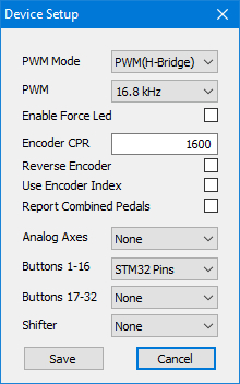

    Switched to mmos.
    Made enclosure for STM32 & Arduino. Axis are connected via usb cables.

    Level of Ai 120%. Low agression.
    Powerfull FFB, motor takes 12A, with rated 14A. Good result with no super cooling of the motor to run it.
