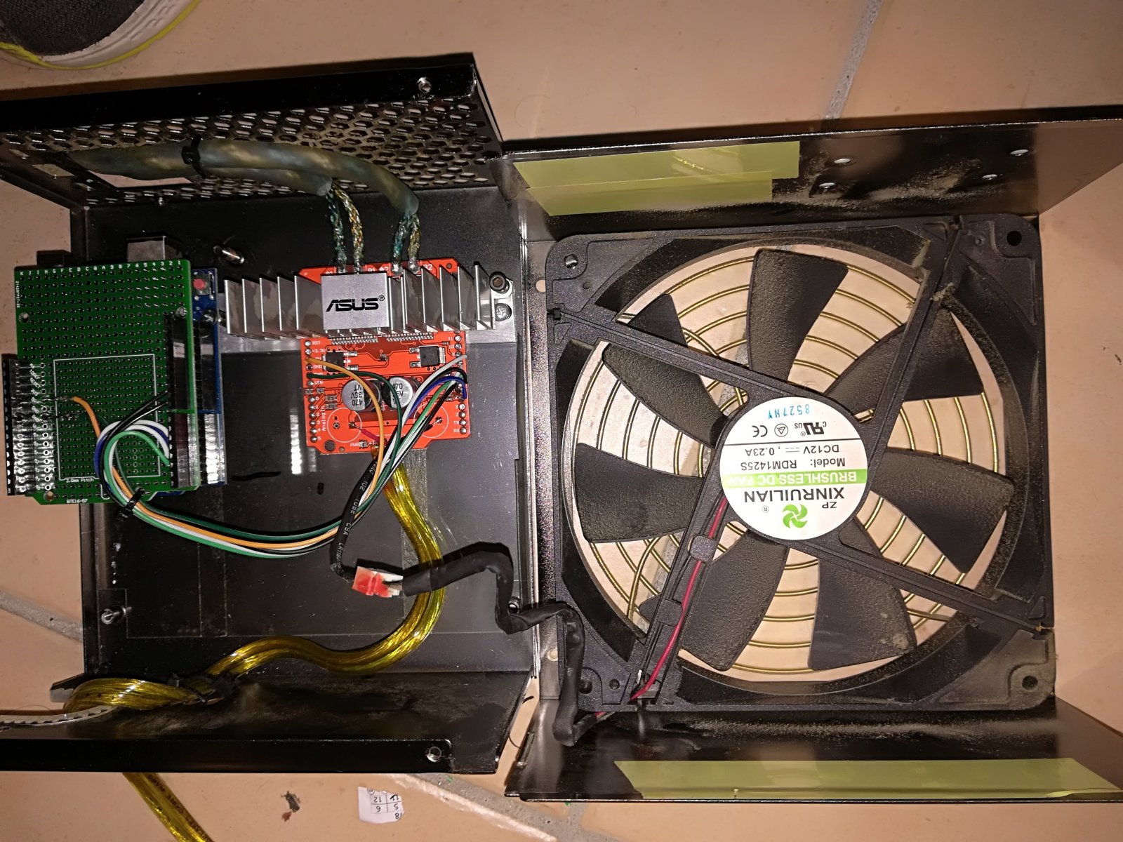

    Guess BTS needs a better cooling, to how it is done on default. The radiator seems not joined properly, at all, to that.
    [​IMG] [​IMG]

    @Sieben
    you could put the bts in an atx case and use its 12cm fan to keep it cool.
    in addition to spreading thermoconductive paste between heat sink and pcb (not too much)
    this and photo of the 2 dof drive, but for the steering wheel ff I did the same thing and it has been working for more than a year without any failure or thermal block

    another example of a first attempt, then moving on to bts 43a
    cooling below and above

    MarcoMade very cool. Thanks for sharing. Have got some prepared fans too to be attached too.
    Yes BTS needs some additional work with thermo paste and some fans too. That’s true.
    I decided to make own couse curious. ) And one can make with realy a good powerfull mosfets. With "whatever amperage". Like 180 Amps, or even 300. Guess may be will need even no cooling for them).
    Also there is, as some misconcept or what, conserning the use of two bts it parrallel. Was confused also with all that stall curents etc. and realy diff info on it. One BTS should coupe with the currents it is made for to handle. So no much need to add another one. Seems that must all depends on the power supply Amperage only.
    Checked the STM32 board I've got, and it is 3.3 volts compared to Arduino's, that is used, with ~5V controlling signal. Some mosfet gate drivers should be made additionally. If not go to the Logic level Mosfets to work with STM32. Seems to be not the very best option.
    Also fired up IRacing, and it gives good FFB. One side for now. But it works allright absolutely. And no heat, at least in a short run. Don't know how will cope with full version, when both pins attached. Hope will be no conflicts, and fried mosfets due to that. But it is also, all is a sorted out issues.)
