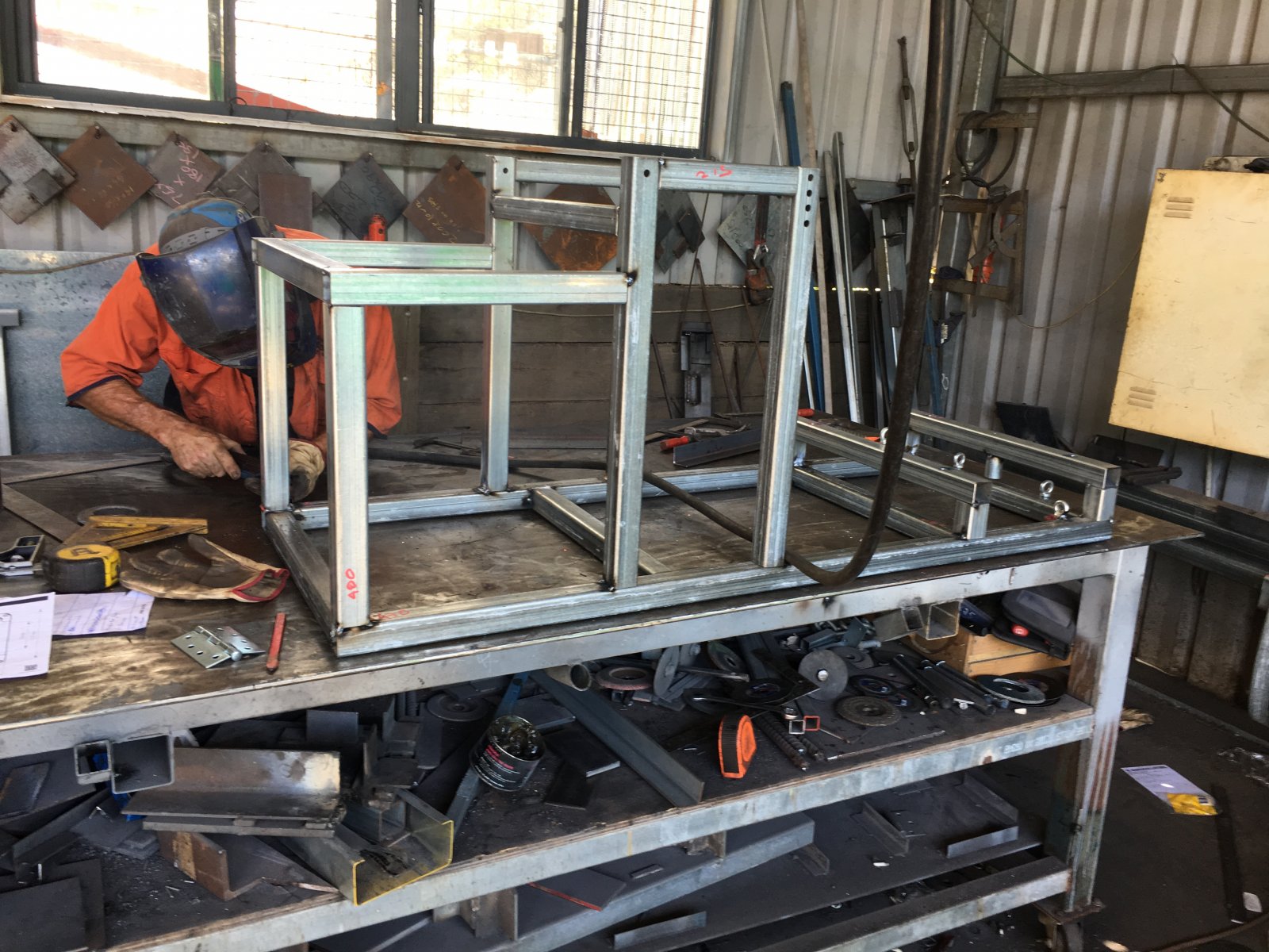

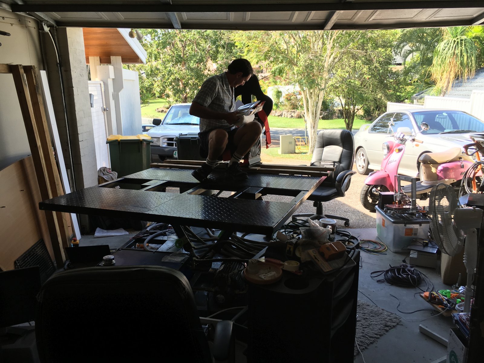

  12. Marc Wannenmacher
    Marc Wannenmacher New Member Gold Contributor
    Oct 26, 2014
    - 310Coins
    Hey guys I have added some pics of my simulator as it is starting to move along very nicely. I will get some pics of the cockpit attached to the motion frame shortly.
