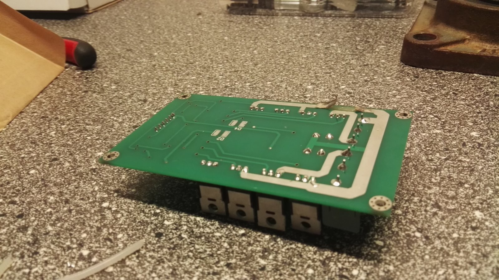

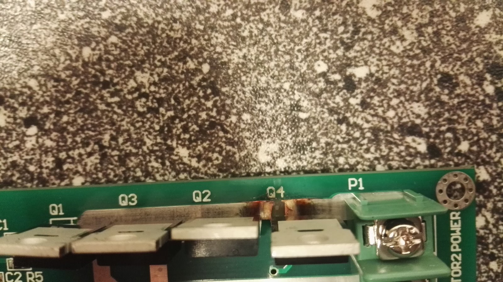

  6. zylle
    zylle New Member
    Oct 15, 2016
    21
    Denmark
    124Coins
    +11 / 1 / -0
    I can second your experience with that cheap h-bridge, it lasted me 5 minutes of low-amp- playing around before it sparked and began to smoke! :D
    2x pololu h bridges are now ordered and on their way :)
    Your code works flawlessy with 2 motors btw, its awesome, thanks a lot!
  7. RacingMat
    2,233
    21,083Coins
    Bad news... Hopefully your arduino has not been destroyed like mine did when these Hbridge blew up.
    Thanks for your feedback :)
