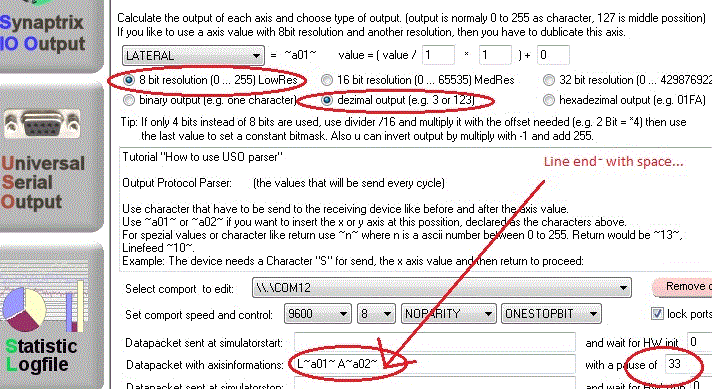

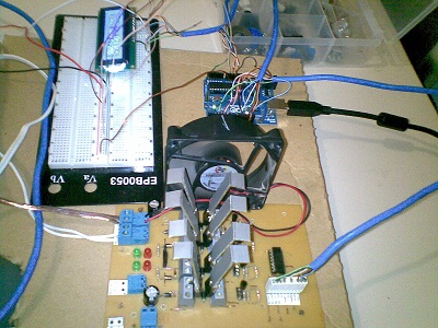

    can you send me the picture of the profiler setup and the sketch for the arduino please?
  14. juniou
    juniou New Member
    Jan 8, 2011
    12
    Brazil
    271Coins
    the sketch below, it is not a P.I.D sketch yet, is only a servo-control that drives the motor to value mapped from USO (0-255) 8bit resolution. the sketch has a better perform running in 9600bps, because the Read_Lateral (function) uses delay to wait strings from serial... this code is based on http://roamingdrone.wordpress.com/2008/ ... ntiometer/

    void Read_Lateral(){
    delay(1);
    int Lateral100 = Serial.read()- '0';
    delay(1);
    int Lateral10 = Serial.read()- '0';
    delay(1);
    int Lateral1 = Serial.read()- '0';
    //Verifica se e centena dezena ou decimal... =]
    if (Lateral1 < 0) { lateral = Lateral10 + 10*Lateral100; }
    if (Lateral1 < 0 && Lateral10 < 0) { lateral = Lateral100; }
    if (Lateral100 < 0) { lateral = 127; }
    if (Lateral1 >=0 && Lateral10 >= 0 && Lateral100 >= 0) { lateral = 100*Lateral100+10*Lateral10+Lateral1; }

    Dear juniou,
    i'm interesting with your project using arduiono + dsmhb, please send us the layout for connecting? and also the complete coding.
    thank you very much
  19. juniou
    juniou New Member
    Jan 8, 2011
    12
    Brazil
    271Coins
    definal,
    you can define your own layout,
    you just need to declare the variables according to you cable connections... like:
    #define MOTOR_EN_PIN 6
    #define MOTOR_RT_PIN 2
    #define MOTOR_LT_PIN 3
    #define MOTOR_EN_PIN2 9
    #define MOTOR_RT_PIN2 4
    #define MOTOR_LT_PIN2 5
    I sugest you to understand how Dsmhb from Thanos works...
    and check some codes on www.arduino.cc Digital\Analog pins examples...
    If you have some basics of how it works... you can define your own cable pinout between arduino pins and dsmhb pins
    The above code, is the complete sketch, and the cable layout is on the code ;-)
