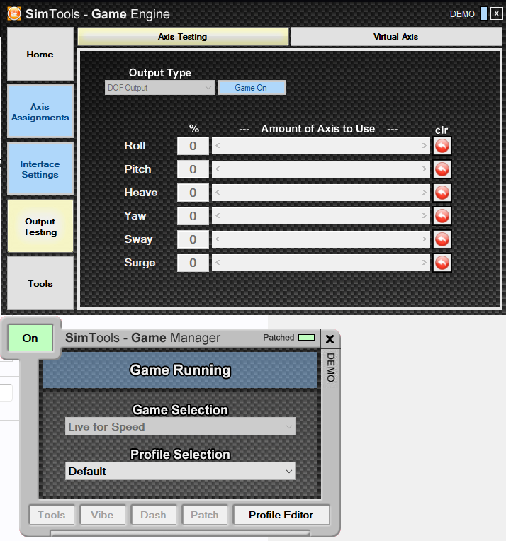

    1: How can i see/monitor the axis changes in Simtools? - Like yaw, pitch, heave, etc... Whenever im running the game with "Output testing" turned on with Game manager connected so is all of the axis still.

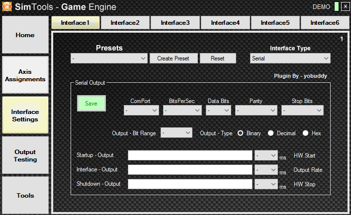

    2: How is the Interface Settings supposed to be setup? - I have seen many use the "Serial Type", is that correct for my case? Im aware that the "COMPort" is supposed to be the same port connected to the Arduino. Main thing im wondering over is how to fix the "Interface Output", everyone writes like [A<Axis1a>], how does it work?
    3: How do i connect Simtools with the Arduino? - Is there a special way to get a connection between the 2, or is it something with the code on the Arduino?
    Any help or solution with the questions is highly appreciated

    Code is required on the Arduino, the most common used by members using an Arduino is the various versions of SMC3, depending on what control hardware is used: https://www.xsimulator.net/community/faq/arduino-code-for-use-with-various-hardware-and-simtools.31/
    The code has to be flashed to the Arduino and all the parameters refined before setting up SimTools.

    Also note that once on the track in the game, you need to hit 'v' on the keyboard to get into cockpit view, or the file that needs patched for motion will not be created.
