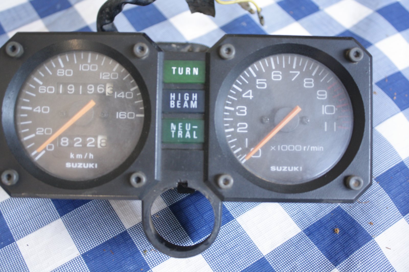

    What im going to be trying to acheive is using this Suzuki DR350Se Tach whit x3 addjustable leds via a pot and switch for tuning of the rpm range and the undershift lights. I am planning to use thus with Asseetto Corsa EA plugin and ST 1.3 if possible.

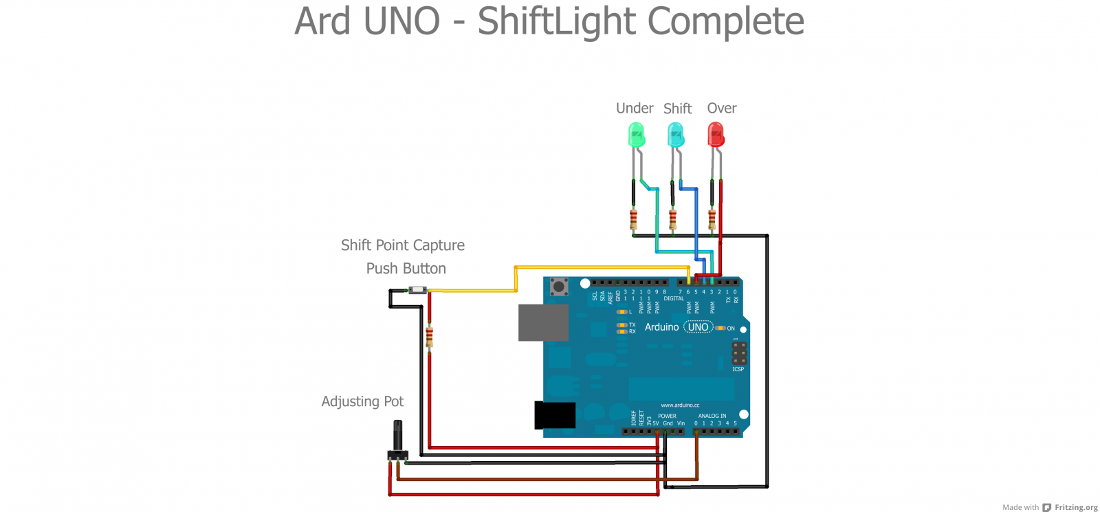

    I had seen an older post made By @eaorobbie(Thanks) about an Ard Uno adjustable shift light. Thought that would be a good place to start as in getting the shift lights up and going b4 the tach(and learn some code along the way).
    so i followed the wiring guide supplied with the Ard Uno Adjustable shift light post looks like thus arduino Shift Light - ShiftLight Complete_bb.png
    Well pretty Much the same as that although im using a toggle switch for the rpm button and 10k resistors on the leds and switch.I Have looked at that guide multiple times and think i have followed it pretty well.
    Oviusly not well enough cause im having a problem with getting it going.
    I get info on game dash and im certainly connected to the game threw the manager, the Rx light on the 2560 comes on as im getting in the game but the 2560 with leds,and switch dont do any thing, also when i turn the pot yellow led is always on and if i turn the 10k pot it just switches between the green and red leds so always two leds on, i tried reving and setting the shift point but lights don't even budge they are just always lit.

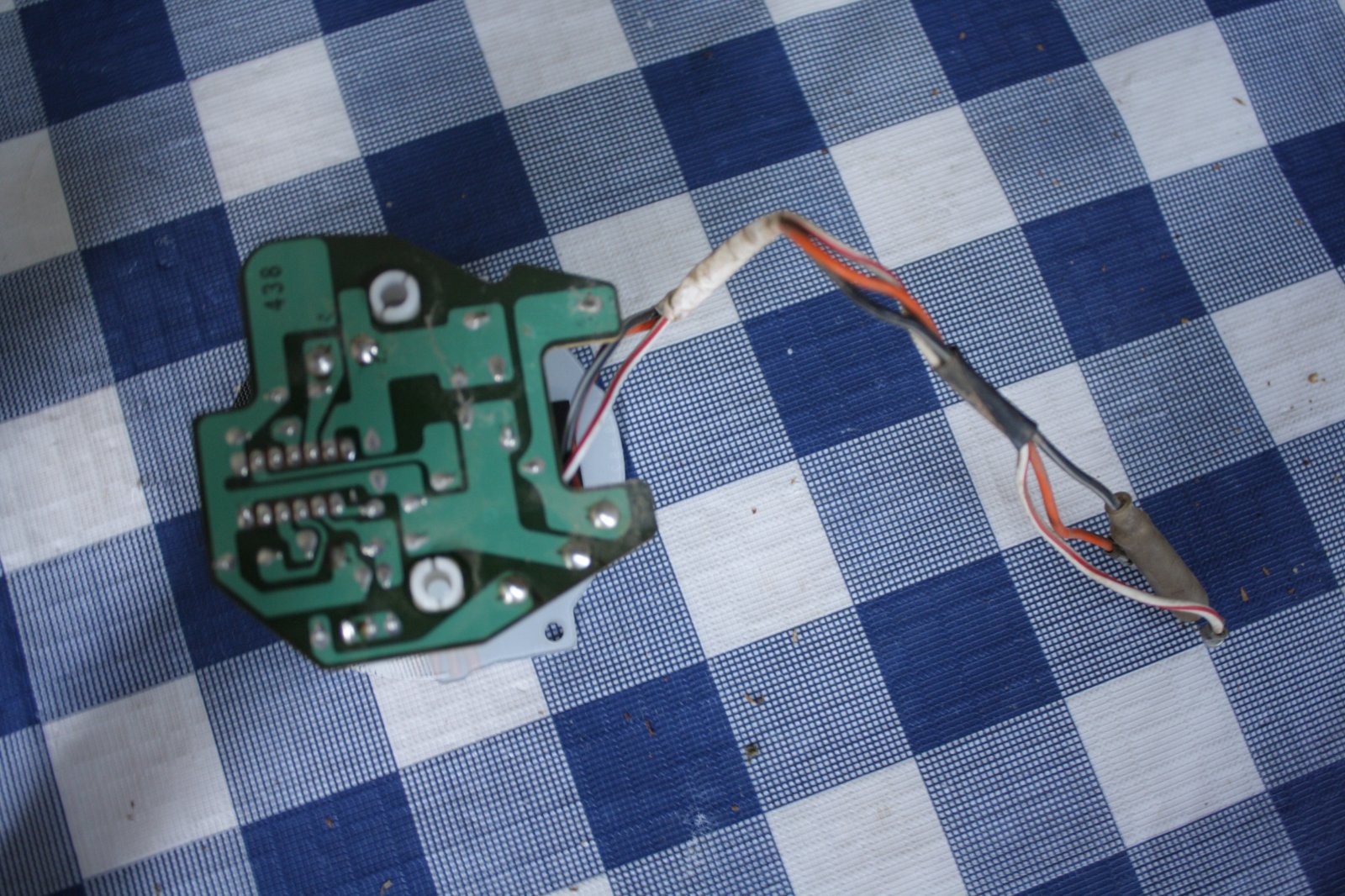

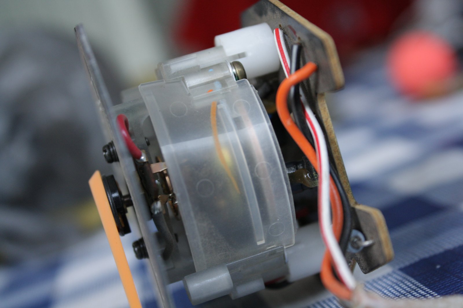

    Thanks @noobeast for that link, pretty much what im tryng to do here except i cant use the speedometer because it is mechanical but seen that post i know now the tachometer should be achievable. he didnt give much info on the setup and how he got it to work in the end. i did see some of the game dash setting he used though and i really dont understand what to do with the commands with the pencil, what i have now could work with the shift light but for some reason i cant get that to work atm. i understand im not guna get this done in a couple of days, the building of the project i can do and the wiring peace of piss but the coding arduino/game dash will be the time consuming part as i have little knowledge on either.
    I investigated the tachometer and traced the wires, the orange pretty much leads to the positive of the motor and black obviously negitive and the red and white a a chip on its pcb so i read on oldmates yamaha gauges i hook the signal to one of the PWM ports on my Ard 2560 and orange to 5v black to ground. i will test this out once i can get the shift lights cracking.

    Always better to try and use the same board as advised in the code. Sometimes code doesn't work between models when the IC changes and port numbers are assigned differently e.g. a pwm port on one board may be an analogue on another.

    @Alexey i understand this but just for the moment i want to get by with what ive got uno/mega not much different just some more digital+pwm plugs and the same amount of analogue i beleive there shouldnt be much different between the two hopefully i know im guna havto do some of my own code but hey thats the shits and giggles part right

    It should be as simple as comparing the port numbers assigned to the uno in the code and match what you need to the mega.
