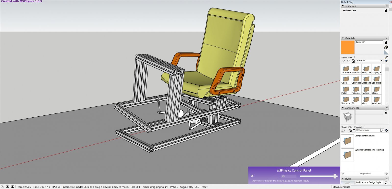

  7. fabrizio1203
    fabrizio1203 Member
    Nov 15, 2022
    40
    - 7Coins
    +9 / 0 / -0
    I'm still figuring out the geometry of the rig and testing the various options on a Sketchup 3D model just moving the slide controller on the bottom right corner.
    You just need to install the MSPhysics Sketchup plugin.
    If you find them in some repository you can also use 3D models of the commercial parts you want to use, such as aluminum profiles, seat and hardware in general.
    As soon as I've finished I will connect Simtools to Sketchup to see how the 3D simulator moves during a flight.
    I've no direct experience yet but as noorbeast wrote there is some info available in the net.
    I'm currently experimenting with Roll.
