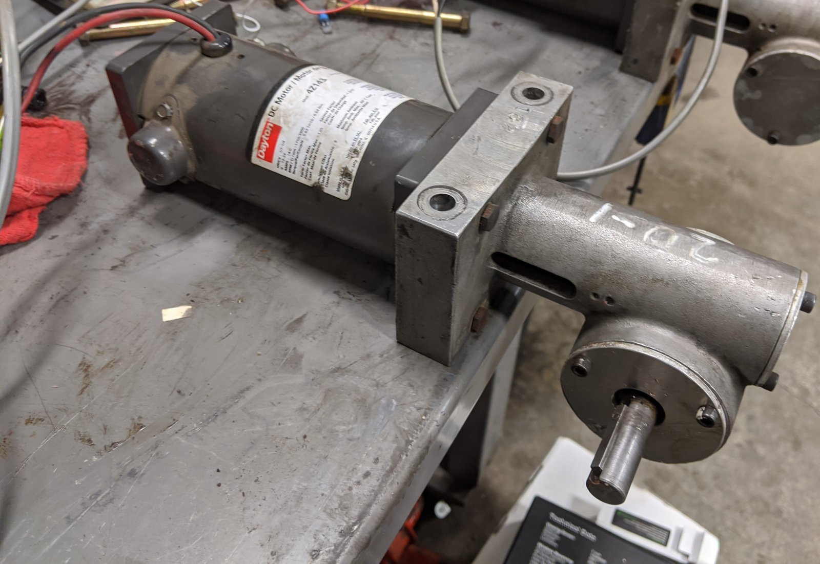

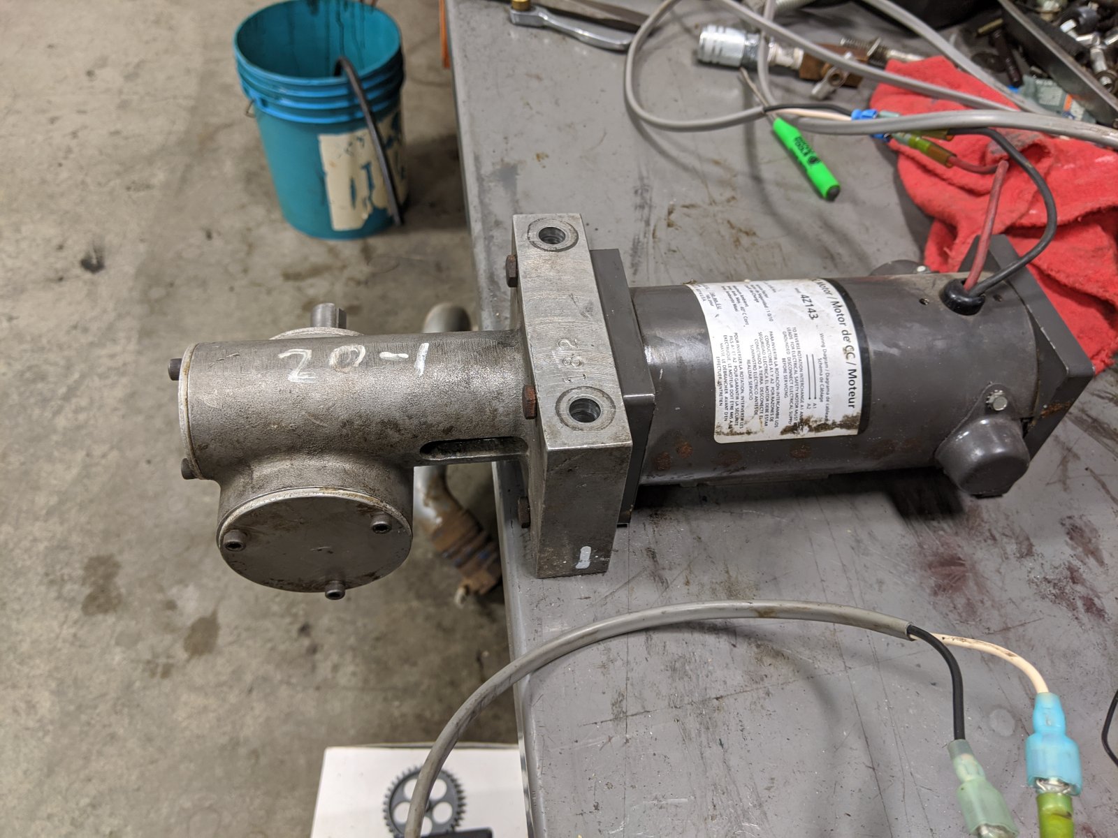

    I got a couple motor andGear boxes that I like to make a 2DOF full sim rig made of extruded aluminum. I think they should work, but I was trying to find the gear boxes on-line and cant seam to find the same ones. but I am able to find the motors threw Grainger. https://www.grainger.com/product/DAYTON-DC-Permanent-Magnet-Motor-4Z143
    some of the specks are 12/24 v RPM 1750-3900 HP 1/7.
    I count the gear ratio and its 20:1 it spins at 9o RPM at 12v and 170 at 24V.
    I was going to give them a try at 12v but think it work a lot better at 24v with a 50:1 ratio.
    New member here thought I get your insights.

  3. Justin M Hopp
    Justin M Hopp New Member
    Feb 15, 2020
    81Coins
