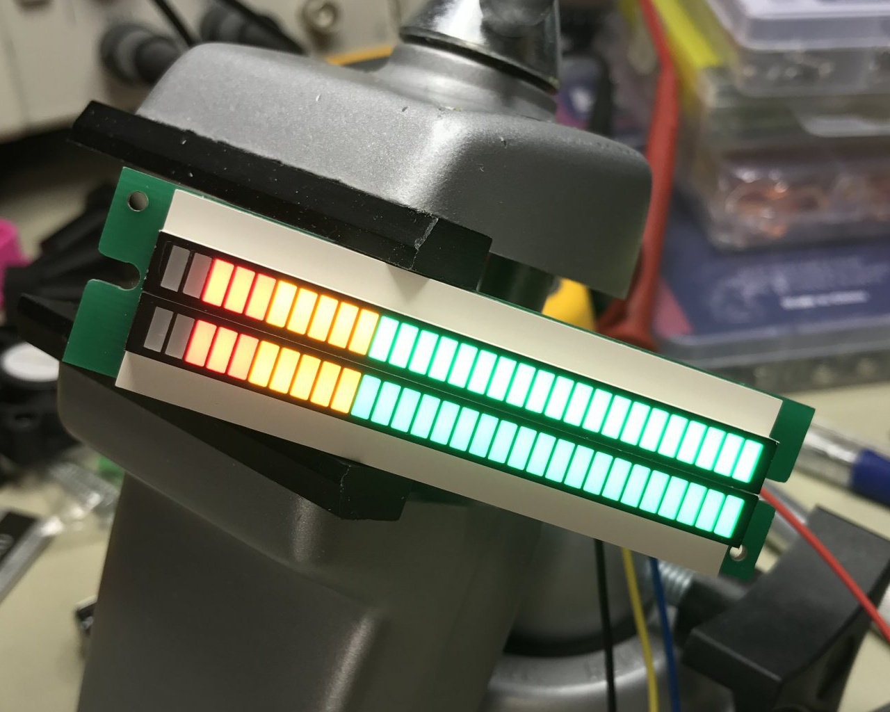

    Here it is in action. Works great! This is a replay of a balls out run at Donnington Park in PCars2. Sorry about the shaking but it was pretty violent. Post on page 2 has more info.
    My seat reclines so I can approximate seat style when flying and driving but that changes the CG, unbalances the platform, and make the motors work harder in one direction than the other. I had the idea of putting auto ammeters in the motor circuit which would show the balance of the sim through the needle swings but turns out this isn't such a good idea the way I was doing it. The ammeters pass the full current so need heavy gauge wire run wherever the meters are mounted, the resistance of the meter is fairly high so it shaves voltage and torque off the motors, etc.

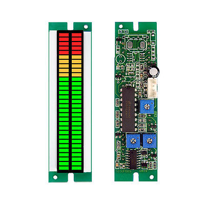

    I found these on eBay from a seller called "ledbargraph": http://www.ebay.com/itm/30seg-66mm-...sure-and-Display-DC-Value-0-5V-/162566320763? for $35 each. I think it's just the Chinese company that makes them but not sure. I got his last two in this listing but bet they post more.
    Here is the datasheet from the manufacturer: Http://www.barmeter.com/download/as230p-66s 1.0.pdf The part listed at eBay (AS230P-66S 05L8511R8511) is a 0-5V voltmeter with both displays the same with green, yellow, red segments. The zero and max is adjustable. I figured that the two displays would be the positive and negative swings of a single motor and two modules would be needed for a 2 DOF rig. Since it's a 0-5 V meter on each side, it will take a little bit of op amp circuitry to rectify, split, and filter the PWM output of the motor controllers and turn it into a 0-5V signal for the meters but that really should be pretty simple. A differential amp on the front end will solve the polarity swap issue and the rest is standard stuff. I'll post more details as I work it out.
    It still needs a shunt to convert the current into a voltage, but there are some 0.001 ohm shunts that will only drop 50 mV at 50A and shouldn't cause problems with voltage drop or torque. Routing a low impedance low voltage to a remote meter location is trivial. Costs a little more than cheap auto ammeters but should still be around $75 per motor give or take.
    Probably not necessary for fixed seats, but I think it will be for reclining and adjusting at will.

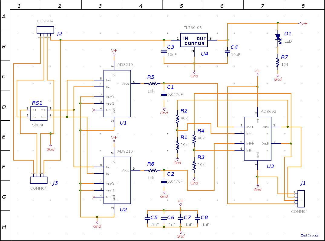

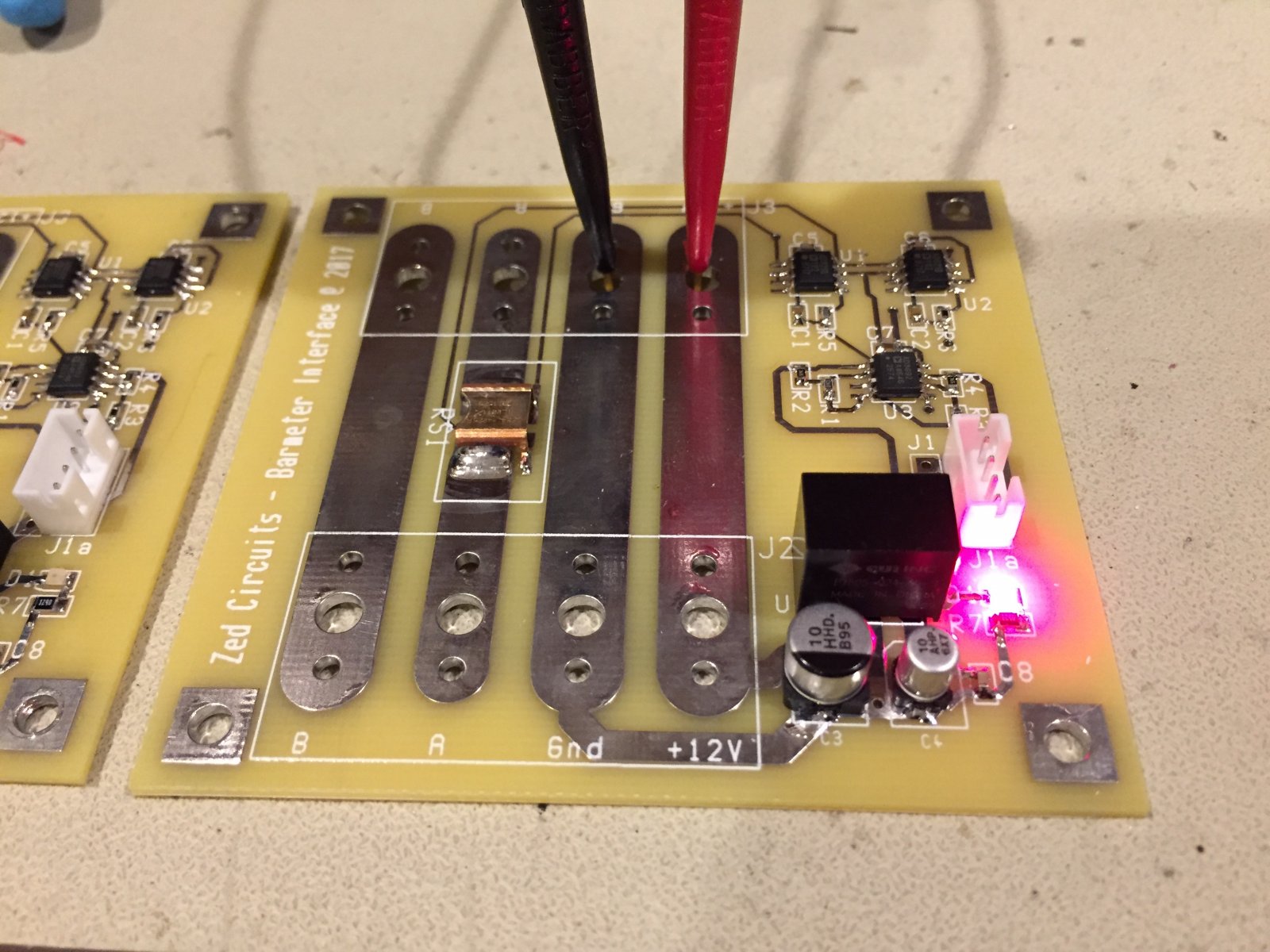

    Just an update if anyone cares - I got the schematic worked up for an adapter/signal conditioning add-in board and have started routing it. To use these bar graphs, I need to turn the motor PWM duty cycle and current into a 0 to 5 volt voltage that the bar graph voltmeters can turn into a proportional number of lit LEDs.
    It turns out this may be very simple thanks to some newish chips from Analog Devices for measuring small voltages on big common mode offsets - the chip I'm using is a differential amp designed specifically for amplifying shunt current voltages in this kind of application. The voltage generated across the shunt by the current flowing through it will be proportional to the current. By low pass filtering it, since it's both the current and PWM duty cycle, we get the output voltage proportional to both the current and duty cycle to get total effort of sorts.
    Under low load, the duty cycle can be high but the current low. Under heavy load, the duty cycle can be low but the current high. This convolutes the load with the motion but in periods of high motion back and forth, the extents of lit LEDs should then be mostly due to current and motor loading. But all I'm really looking for is each of the two bars to light up about the same length when the motors are doing some kind of oscillation. This could especially benefit form @value1's sinusoid plugin for setup. (https://www.xsimulator.net/community/threads/output-a-sinusoid.10283/#post-133006)
    A simple passive low pass RC filter turns the PWM duty cycle and current into a simple voltage level, and that feeds into a voltage follower with gain to make the output range 0 to 5 volts for a 0 to 50 A and 0 to 100% duty cycle. That's what goes to the meters. I use twin parallel circuits with the differential amps' inputs wired with different polarities on the same shunt so each path lights up on one polarity current or the other to drive the two bar graph displays that make up each module.
    Everything uses a single supply voltage of +5 V and there are now 7805 pin- and footprint-compatible switching power supplies that I've just got being a parasite off the 12 volt lines that feed the motor controller. These boards will just get inserted into the connections between the power supply and the motor controller and the motor controller and the motors, one for each DOF axis. Four wires in and four wires out though one motor leg doesn't need go go through the board and can just bypass it and the 12 volt power doesn't need to be pass through either. The board just needs 12 volts. I'm setting it up for pass through though in case that's more convenient.
    It's looking pretty trick, pretty simple, pretty cheap, and pretty small. Hope to send out the boards this weekend to get burned and have everything arrive in the next week or two to test it out.
    Then it's just fingers crossed it actually works the way I think it will.

    Yeah, that was not my best idea. When my motors were going to be towards the pedals end of the platform it wasn't so bad because the wires would go right by where I wanted to mount the meters. But once I got all the parts and started fitting them, I didn't have the space to put the motors in the front and had to move them to the rear. Then a wire would have to loop way forward and back. It was doable but not the best solution.
    Then @mirkobastianini mentioned a panel meter set up to measure current that he wanted to use and it had a shunt. That solved everything and I feel kind of silly for not thinking of this right out of the gate. The shunt can go close to the power circuit and the voltmeter can be remote mounted. I'm putting chokes on the power wires between the motor controllers and the motors to block the reverse EMF slams with PWM and that will also protect this stuff since I'm putting these circuits between the motor controllers and the coils so they will also be on the lower noise side. Voltages and currents should be pretty tame.
    The amp I'm using is the AD8210 (~$5 at DigiKey) in unidirectional operation with ground referenced outputs. I just swap the polarity of the wiring to the shunt to have one read current in one direction and the other read it in the other. They will each just hang at 0V output when the current is flowing the wrong direction for them so that way one bar lights one current direction and the other bar lights the other. After that and as above, it's just a simple RC low pass filter with center frequency of 100 Hz and another AD chip (AD8692) which is a rail to rail 5 volt single supply dual op amp as a voltage follower with gain of 5 to take the 0-1V outputs of the 8210 and make them 0-5V for the Barmeters. The 100 Hz filter should still make for lively displays while turning the PWM into a fairly steady voltage for whatever the PWM and current are at the time. Power for this stuff is from a CUI P7805 which has basically the footprint and pinout as the old linear 7805 regulators. Never had seen those before but they are a thing now and very cool. It's got a 500 mA output so will easily power the Barmeter it's connected to as well as the analog circuitry all from the 12 volt rail.

    The final schematic.

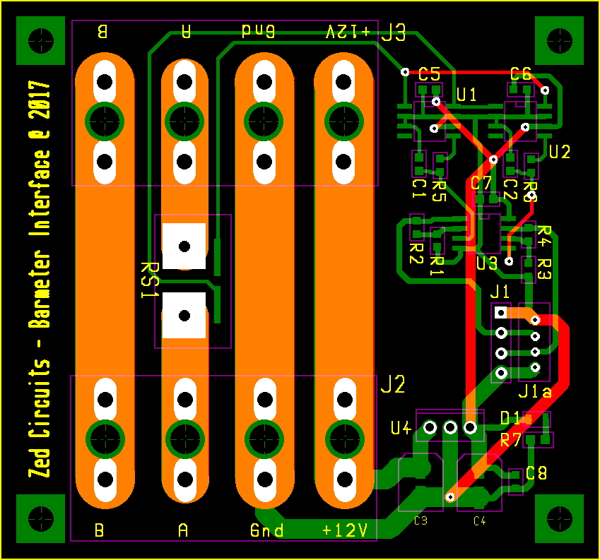

    The tentative board. I'm waiting on the parts before I submit the board for fabrication just so I can make sure everything has the right footprints and fits. Once you get a stack of otherwise good boards back that you can't use because you dorked a footprint, you don't want to risk it again.
    Final board size is 3.0" x 2.8". I set it up for both high current connectors as well as through holes for up to 8 AWG wire.
    So close to dancing bars... :popcorn
    Update - once I got the parts in I had to make a slight change and after not looking at the design for a few days, changed a few other things, added a legend for the connections, etc.
    Just got through placing the order for the boards so should have them in a little over a week and can finally see if it works.

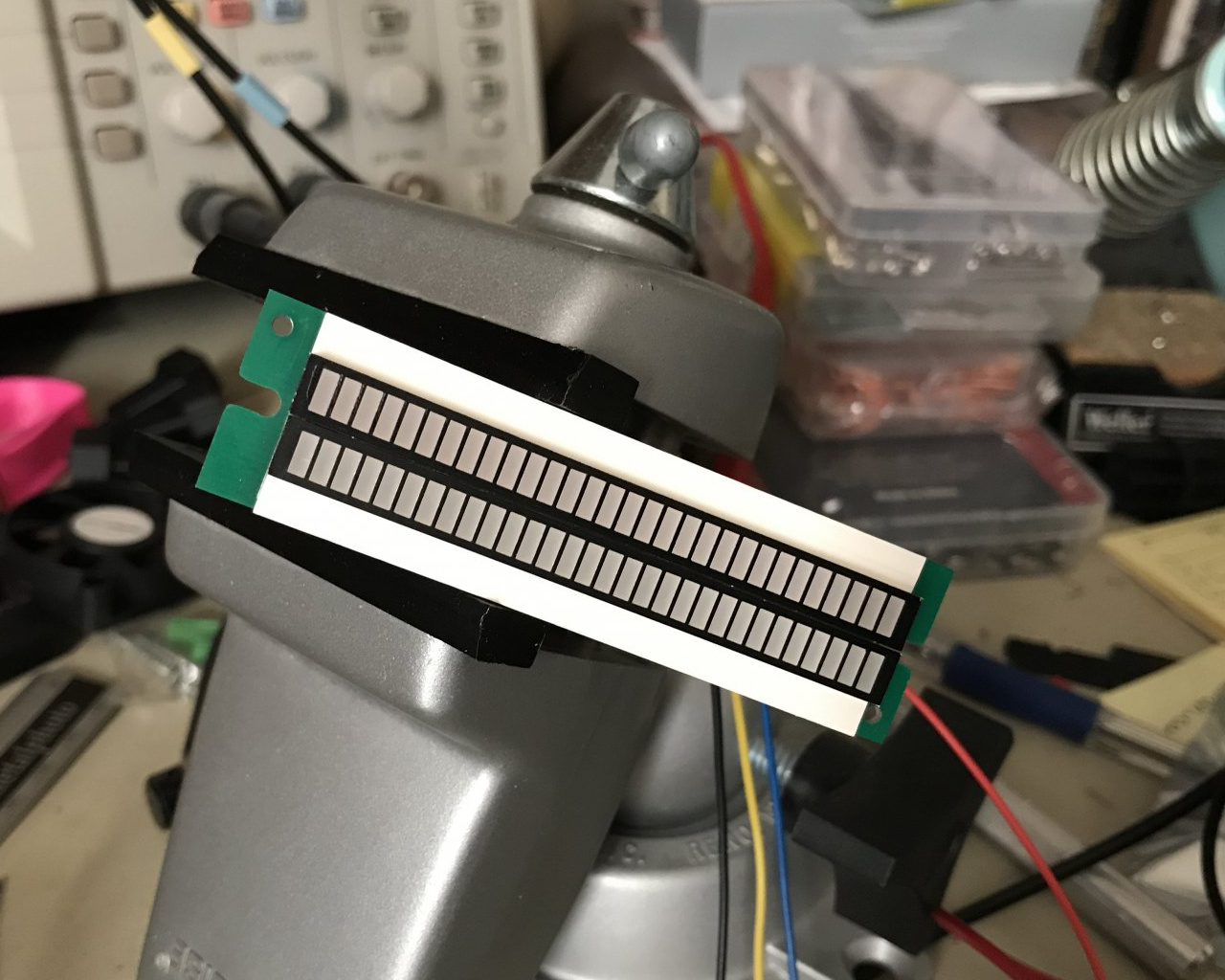

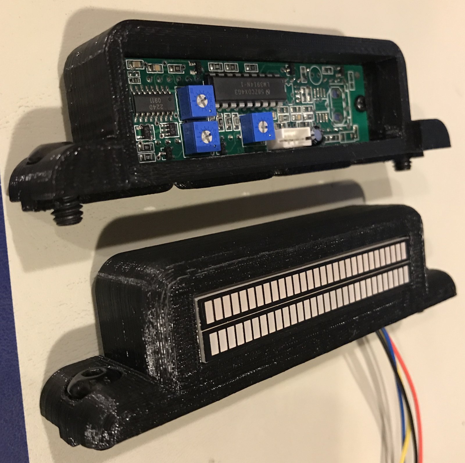

    The Barmeters arrived today and they are beautiful! Photos don't do them justice. They are brighter than I thought they would be but I'm going to be in VR except when specifically watching them to adjust the balance. The display surface is flat though it is two separate displays butted together for each dual bar graph so it wouldn't be hard at all to cover them with a cheap neutral density film filter if they are too bright for anyone.
    They are bright enough that my camera couldn't capture the beauty of the colors (washed out) but they are bright green, bright yellow, and bright red and all of about equal perceived intensity. Very impressed with these and can't wait to get them dancing! Circuit boards should ship tomorrow and be here next week. If all goes well and the circuit is good, these will be operational by next weekend.

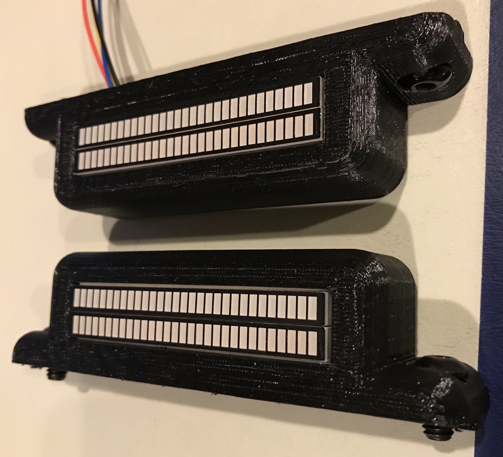

    And in their housings, ready to mount and wire up when I get my circuit boards built.

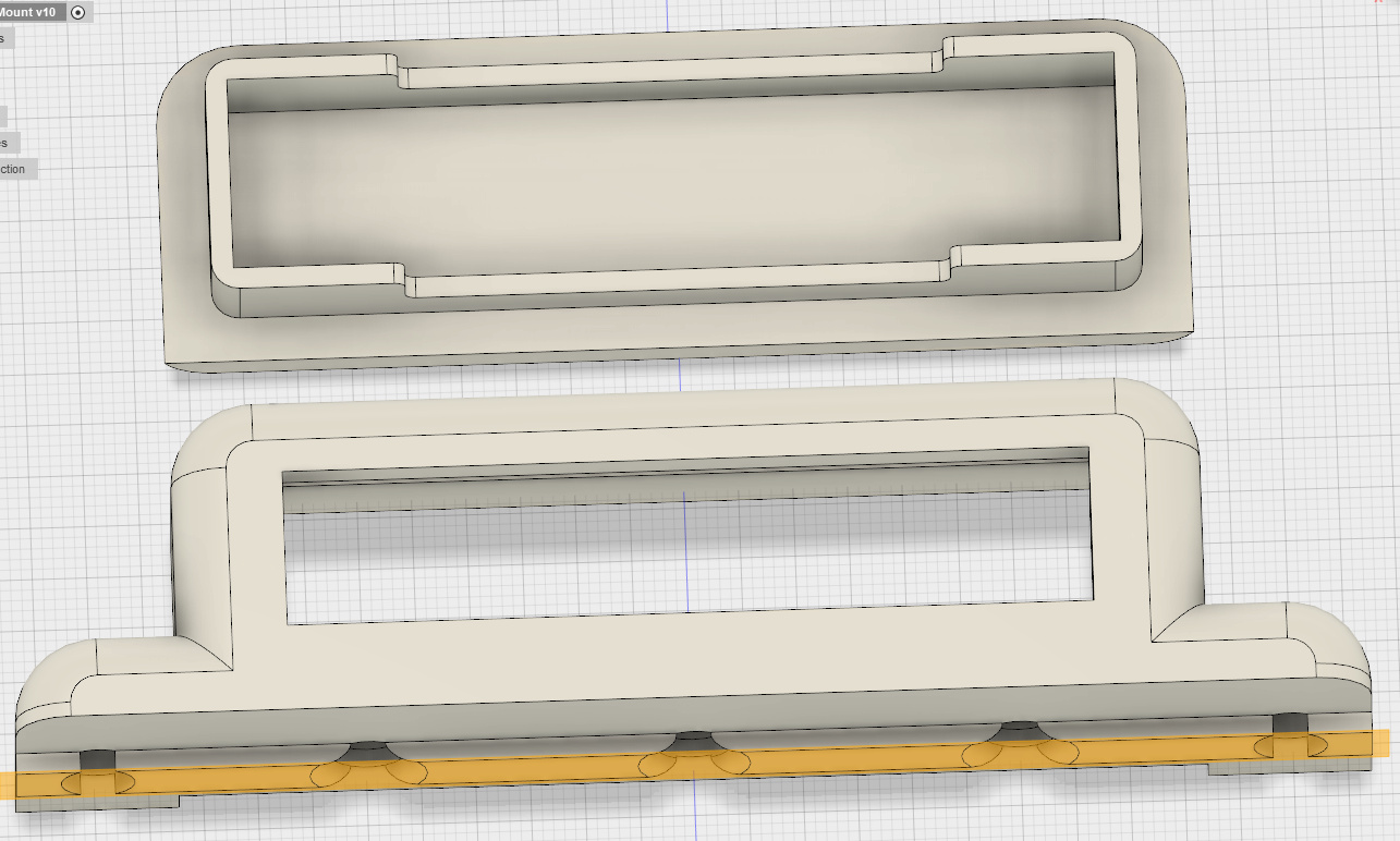

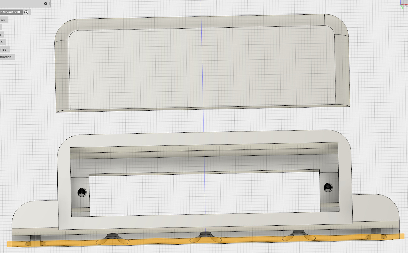

    Getting ahead of the cart, but here are the .stl files for the mount box and the back cover. This is set up to fit 80/20 10 series strut. Slice off that strip on the base that fits into the channel and you can mount it on anything. I'd wait to see if this works first, though. If it does work, I'll also post the board files and parts list for the circuit board.

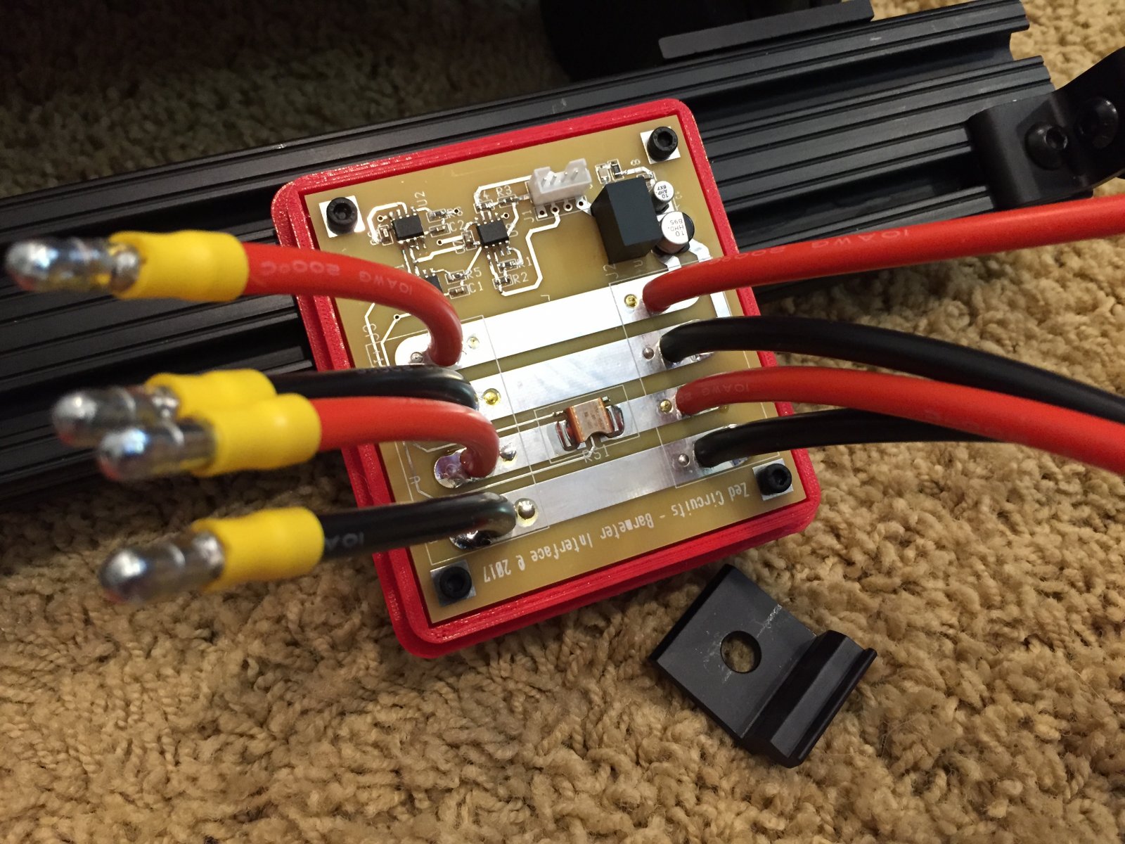

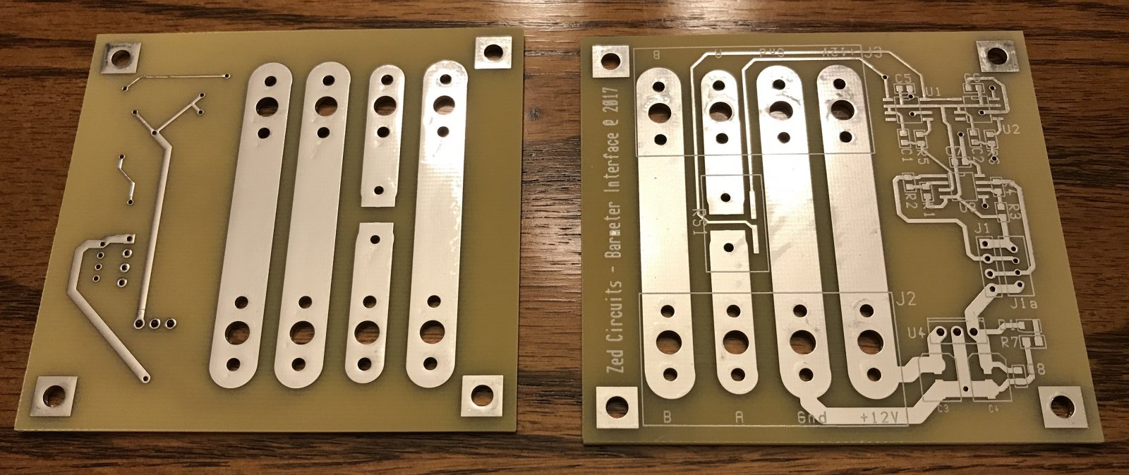

    Boards are here. Will build them tomorrow and see if the circuit actually works. Didn't get soldermask. Costs way more now than last time I had my own boards burned. Silkscreen was cheap, though, so did get that. $30 per board so a bit expensive. Would get cheaper fast in quantity though.
    Now I can finish the power wiring. :thumbs
  17. Zed
    Apr 4, 2017
    1,040
    USA
    5,842Coins
    +1,043 / 4 / -0
    The circuit works perfectly. It outputs a 0-5 volt output on the two channels depending on the polarity of a 0-50 amp current through the shunt. There is a 30 mV offset and I haven't tested the top end since my current source doesn't go that high, but it appears to work as planned. Only question now is if the displays are actually valuable for adjusting the platform balance. Printing mounts for the boards now. :thumbs

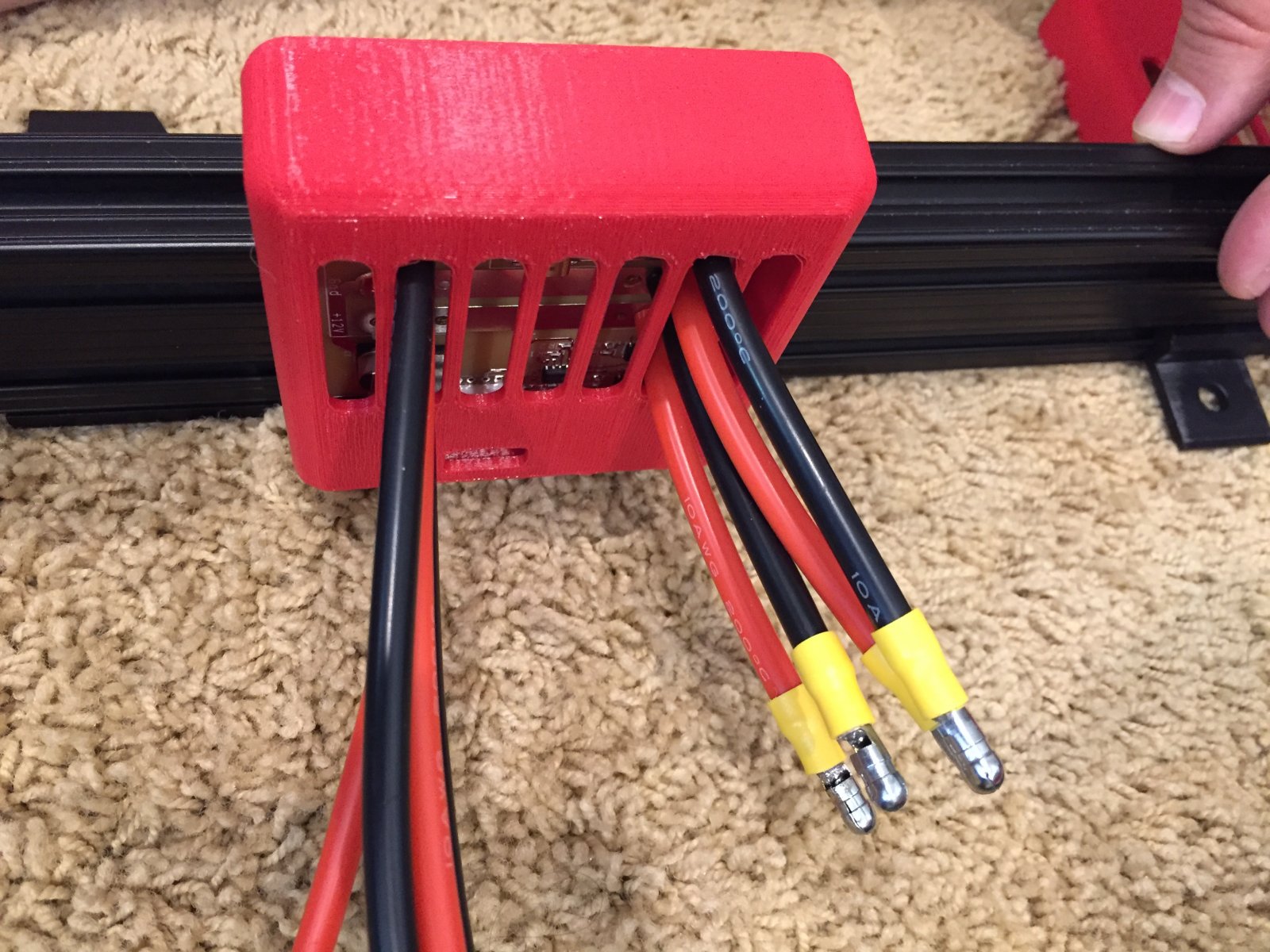

    Got the power and motor connections in as well as printed the housings for them. Almost ready to wire them on in. Beefed up the traces on the back to better handle the current. Boards are 2 oz copper to help with current.

    If anyone else wants to build these, here are the parts list and gerbers for the board. Some board houses want to know what software built these files - Ivex WinBoard. I've included two zips of the gerbers. One has the top and bottom copper, the drill (Excellon and gerber) files, the silkscreen, and the WinBoard source file itself. The other one has just the solder masks. I didn't send those when I got my boards burned since it added so much to the price, but it sure is pretty and makes the boards look like a pro. You probably want to repackage as necessary to fit with whatever the board house you use requires. I used PCBExpress.com and they have pretty good prices. Since the wide traces in the high current side need to carry lots of current, I went with 2 oz copper and then flooded the back side of the traces with solder to add more metal volume. Board size is 3 inches by 2.8 inches and I went with standard FR4.
    The 2 mm spacing connectors are small and the crimp connectors really small. I used good quality 4-conductor flat phone extension cord to route to the bar graph displays. The runs are at least 6 feet and I get what looks like full brightness so it can handle the display current well enough. I tested the displays by running both inputs to 5 volts (full bars) using the cable and not a problem. Both bars won't be fully lit in operation anyway.
