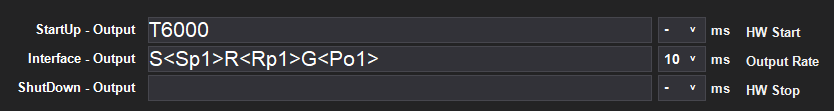

    Any idea what RPM output rules I have to change so all the leds lightup when I have full RPM? Only the first 5 leds are on, they other 3 are alway off even with full rmp,
    Hans

    Hi !
    Send a /Txxxx command where xxxx is the max RPM.
    Send it only once

    In the dash output settings
    Note, that I didnt validate the config shown here, it is just an example.

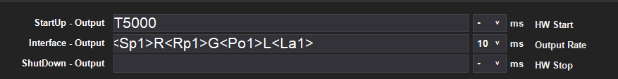

    I tried differnt values but still the same result, when the car is in N, 2 leds light up and with full RMP 5 leds light up.

    can you put screenshots of the dash output settings ?

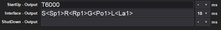

    This cant work as the board will receiver <La1><Sp1> making L unreadable, and no speed update as well
    as per the documentation:
    Serial/I2C syntax: [command letter][decimal number]
    // Yx : Start module with intensity set to x (1-7)
    // Sx : Speed update (decimal notation)
    // Gx : Gear update (decimal notation)
    // Rx : RPM update (decimal notation)
    // Tx : Max RPM
    // Ox : oil temp
    // Wx : water temp
    // Fx : fuel
    // Lx : lap
    // Px : position
    // Exxxx : lap time. 4 bytes representing float according to IEEE
    // Z0A : Stop and clear module
    The command will be processed when a new one starts. For example, RPM will be updated on the module once a new command such as S will start
    Serial data to start with max luminosity set (5), speed=95, RPM=4250, gear=2, lap=3, position=12 (last caracter is to finish processing of RPM, can be anything except a digit)
    Y5S95G2R4250T5000L3P12R
    If gear is negative, the reverse is assumed and 'r' is displayed
    If gear is 0, neutral is assumed and 'n' is displayed
