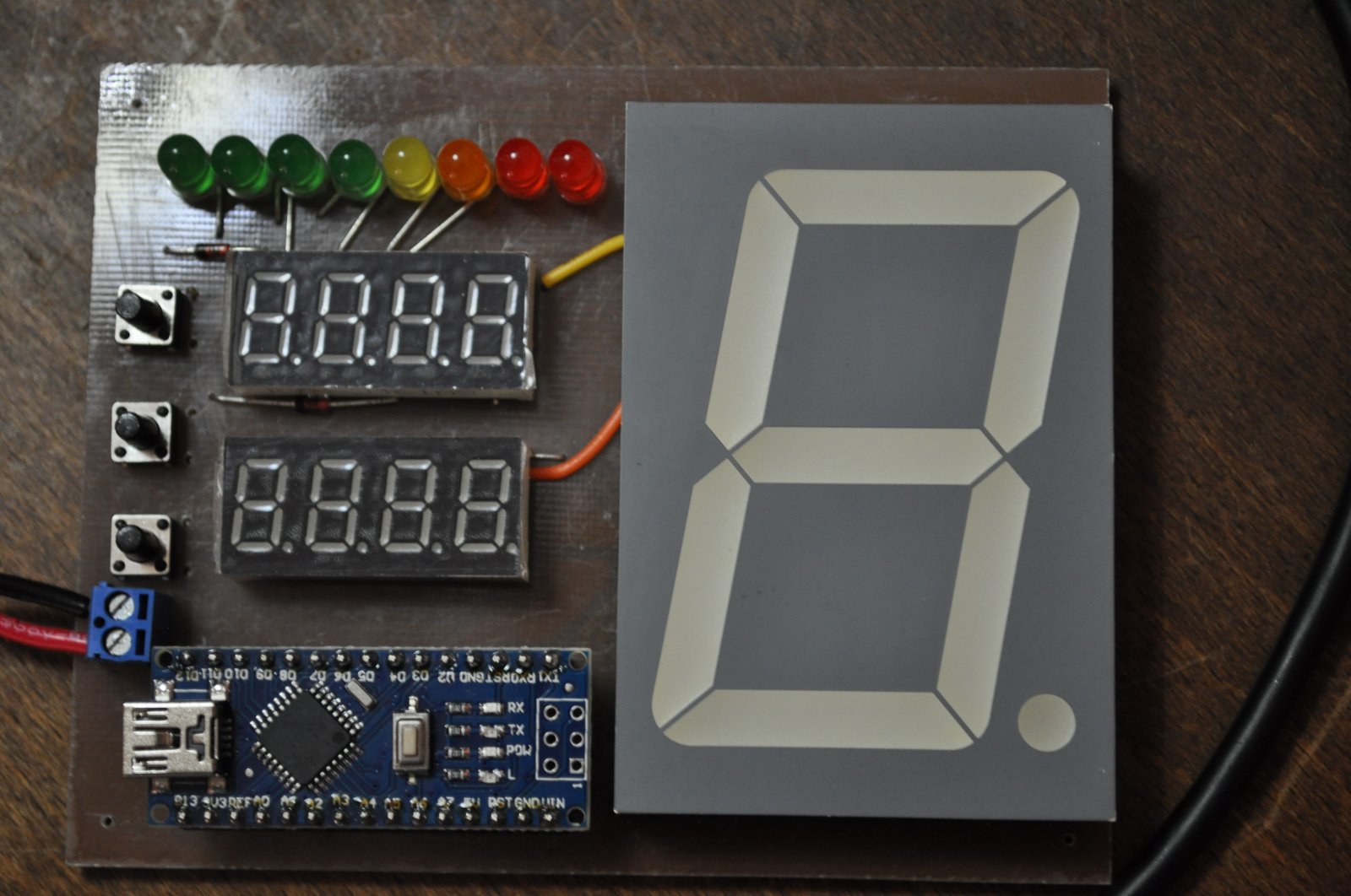

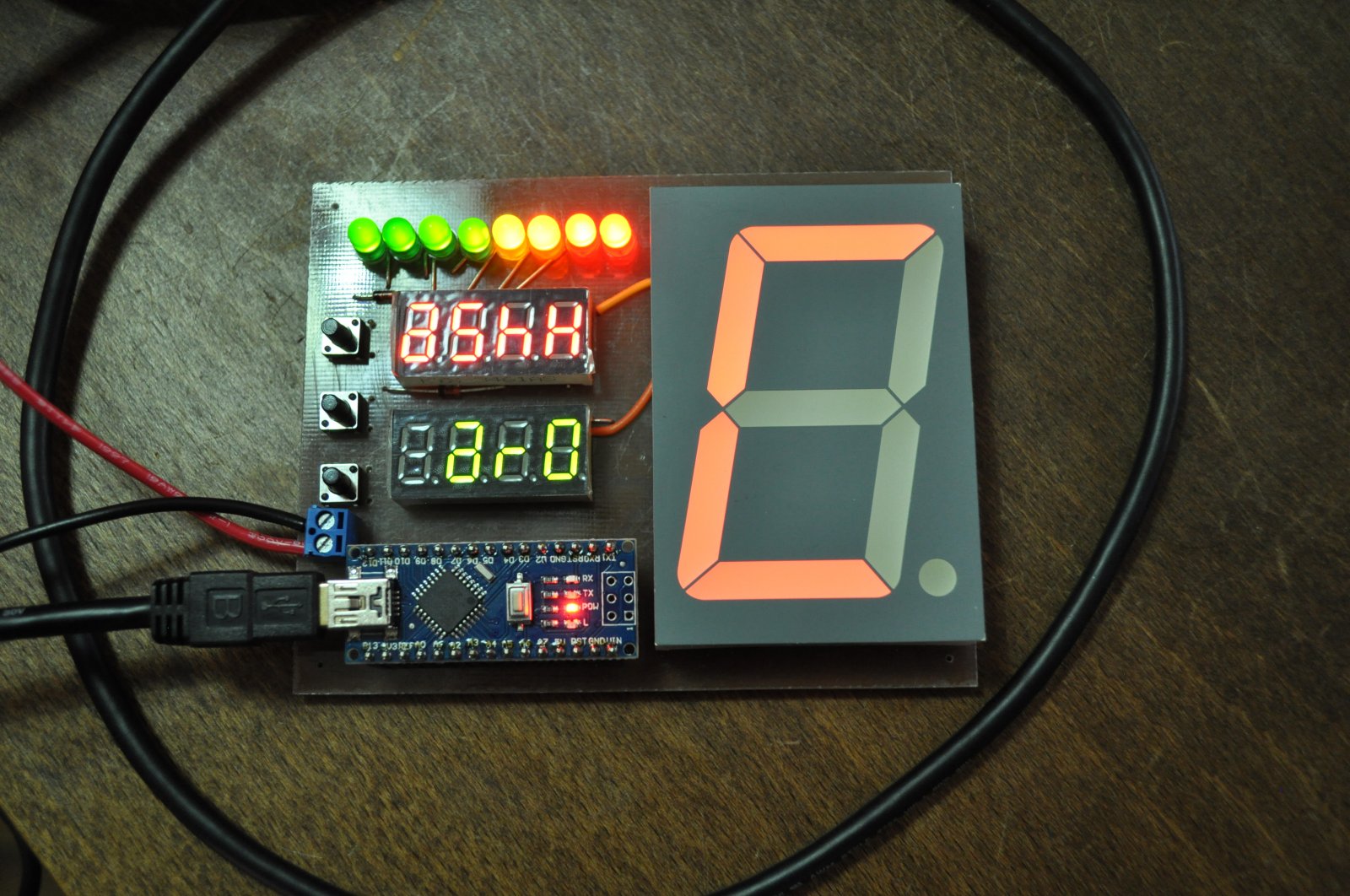

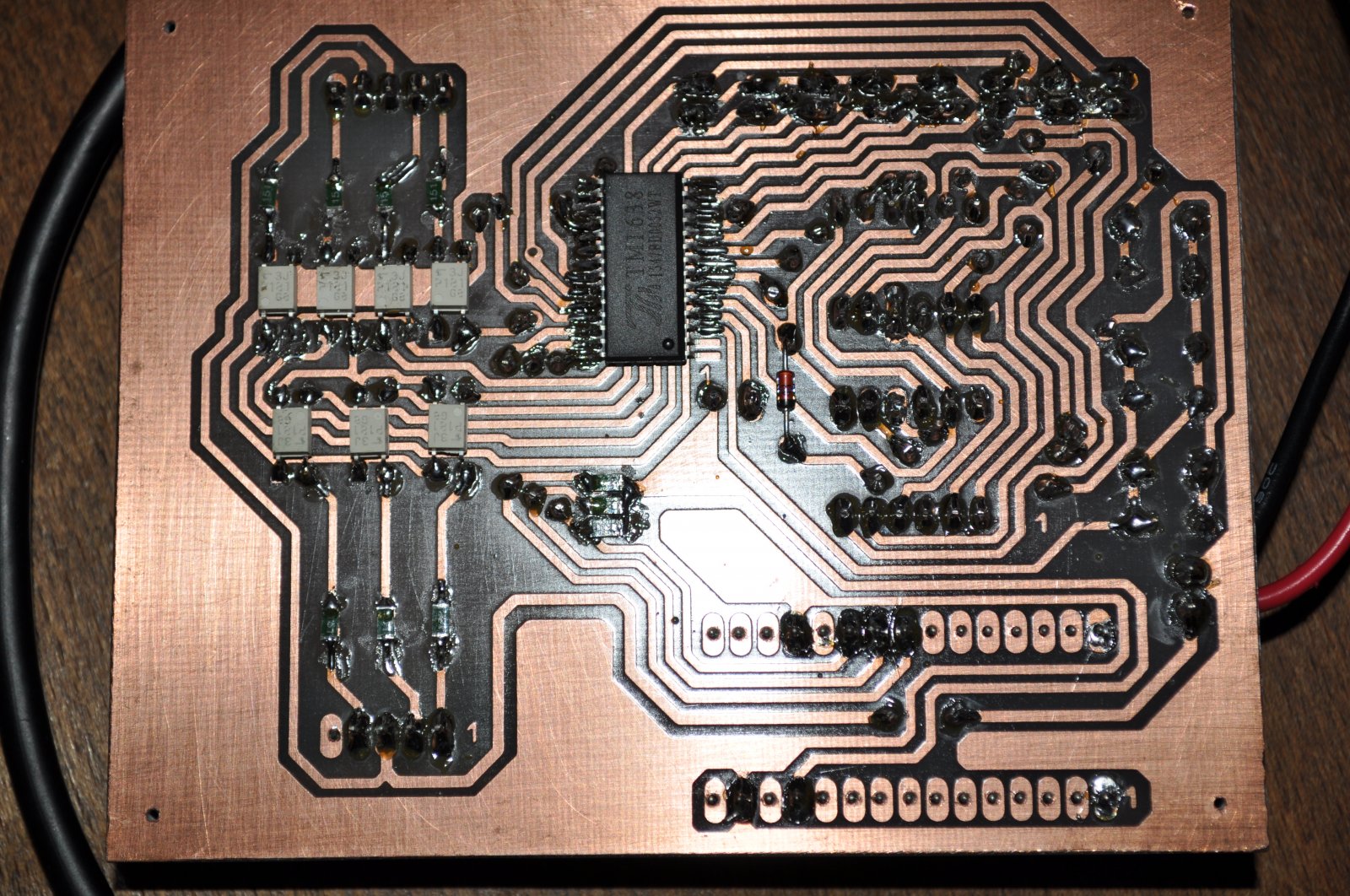

    Hello, here is a TM1638 module is by myself
    Dashboard with an Arduino Nano, a 7-segment display for Gear (characters height 57 mm, working 12v), 2 displays 4 digits 0.36 '' (rpm and speed) and ramp LEDs for Rpm.
    Display driver for GEAR directed by optocoupler (tlp 181, € 0.13 / ebay).
    The circuit integrated TM1638 costs 0.327 € / ebay.
    Display 7 digits 57mm red € 5.90 / Gotronic (France)
    equivalent products on ebay
    code used CarGashX
    Assetto Corsa: Gear works (but not in the right Endroid) but not the rest
    Dirt Rally: Rpm works but not the rest
    and PCARS: nothing (installed the plugin "ProjectCar Alt" and to patch the game are asked to select a directory with an empty file called Expired PCARSUDP.txt I not found)
    Can help me find the solution, I installed various plugins
    Thank you to all

    First thing to check is on GameDash. Do you have values displayed correctly in GameDash ?
    Your pictures are broken.
    Are you running on PS4 / PC ?
    The file pcarsudp.txt is a file you have to create manually as detailed in the instructions of the plugin.

    Nice PCB/routing.
    I guess your big 7 segment mimics one of the 8 others ?
    I see you have only 3 buttons. Which ones are you using among the 7 that I use (choose left/choose right/save) ? I'm afraid that your design may be different from stock TM1638 yo can find on ebay/ali/.... so I can't really help. As an example you used LEDs of different colors: The TM1638 module I use has dual color LEDS which are driven by the code/TM1638 so clearly the code will have unpredictable on the RPM leds behavior, and probably other

    Hello vthinsel and thank you
    PCARSUDP.txt: I do not understand what to do
    test with Arduino Nano and TM 1638 standard module (with bi-color LED)
    Dirt Rally:
    Dash1 - Speed / dash2 - Gear / Dash3 - Rpm
    power - on Gear display and LED digit pad for Rpm
    Assetto Corsa:
    Gear and Rpm display digits but not on LEDs for Rpm

    For the led rpm have you tried the reset button ?
    The problem probably comes from dual color led which are assumed by the code. Try to change the number of red leds using the buttons.
