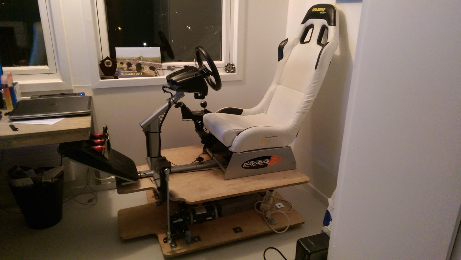

Another Playseat 2DoF -> 3DoF
Discussion in 'DIY Motion Simulator Projects' started by flyingdingy, Nov 2, 2015.

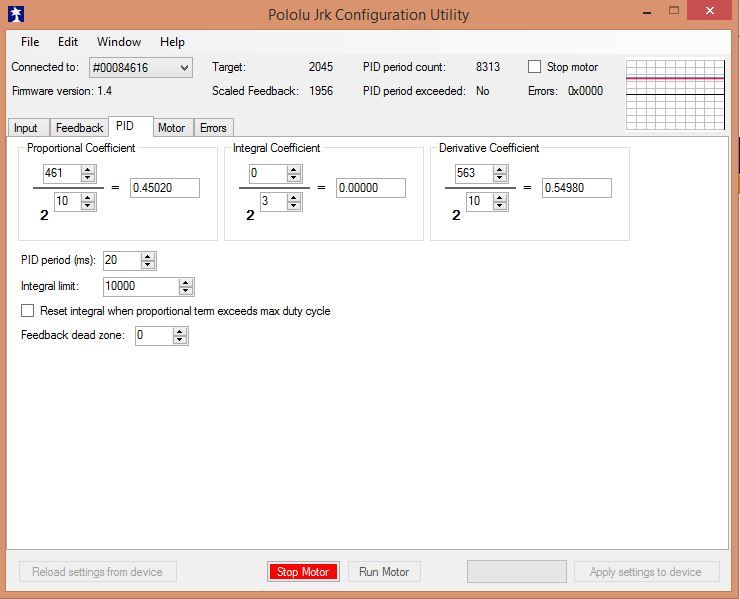

    And I looked at the PID, theres nothing in D
    as @noorbeast suggested, run 0.39 p , 0 I, 0.5 D

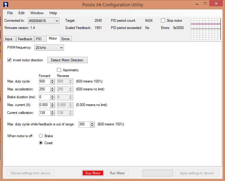

    Please post screen shots of the utility tabs on both motors and we can advise.

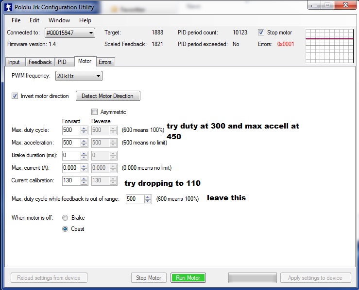

    @flyingdingy , apart from PID settings ( I am not sure what you have now), try these settings on the MOTOR
    also , can @Avenga76 please advise of settings help?

    Here are my latest settings.
    For tuning fast motors I would start off with really low settings. Like try Max Duty cycle and acceleration at 150-250 then try that. If that works then try going up to 350, then repeat until you find the sweet spot.
    If find that the PID is also very important, again, start off low and then slowly increase them.
    These faster motors are really pushing the limit of the JRK's so it is just a matter of experimenting and finding out how close you can go to the limits.
    I would say the first step is turn all your settings down so you can prove that you motors can work at a slow speed then work on increasing the settings until you get a nice balance.
    If you check out my build thread I have tons of videos which show exactly what is happening when you get these errors. I did a lot of testing with controlling the motors by hand and demonstrating the motor errors with quick reversals.

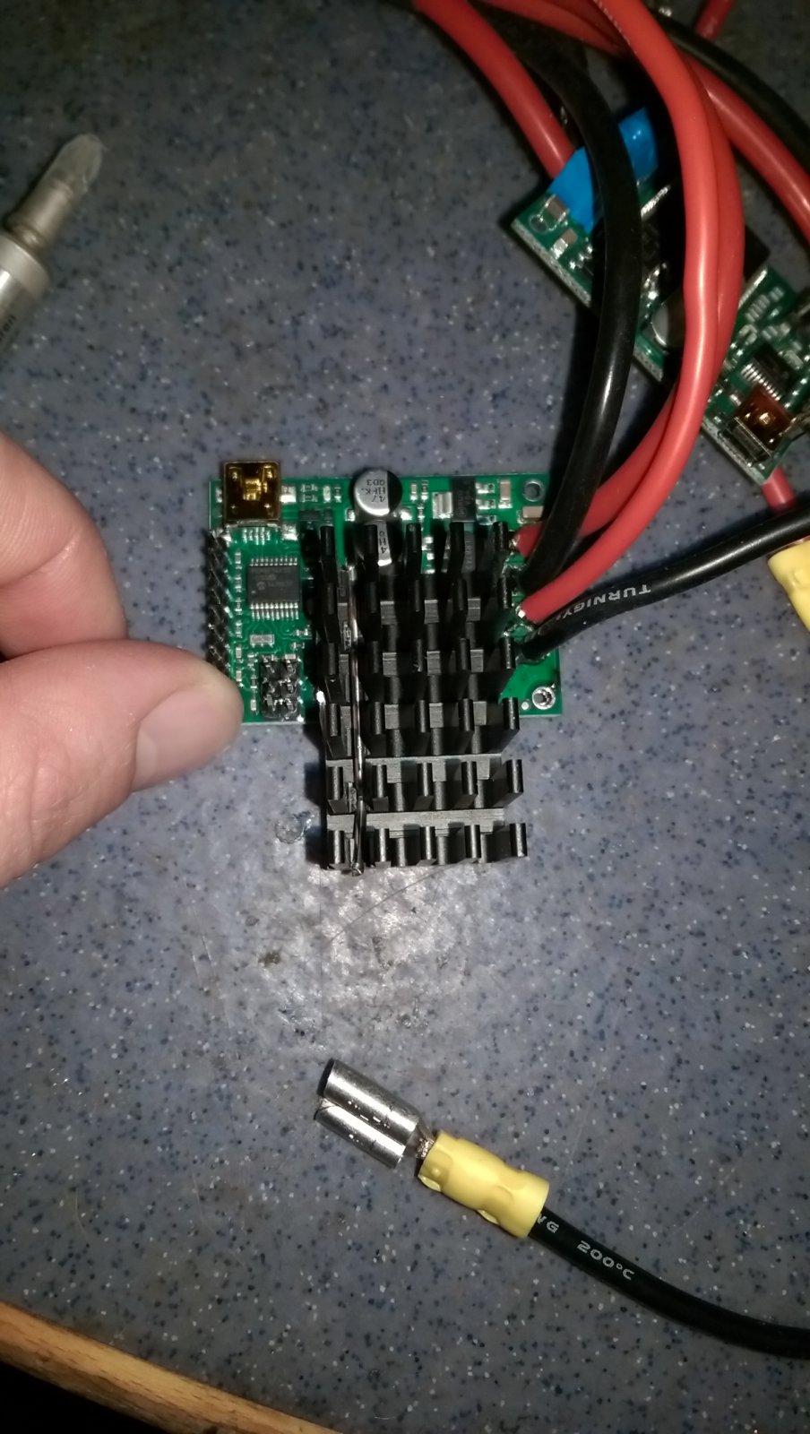

    Last night I pulled the JRK's off my SIM and replaced the heatsinks with alot larger ones (the heatsink I had on them got hot just from moving the engines with no load) and I have soldered one of the JRK's with the cables directly onto the board. This way I can test if it actually makes a difference ;) (since the other JRK still has the blue connectors)
    If the newly modded JRK performs better I will re-solder the other one as well. (I have soldered on high current connectors on the cables instead, supporting 90 amps (XT90 from hobbyking) and are using 14AWG cables) but to be honest I doubt it.
    But either way I had to pull them off to replace the heatsinks so wanted to try to see if it makes a difference.

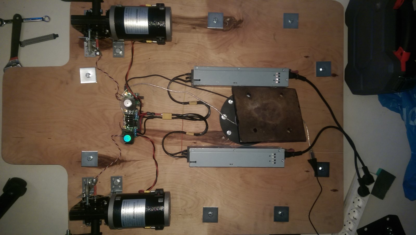

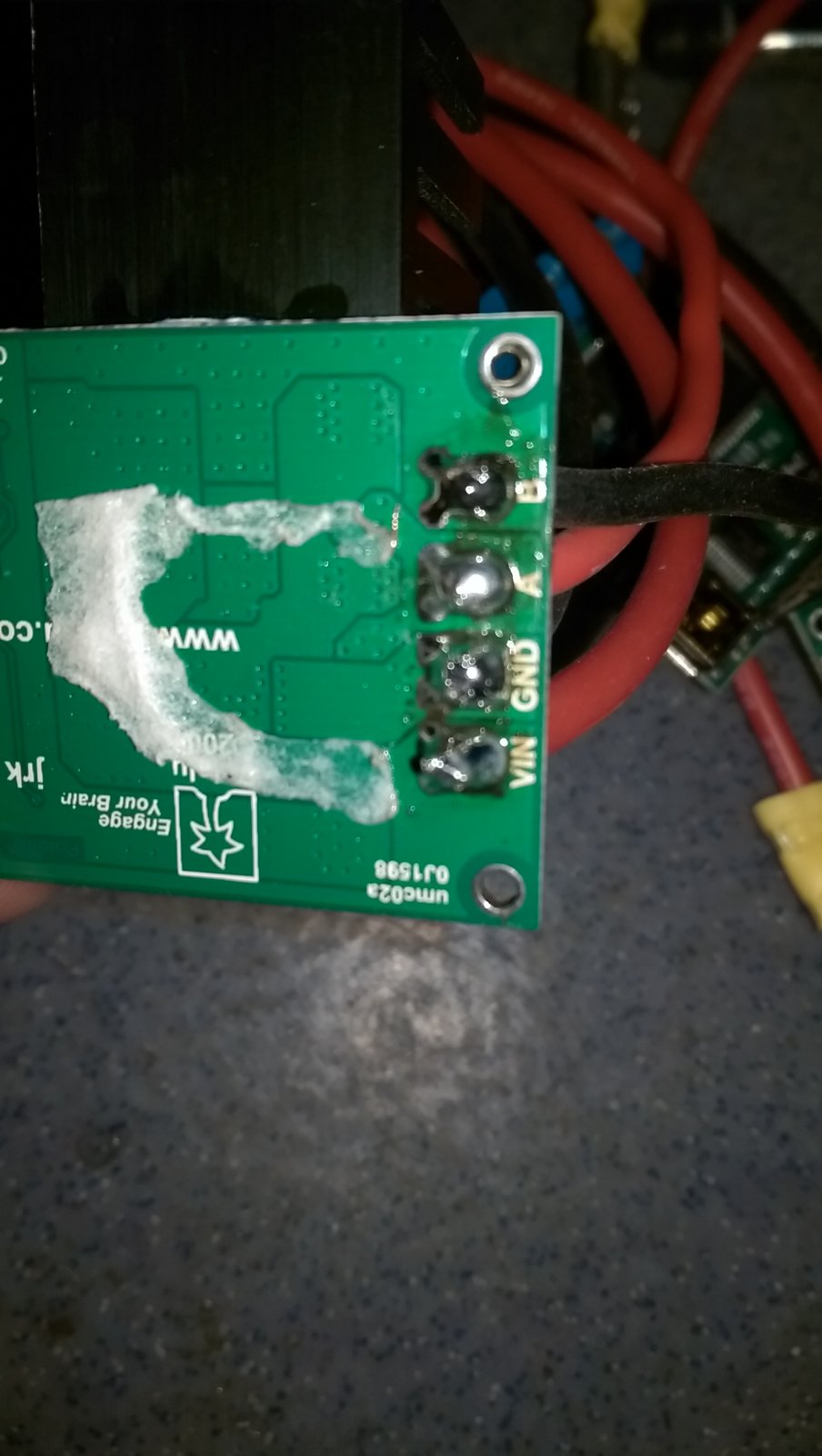

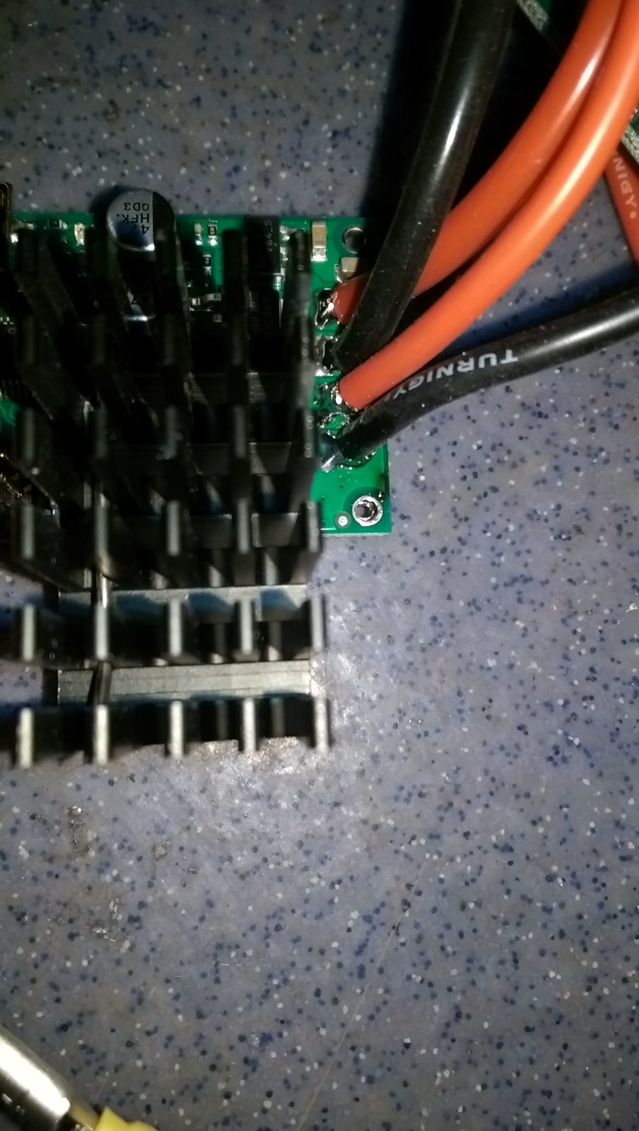

    As expected, soldering the wires directly to the JRK did not make alot of difference.
    It does however give about 20-30% less motor drive errors with the exact same settings that is on the other JRK that is using the terminal connectors. (40 motor errors from one lap at Assetto Corsa while the other JRK has about 60-80 errors on one lap at the same track and car, but I guess that margin of error can be related to something else, not exactly the same driving, but it seems rather consequent.)
    So for people using JRK's I actually would recommend soldering directly to the JRK, even though the difference is more or less negligible.

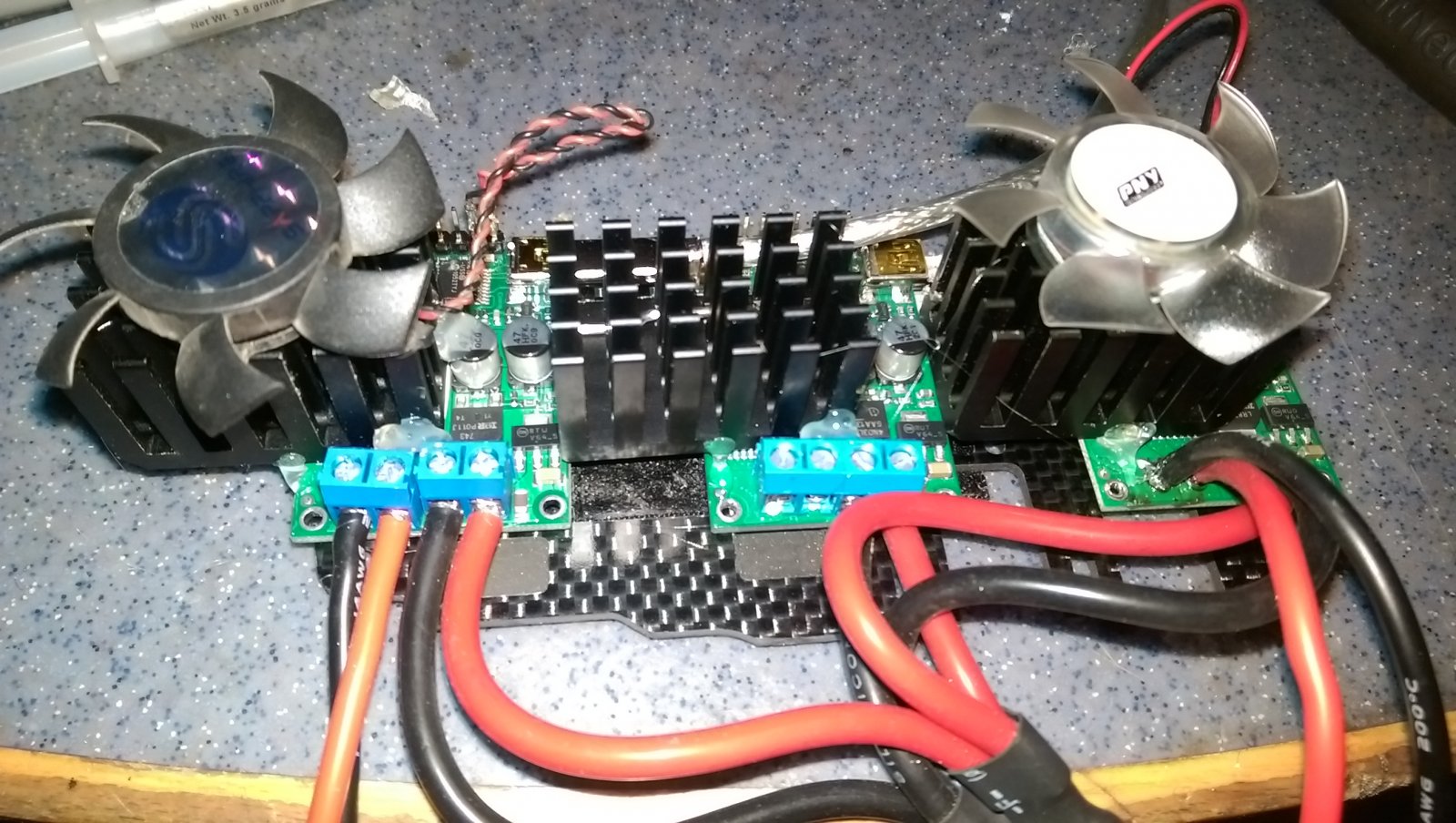

    The old cooling:
    Soldered directly to the JRK (first picture is WIP)

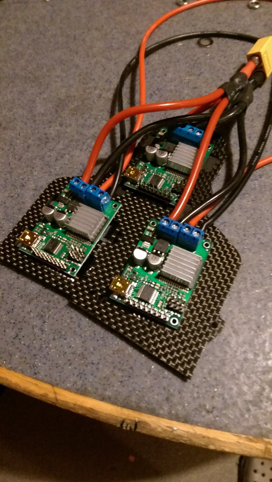

    "New" setup - the one in the middle is a "spare" that is planned to use on the traction loss

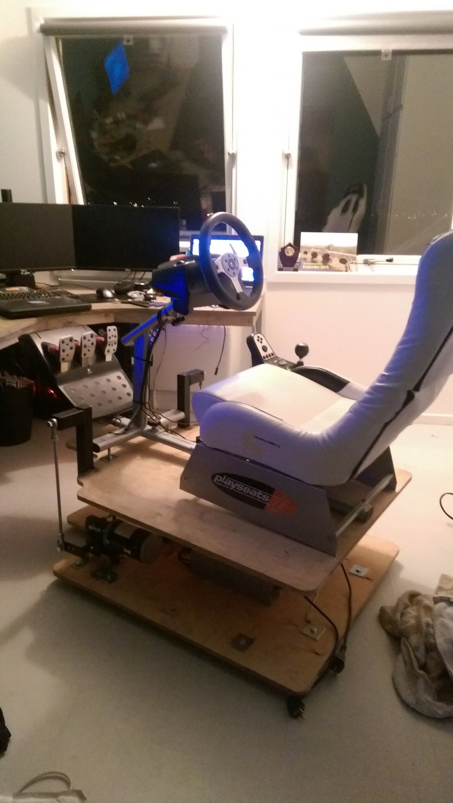

    I fiddled with the motor settings and PID's and got to the point where I felt it could be working and completed the mounting of the PlaySeat to give it a try :)
    I do not have a video now, the clip my GF shot with my cellphone was so dark that it is no point in publishing it ;)
    But it is fun, it rocks me pretty good. I need to fine tune everything.

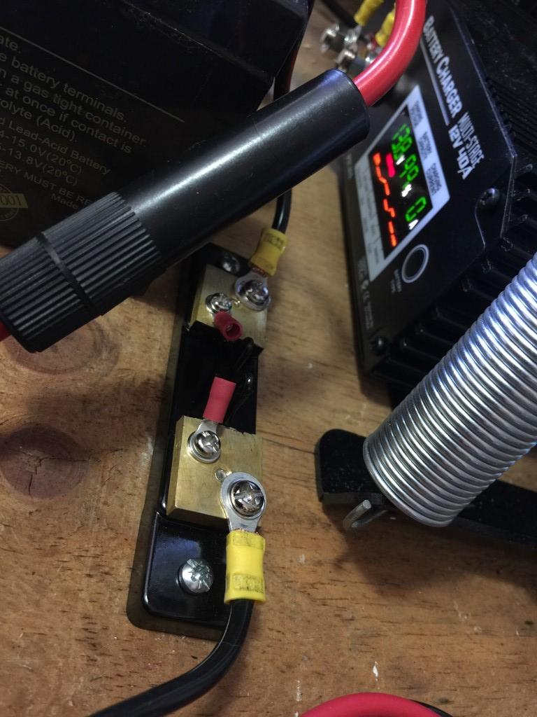

    In terms of power supply, I opted to run three 12v 9Ah UPS batteries which take all the load then a 13.8V 40A power supply to keep the batteries topped up. That works really well because the average load on the motors isn't that high so the power supply is plenty big enough to keep the batteries charged and the batteries can easily take the big spikes.

    My old motors were on average about 20-25A for both motors combined from memory, but the peaks were up around 70A.
    Running the batteries allows me to run a much smaller power supply because I don't need to worry about those large peak values. Plus I have the added benefit of being able the run on batteries alone, I haven't tested how long I can run off batteries but I often use just batteries if I am testing or doing a short session.
    I think my current power setup should be powerful enough to had another motor for my traction loss and still not be over my 40A power supply.
    I haven't tested it with my new motors yet, I installed a shunt inline after my batteries so can use that to test the overall amps

    Gauges and shunts come from Ebay for about 7-9$ depending on the Amperage rating of the shunt.
