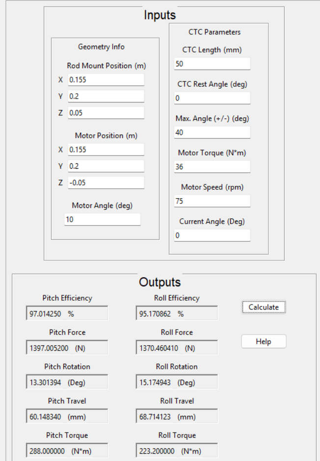

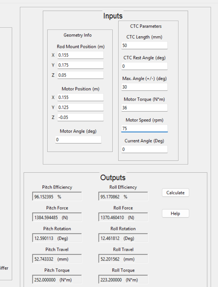

    After weeks of reading various threads, I’ve finally decided this project is worth pursuing and have already ordered most of the parts. Many threads lack detailed guidance for beginners like me who have no experience with hardware, electronics, or programming. My goal is to provide more in-depth details than those other threads—especially since I spent considerable time researching even small items like which bolts to use.
    I’ve decided on the following components:
    • 4040 aluminum extrusions
    • 1× Arduino Uno R3 clone
    • 2× IBTS 7960 clones
    • 2× 90° Hall sensors
    • 2× 24V 250W 75RPM wheelchair motors
    • 1× inexpensive power supply (0–24V, 50A, 1200W)
    I read in one thread that a 90° Hall sensor provides four times the resolution of the more common 360° sensor, so I opted for it since I won’t be using more than +/-40° anyway.
    If I understand correctly, a 1:1 pulley ratio is required. This means one pulley would be 40 teeth with a 17 mm bore and the other also 40 teeth but with a 6 mm bore. I guess a 120mm belt?
    I’m wondering if 3D-printed pulleys would work well, or if I need metal ones?
    Also, why is it considered better to use 90° or 180° Hall sensors instead of 360° ones? If I understand correctly, you could utilise the full resolution of a 360° sensor with a 3.5:1 pulley ratio, since it’s the ratio between the pulleys that ultimately matters, not just the sensor resolution.
    Finally, I’ve decided on a 50 mm lever to maximise torque. This design is the most compact I’ve seen so far, and I’m hopeful that the motors will deliver enough power. I’m also considering what type of aluminum to use for the levers—likely something stronger than 1050 to be safe.
    My simcalc data.

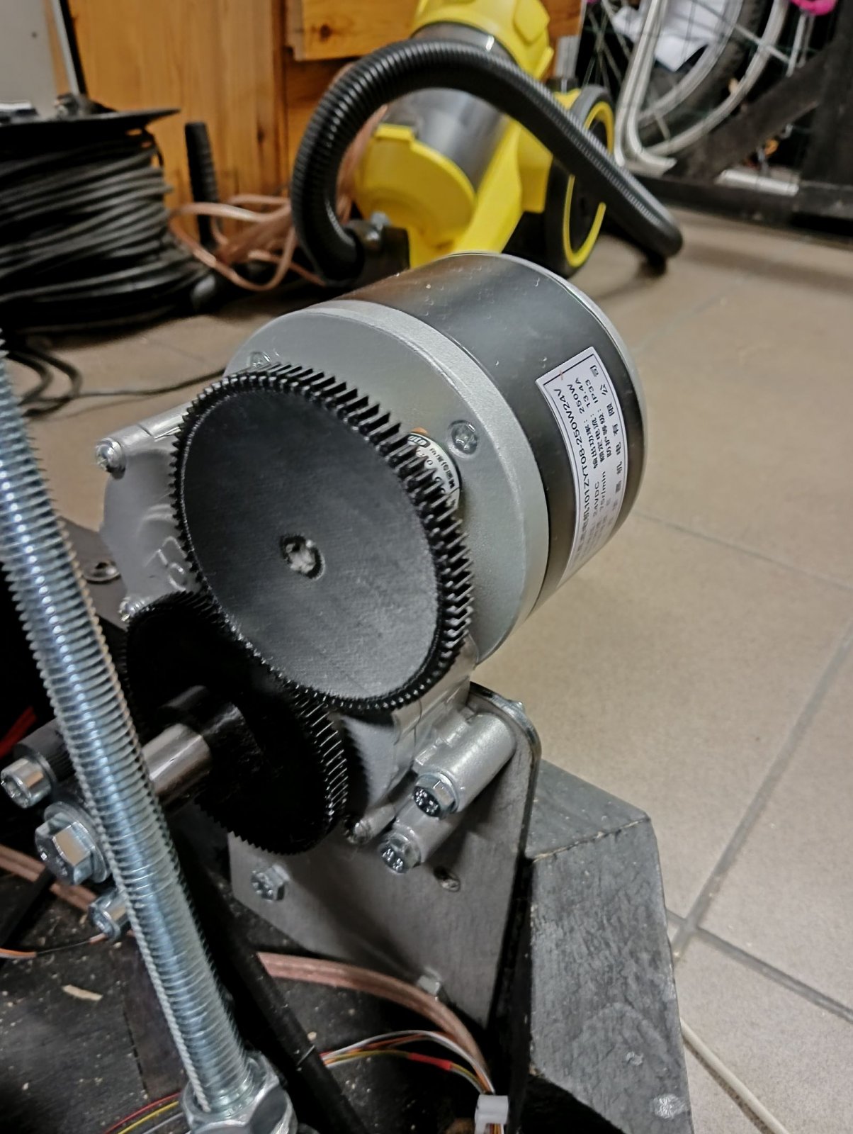

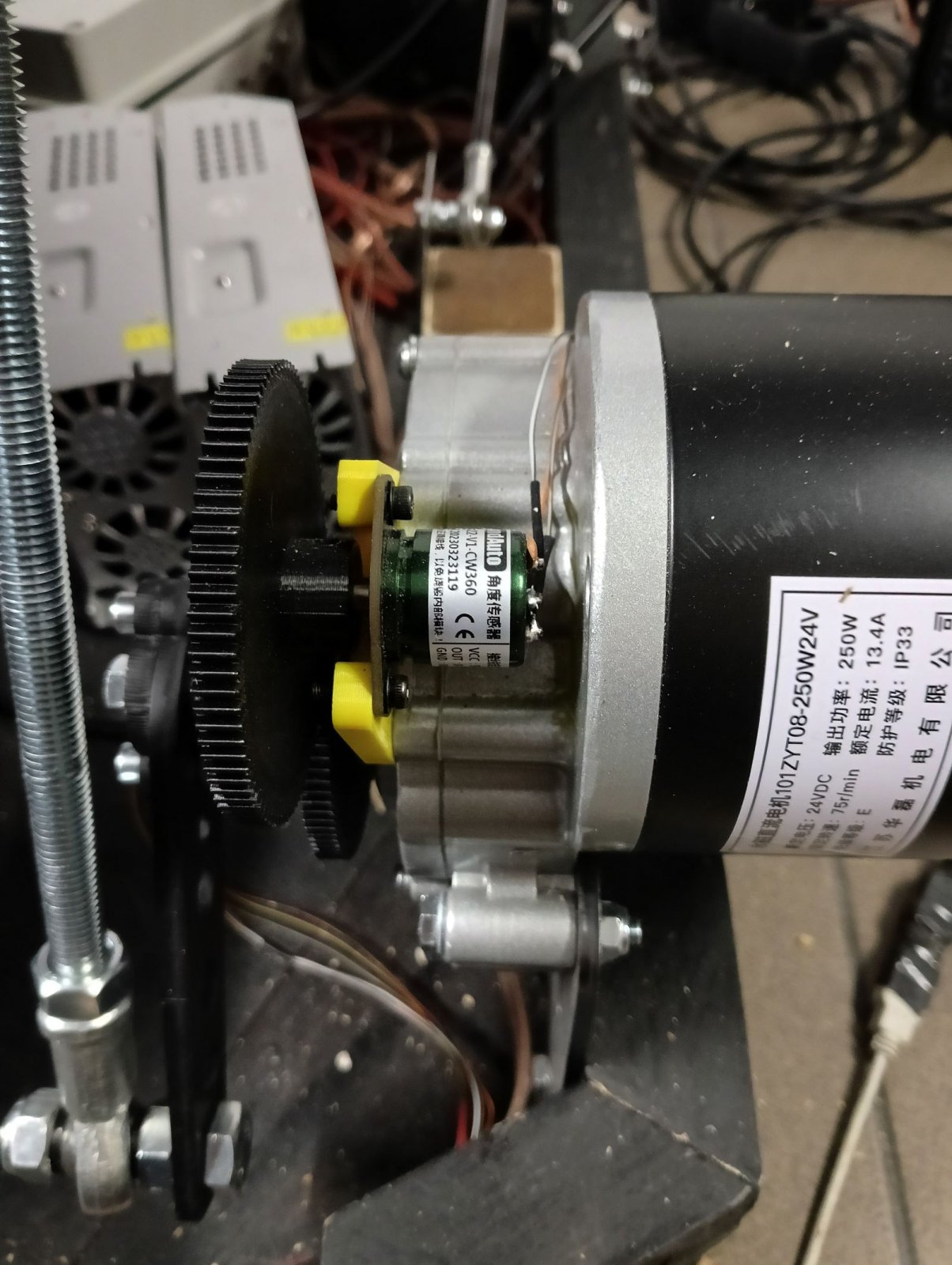

    The idea of Hall 90st sensors is wrong , you will easily exceed the values read from the movement of the motor and shut down the motor, buy a standard Hall 360st sensor its resolution is sufficient, do not buy an IBT-2 bridge at 24V they are easily damaged, buy a controller https://www.xsimulator.net/community/threads/reasonably-priced-100a-motor-controllers.17638/page-5 tested works without a problem, zebatki you can print , I have a design of zebatki without a belt, it works properly for a few months, unfortunately my computer died temporarily, I will try to post stl files as soon as possible
  3. Mill2077
    Mill2077 New Member
    Mar 25, 2025
    16
    76Coins
    I bought almost everything already.

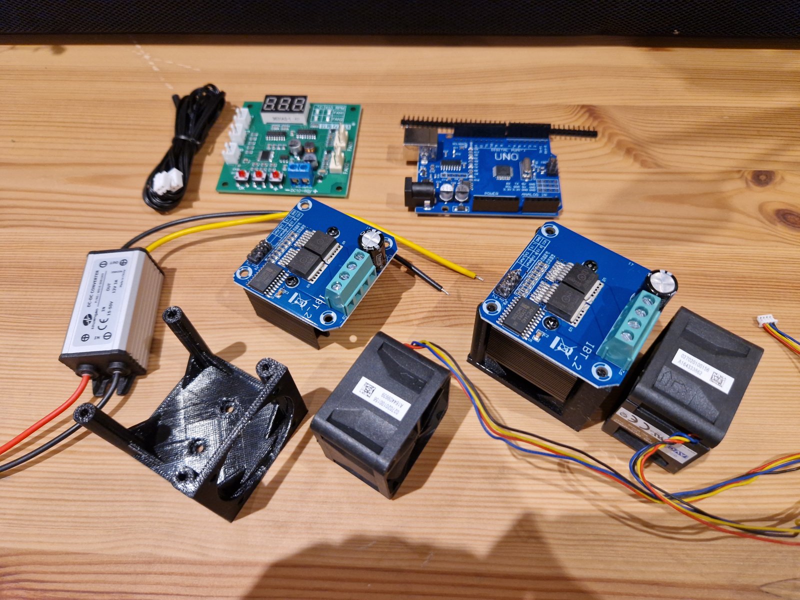

    I have 4 cloned ibt2s and 2 cloned arduinos. I saw a lot of people had problems with them but I will give it a try. Hopefully it will work
    But I will buy the 100A driver as well just in case. I need just one?
    Below is what I have in mind for IBT 2s. They will be cooled by strong 40x40 pwm fans 12w each. I've got a pwm fan controller which will cool them based on temperature. And a step down power converter. I'm planning to use the main power supply for them.
    Regarding the hall sensors I'm still considering what to do. Please share your stl files, maybe it will give me new ideas

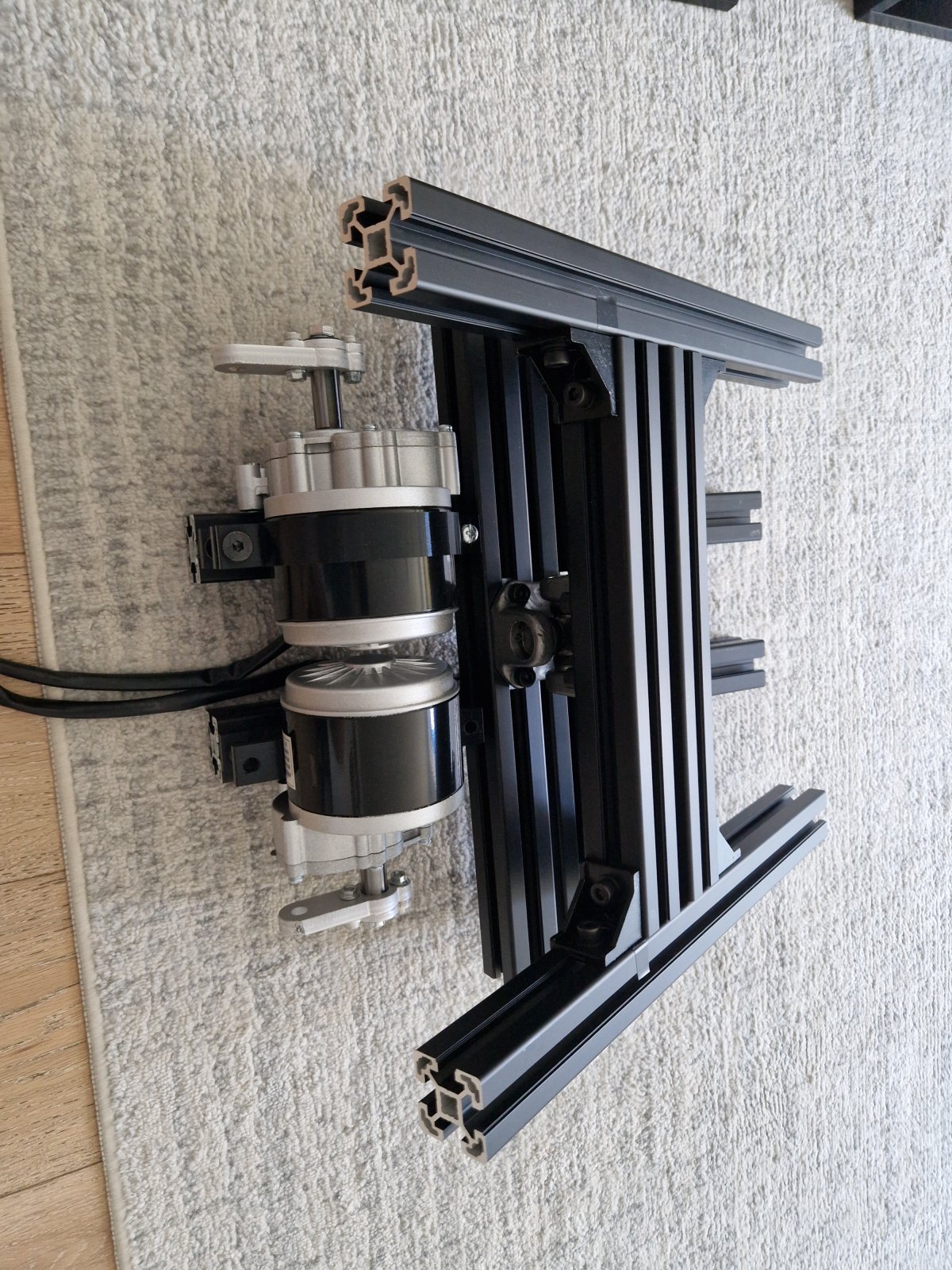

    Thanks a lot for sharing the stl files and photos! I like your gears approach a lot

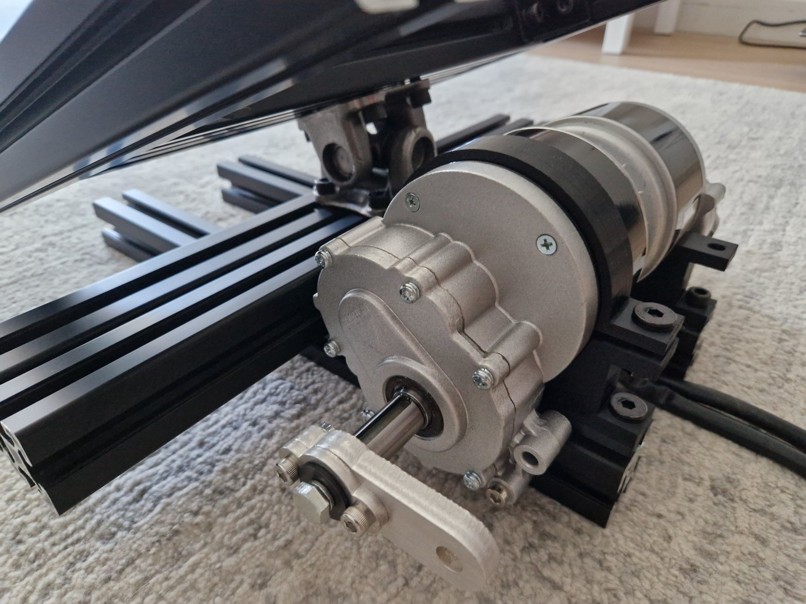

    I've received more components, so had the chance to create the frame and attach the motors.
    For the frame I used:
    m8 16mm bolts
    40 series corner brackets
    small 1mm washers
    propshaft flanges
    propshat universal joint
    To attach the motors I used:
    3d printed mounts
    m8 25mm bolts
    m6 35mm bolts
    For levers:
    m6 20mm bolts
    m8 30mm bolts
    Wasn't sure what aluminium to use for levers so opted for the strongest I could find which was aluminium 6082 in 10mm.
    I updated the simcalc data and I think I will not need more than 30 degrees up and down. I will keep the initial design of the 90 degree hall sensor with 1 to 1 pulleys for now.
    The next step will be wiring all the electronics with an emergency stop if things go wrong.

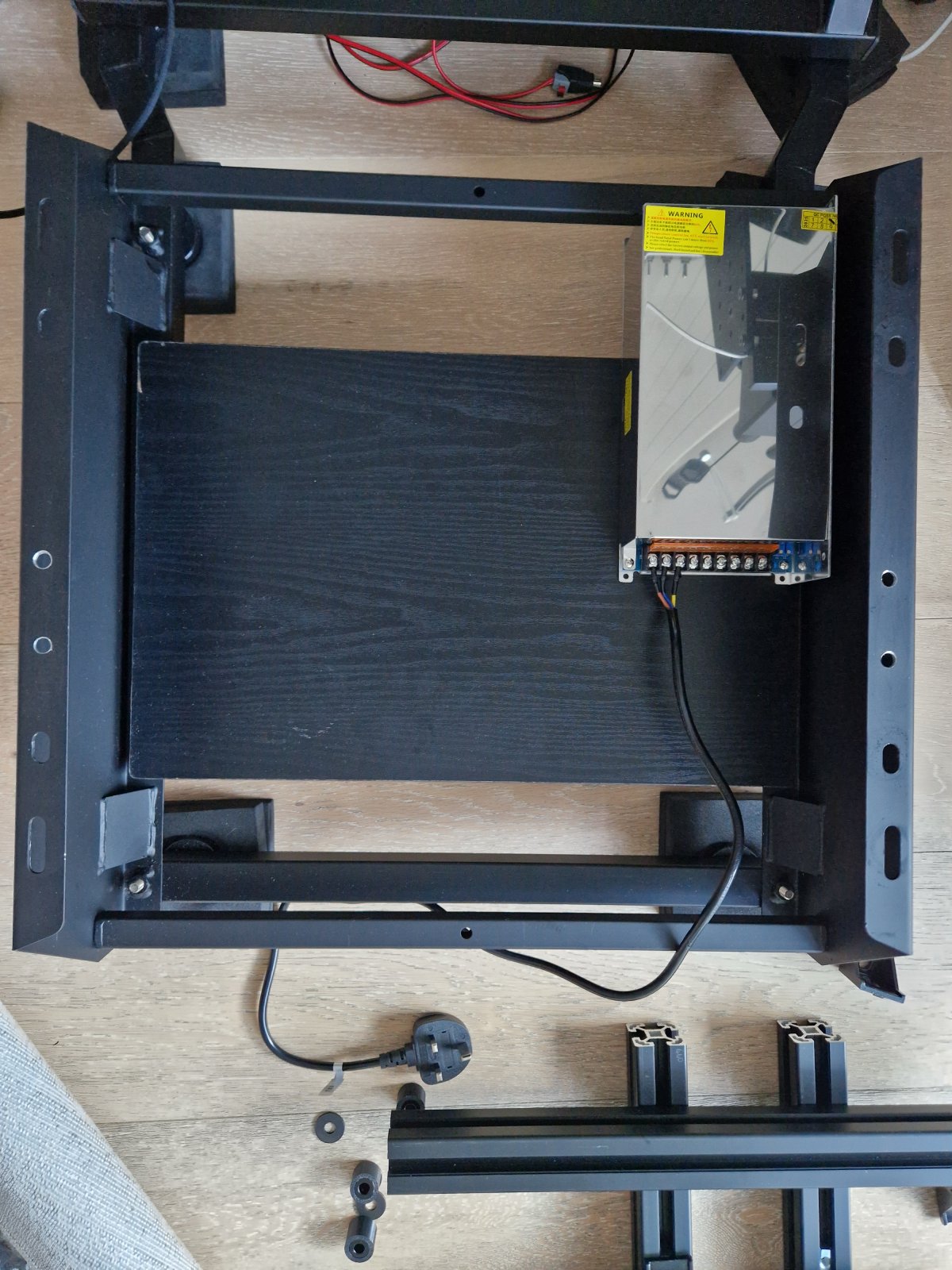

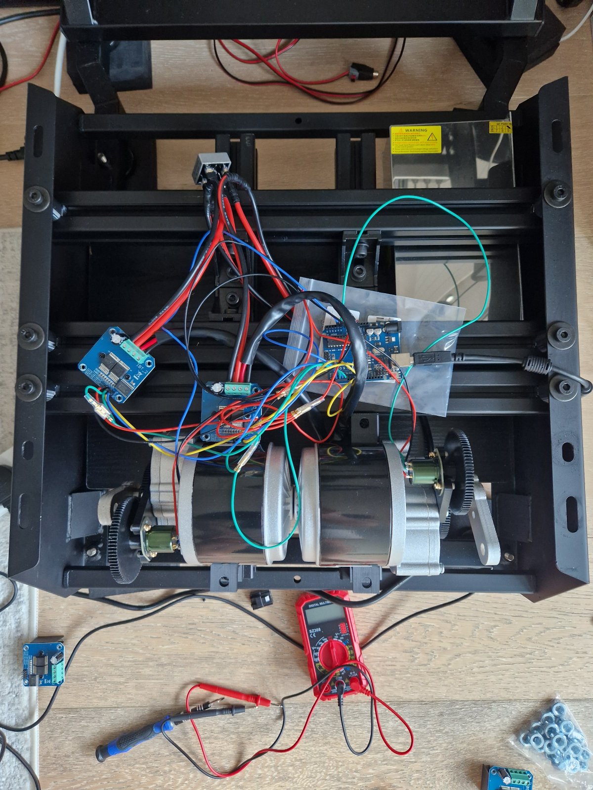

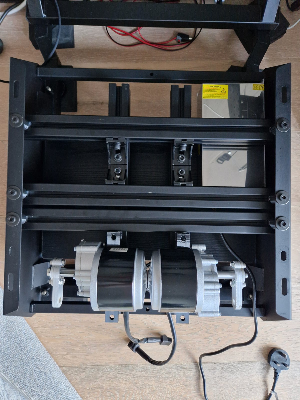

    I've attached the lower 2dof frame to the Gt Omega Apex rear seat frame.
    Then, I've done all the wiring with a kbpc5010 bridge rectifier and two 15A fuses.
    Lastly, I've done some testing with SMC3 tool and it was a total disaster.
    I'm certain one of the 90° hall sensors is broken. It moves from 0 to 5v in around 5-10° movement. The other one works fine.
    On my first try with smc3, there was a slight movement from one motor. Anything I tried I couldn't make the motors work.
    I then connected the other two ibt2's I had and got a 1 sec movement from the same motor as well. After that nothing is working.
    I centered the working hall sensor to 2.5v before the second test.
    I double checked that I uploaded the right sketch and run it in mode 2.
    I'm confused if I burnt all four ibt2's. But how? I used 16v on the power supply
    Now, I'm not sure what to do next? I will try to use the other arduino I have but doubt it will make a difference.
    I guess I could try to get a second power supply. Maybe something is wrong with this one
    I'm waiting for the 100a driver which will arrive this week. Luckily, I already have spare 360° hall sensors just in case the 90° one won't work but I will not connect them yet.
  9. Mill2077
    Mill2077 New Member
    Mar 25, 2025
    16
    76Coins
    After reading many threads I figured out what the issue was. This forum is a great resource.
    I needed to switch the wires from motors to the ibt2's. The motion was inverted.
    Good news, everything works perfectly. Nothing is burnt and the 90° hall sensors are perfect for this job.

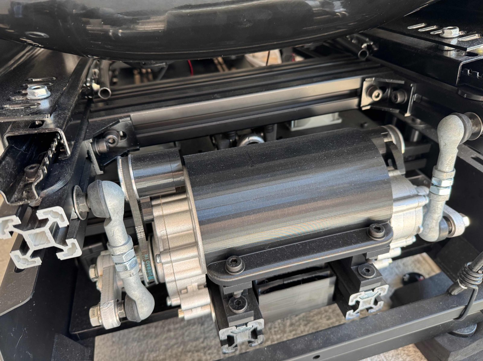

    howdy, where did you get the motor mounts that are bolted to the extrusions?
  15. Mill2077
    Mill2077 New Member
    Mar 25, 2025
    16
    76Coins
    The discord group of the popular thread here which has a video tutorial. Unfortunately, most of the things recommended in that thread can be done better including these mounts.
    I recommend you make them wider. The same width as the extrusion. 4cm instead of 2cm
    The motors were quite wobbly, so I had to make a cover. Now they are rock solid
    Another thing I remembered, don’t use the design of the levers that is provided in that thread
    There was some play after sanding the holes, I had to reinforce the levers

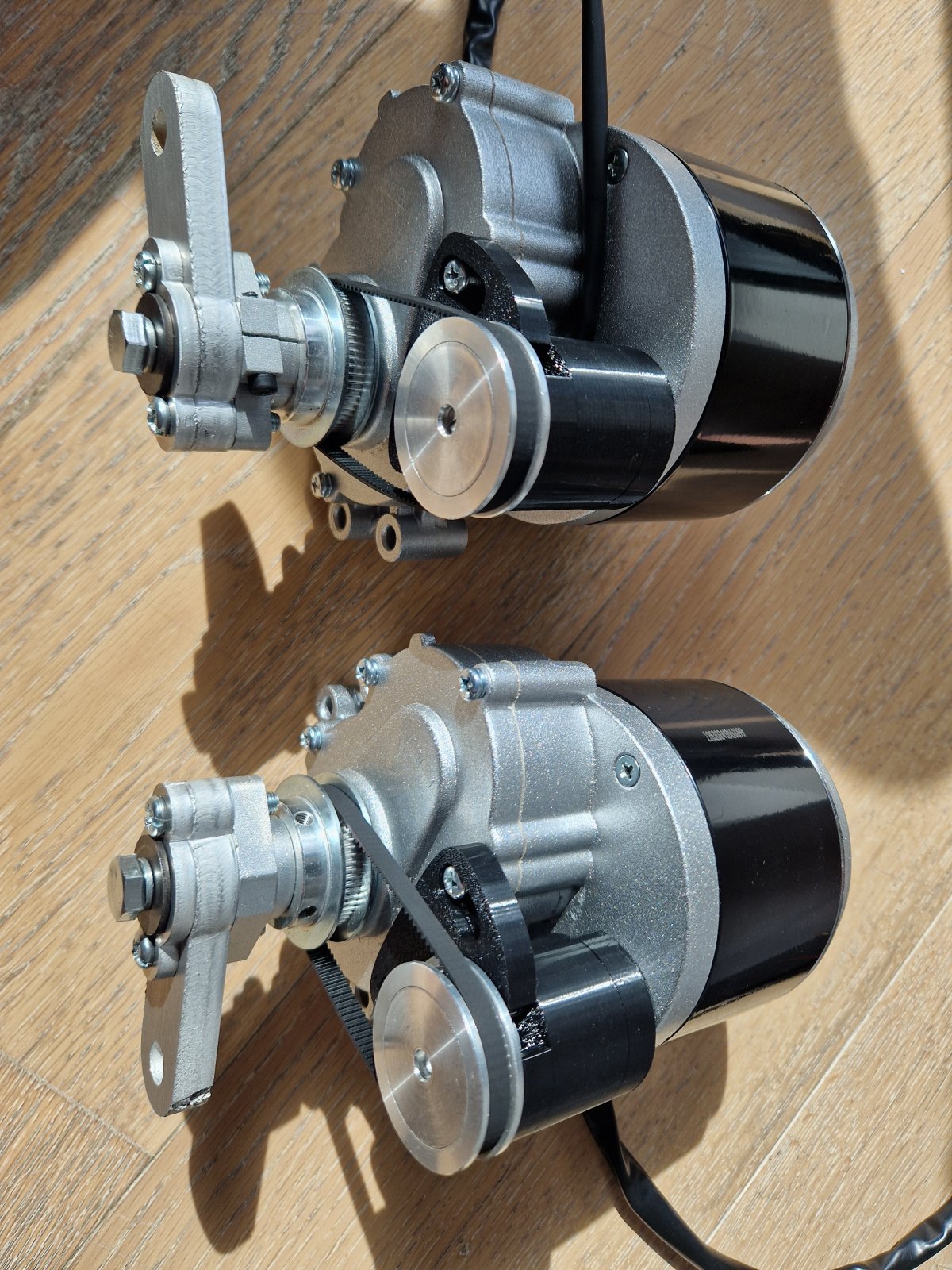

  16. Mill2077
    Mill2077 New Member
    Mar 25, 2025
    16
    76Coins
    Reinforced levers

    Some more questions:
    - I want to build my sim for a VR Flight Simulator. Have you tried using yours for flying? Is the movement enough?
    - I assume you 3D printed that cover and the motor mountings, any chance you could share the STLs, or link where you found them?
    - I see a bungee cord in the picture. Was this for any backlash, and did it help?
    - Any links available for the Hall sensors and metal gears for the pulleys?
  18. Mill2077
    Mill2077 New Member
    Mar 25, 2025
    16
    76Coins
    The movement would depend on your platform design. My design is very compact. The motors are as close as physically possible to the pivot point so the range of movement is very high. I use probably 20-30% of what the platform is capable of for sim racing
    I designed most of the things in Fusion 360. It’s free for personal use. There are a lot of tutorials on youtube. I learnt most of the things I needed within one hour.
    I didn’t save any stl’s though as I wasn’t fully satisfied with the designs, they all had flaws but I made it work by physical post processing the models
    The bungee cord was for the seat belts. It didn’t work well. I’m building the simhub diy belt tensioner now.
    I bought almost everything from aliexpress, the quality was good.
    In terms of backlash, I used sq10rs as my extrusion allows m10. For flight sim, the movement will be quite jerky, I advise to you create system of springs and gas strouts to dampen the movements or use diy actuators if possible
    https://www.printables.com/model/961759-linear-actuator-for-motion-platforms-sim-racing
    I would not use levers with more than 50mm from hole to hole, it will make backlash even worse. Also, create your platform design in a way that is unbalanced, the movement will feel smoother. These motors have enough torque to move the platform easily at 24v even when unbalanced
