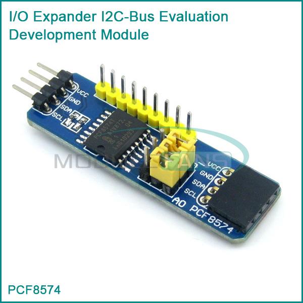

    I wanted to share with you my USB ButtonBox, which I made with Project Cars on PS4 in mind.
    The design is quite simple and requires few things:
    - An arduino UNO : be careful, as it must have the small Serial/USB AVR located on the top left part (with USB connector on the left). This is an Atmel Atmega16U2 or Atmega8U2 . Some clones do not have it.
    - Two I2C I/O extender to make a 8x8 matrix in order to have upto 64 buttons :) I'm using some cheap PCF8574
    - Push buttons, start button (all NO ,normally open)
    Key Concepts:
    • Turn the arduino to a keyboard : The ATmega16U2 chip (top left) on the Arduino board acts as a USB/serial interface allowing programming through USB. It runs a software like any AVR implemeting serial/USB conversion that can be updated through a special usb protocol called DFU (Device Firmware Update). Some other software will allow you to turn the ATmega16U2 into a USB HID (keyboard, mouse, or any Human Interface Device). Be careful: when USB HID code is uploaded on the ATmega16U2, programming the arduino becomes impossible unless you revert to the original ATmega16U2 code (or program using an AVRISP programmer) So program the arduino first, then the ATmega16U2 using procedure describded here and the firmware Arduino-keyboard-0.3.hex attached to this post.
    • Button matrix : the arduino has only a few pins available. Not enough to make a decent button box upto 64 buttons. Using an Arduino Mega would be overkill, so we need to be smart and use a matrix. A button is not attached to one pin but to two pins organised in row / column. To detect a keypress, we need to find the col/row making the code a bit longer than just checking the pin low/high state. We are using 2 I2C PCF8574 daisychained in order to make a 8x8matrix. Each PCF8574 is assigned a different I2C address resulting in two slave address. Only 4 wires (SDA/SCL/+5V/GND) are used on the arduino. Easy part :p
    The difficult part : soldering. Once the buttons are mounted, you need to implement the row/col matrix. To make things easier, I decided to have 8 columns to make wiring more straightforward. I started by wiring rows using unprotected wire, then I moved onto column soldering without making shortcuts by using some stripped insulant. Note the A0 jumper on rows .
    The code also implements a keypress repeat : leave a button pressed for 400ms and it will be repeated quickly every 30 millisec
    Steps:
    - I glued a millimeter paper onto 3mm plywood and made some holes with a dremel. Then drill the proper pushbutton diameter and mount all buttons (apply a 3M carbon look before if you need). Align all buttons connectors to make soldering more easy.
    - Implement the matrix as describded earlier
    - Upload arduino sketch
    - Program ATmega16U2
    - Done
    Maybe I'll rework the sketch to avoid using I2C extenders, as you may not neet 64 buttons, like in my example (8 col / 4 rows)
    Works great with PCars on PS4, but not with Dirt Rally as it doesn't support (yet.. I hope) additionals USB keyboards
    Enjoy !

    You also need to order I2C extender as shown in the picture. Then time and patience will become your friend. This project is not the simplest to start with, but you can give it a chance.
    Good luck !

    Hi Guys,
    Sorry to resurrect this thread, but, I'm just about to embark on this project and need to know if I need to install libraries for the I2C extenders or will they work directly from the sketch in the download file.
    Thanks guys !

    Check the sketch for dependencies, or try compiling it :):
    #include <Wire.h>
    #include <pcf8574.h>
  16. Andi4x4
    Andi4x4 New Member
    Apr 25, 2018
    7
    isle of man
    211Coins
    Hi vthinsel,
    I haven't tried uploading the sketch yet, but, those two lines of code are present in the sketch. Just wondered if there was anything else I needed to include as I had to install a l2C library to use a LCD on another project.
    Will give it a go as it is to start with. Will it work as a keyboard before I flash the ATmega for testing purposes ?

    Ok, uploaded sketch to Arduino UnoR3 and got a "missing library pcf8574" so downloaded one from internet.
    Now getting the following error message when I try to verify/upload -
    (sorry guys, I am a complete novice with Arduino and code so any help gratefully received ! )
    Code:
    Arduino: 1.8.5 (Windows 10), Board: "Arduino/Genuino Uno"
    C:\Users\laptop\AppData\Local\Temp\arduino_modified_sketch_135813\PS4_ButtonBox.ino: In function 'void setup()':
    PS4_ButtonBox:172: error: 'class PCF8574' has no member named 'write8'
       PCF_COL.write8(0xff);  //Pull high
    PS4_ButtonBox:173: error: 'class PCF8574' has no member named 'write8'
       PCF_ROW.write8(0xff);  //Pull high
    C:\Users\laptop\AppData\Local\Temp\arduino_modified_sketch_135813\PS4_ButtonBox.ino: In function 'void loop()':
    PS4_ButtonBox:186: error: 'class PCF8574' has no member named 'write8'
         PCF_COL.write8(~hex_data[r]);
    PS4_ButtonBox:187: error: 'class PCF8574' has no member named 'read8'
         uint8_t valueCOL = ~PCF_COL.read8();
    PS4_ButtonBox:188: error: 'class PCF8574' has no member named 'read8'
         uint8_t valueROW = ~PCF_ROW.read8();
    exit status 1
    This report would have more information with
    "Show verbose output during compilation"
    option enabled in File -> Preferences.
  18. Andi4x4
    Andi4x4 New Member
    Apr 25, 2018
    7
    isle of man
    211Coins
    Finally !
    Got it sorted - the PCF8574 library I had was not suitable, so, a couple of hours spent trawling the internet eventually yielded one that did, then issues with the Atmel Flip flash software slowed me down another couple of hours.
    Now, however, just over 4 hours later, it is all working !
    Yay !
    Button box construction is well under way - box is drilled, carbon effect vinyl applied, switches fitted - just gotta solder it all up !
    Will take some pics and start a separate thread for that in the appropriate place !
