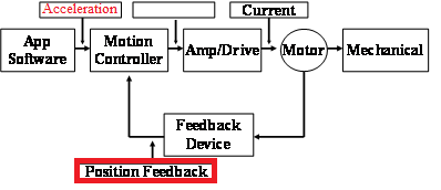

    According to your schematics :
    So the closed-loop control is base on angle position feedback (in deg). No trouble for Pitch roll and Yall.
    But what about Surge, sway and heave ?
    Set point input must be in G (or % of 9.81 m/s²) because it's a acceleration. no trouble with that, it's logic!
    so in standard closed-loop control we need feedback corresponding of an acceleration, but not a angle position as configured in lot of exemple I can see on arduino program or so one.

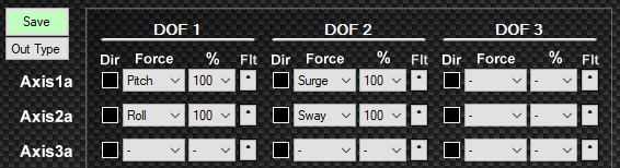

    ok, I agree. I considéring angular movement with uge travel. In "axis assignments" you can choose which of set points use and choose a sort of proportional scaling as shaw here for exemple, as you describe, ok! :
    I totaly agree with that! I speak only on Surge and Sway acceleration. :thumbs

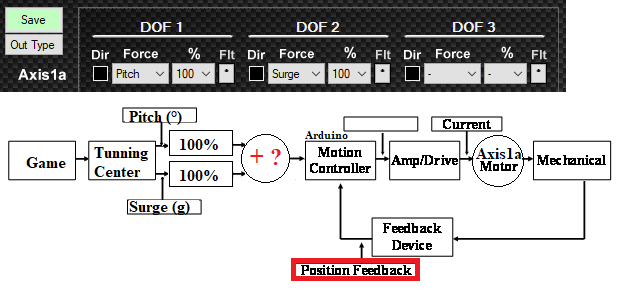

    That why I will take an usual exemple for one axis configuration :
    Some simulator with arduino work like that. Replace 100% with what is convegnient value for you, doesn't matter...
    I understand we want to moove our seat when car change longitudinal angle (pitch as exemple) AND when we "push" brake or accelerator pedal. Ok, by this way, seat will "moove" in good direction but not with correct amplitude in function of acceleration!
    Take an exemple : a car accelerate with constant acceleration of 0.5g during 2 second. In fact, 0.5g corresponding of sin(30°) of the seat.
    in same case but for 0.125g (corresponding of 0.5g/4) must corresponding of sin(7.18°) and not 7.5° (30°/4)...
    so angle and acceleration is not lineare case for big angle : first trouble in statique!
    In addition seat did not go from 0° to 30° immediately, it will take some decysecond to rich the point, for surge deceleration during violente and continued braking for exemple some latency could appeare in dynamic!
    To sum up, by this way, it did be faithful with real felling we will had if we was in car. In industrial system with closed-loop control to avoid this type of trooble, we usualy associate set point and feedback with same unit... that why I am a bit confuse with ° and g ... in same closed-loop control...
    I understand it could approximately work but not with good dynamique fidelity?
    That why I try another way of moving seat, which allow user to be moved with more accuracy and more fidelity. Correct me If I had made mistake. ;)
