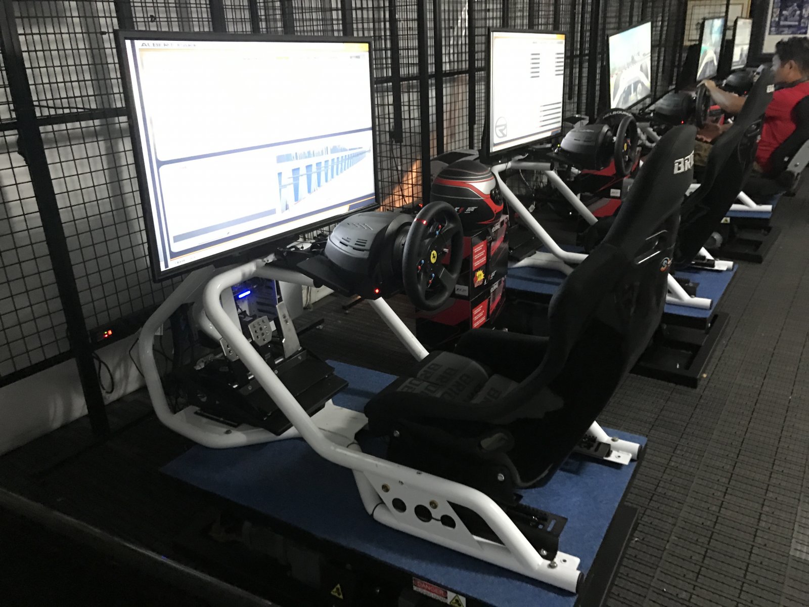

    This is the basis of the sim I want to replicate. Done differently, with the base and motors articulating the frame directly (ie no table in between) I want the whole lot to move including a light weight LED LCD TV.. I've been reading all the pros and cons about seat movers, frame movers etc. At the end of the day I have a real race car, and the whole thing moving will basically impress my friends more than trying to replicate or at least fool my brain into force felt for true immersion.

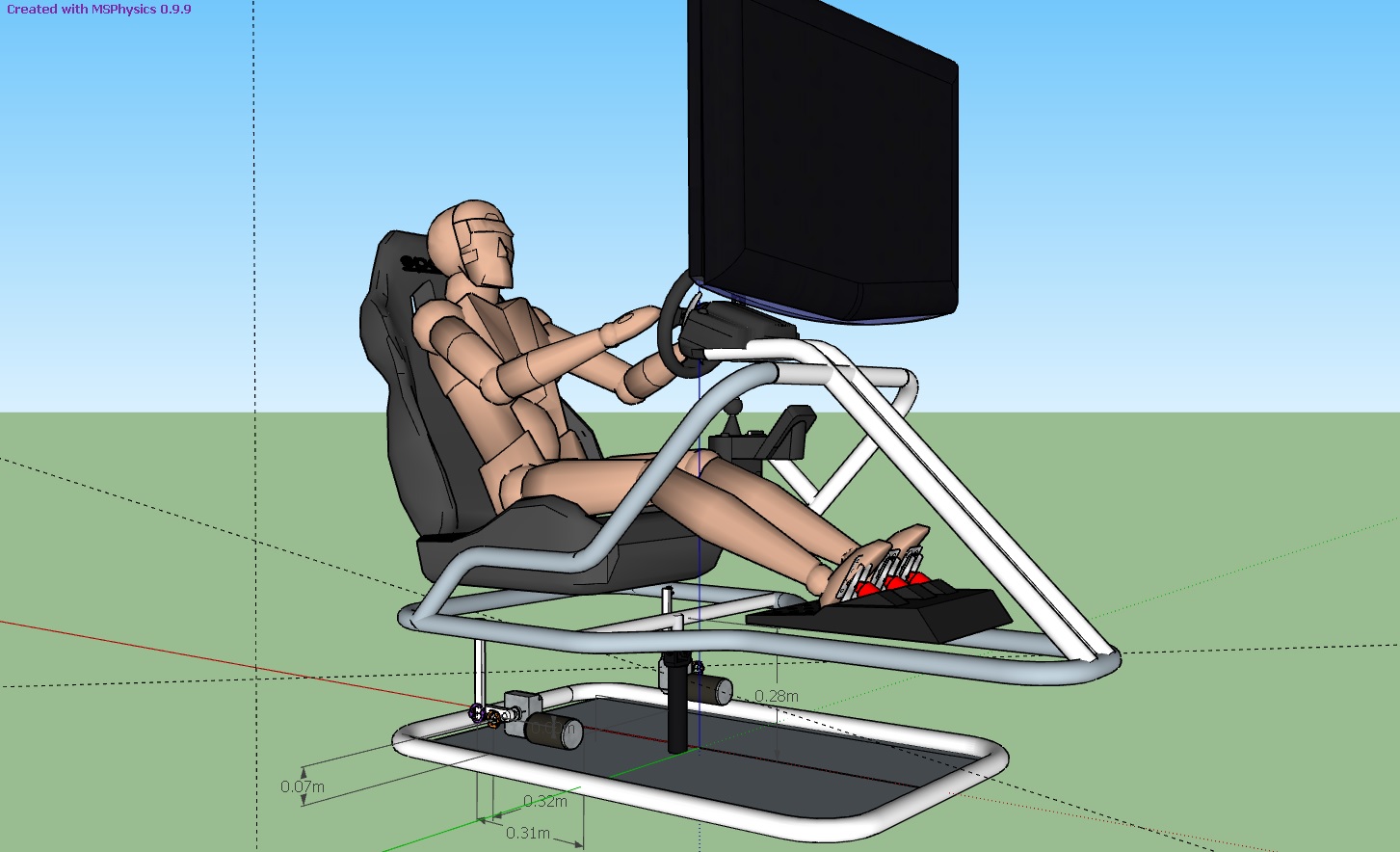

    Ok, pretty much finalised the design. I made a 3d model mainly to make sure things dont clash when moving and i'm bored waiting for my parts to arrive. model moves with Sketchup 2017 and MSPhysics plugin
    I had an idea of the frame using 32NB extra light pipe and wanted to make sure it would look good, sleek commercial looking sim is the aim.

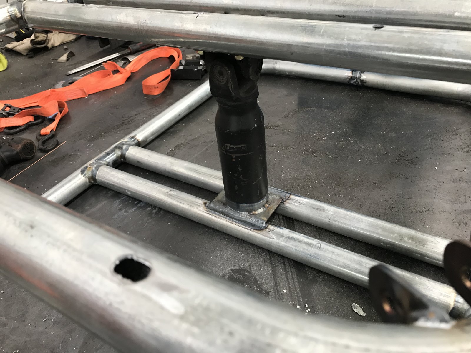

    I will be making a start on the frame tomorrow.. uni joint will be centred on the COG with everything mounted so final location of that hasnt been set but it should be in the ballpark. dimensions for the motor location and length of arms based on getting 8 degrees of motion on each axis (up and down, total of 16)
    what do you think so far?

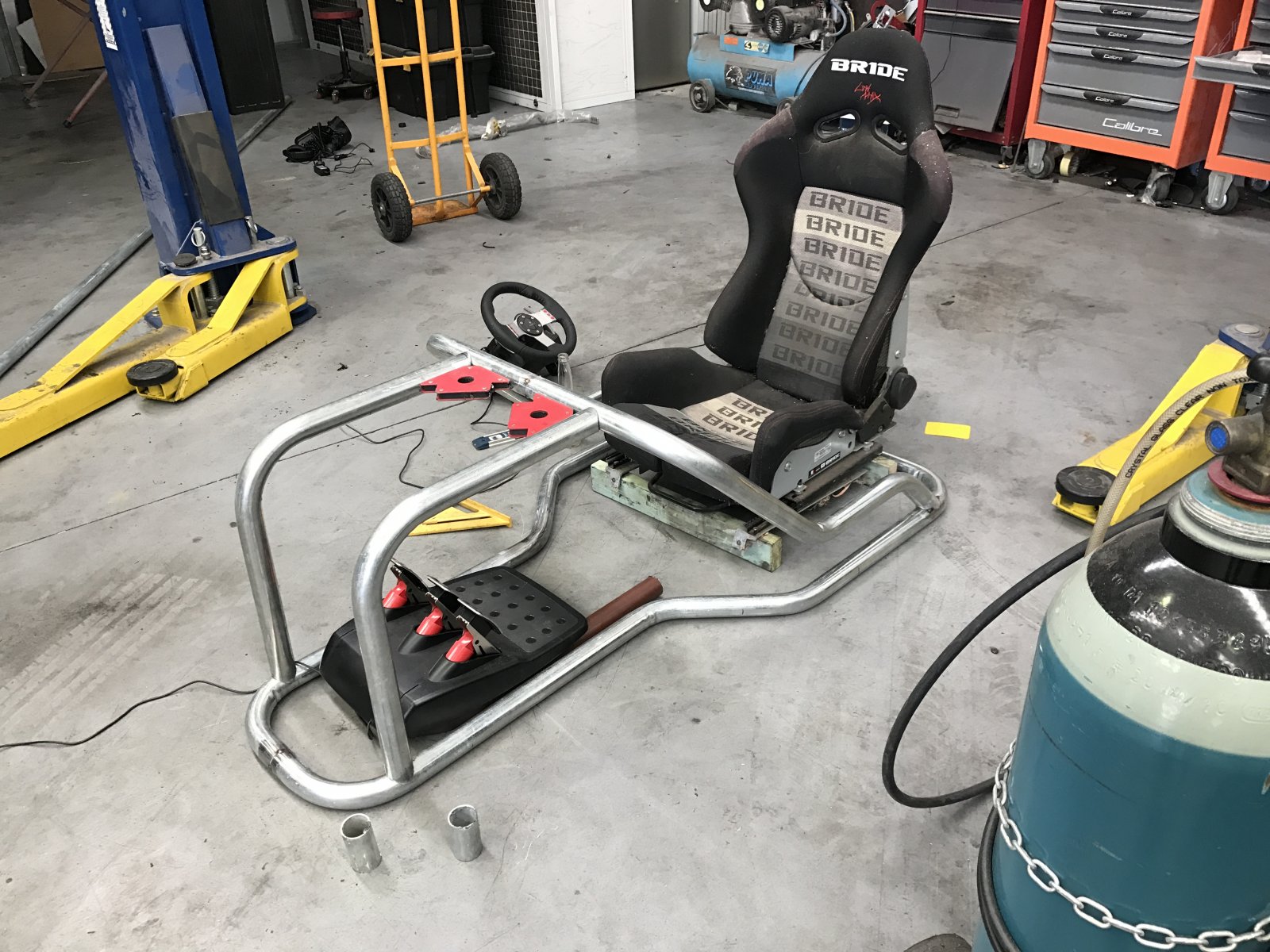

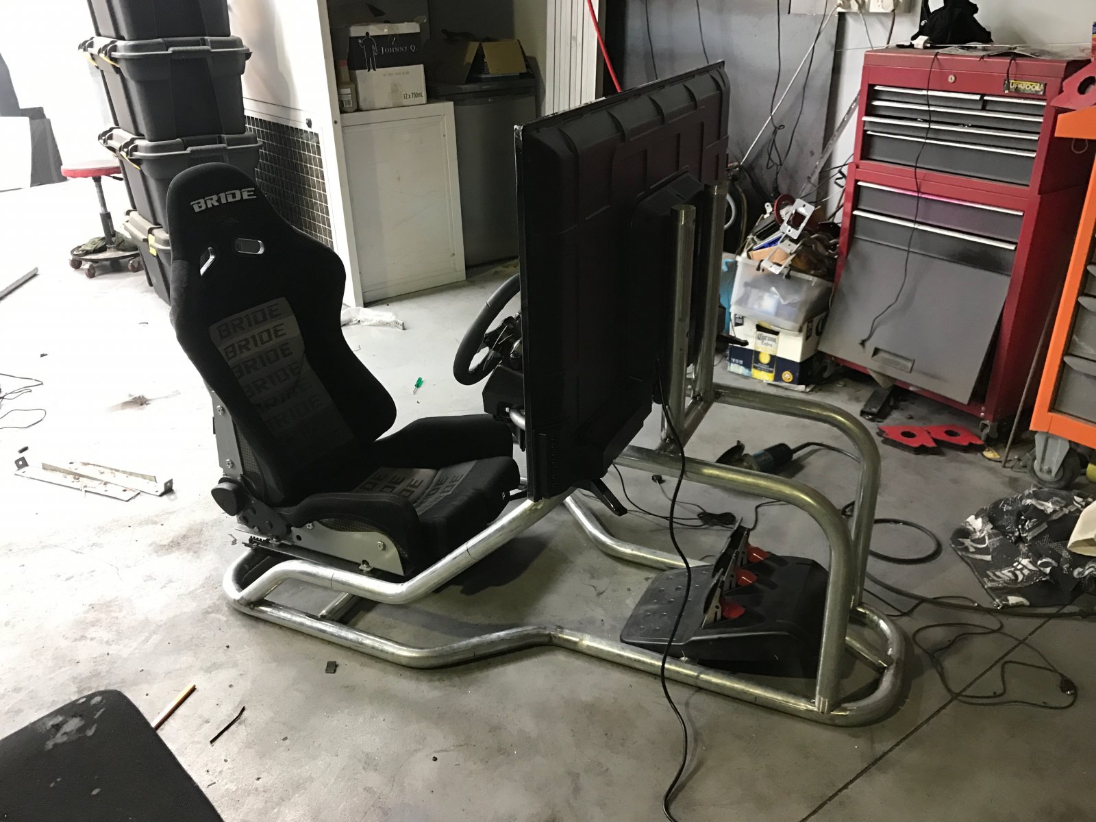

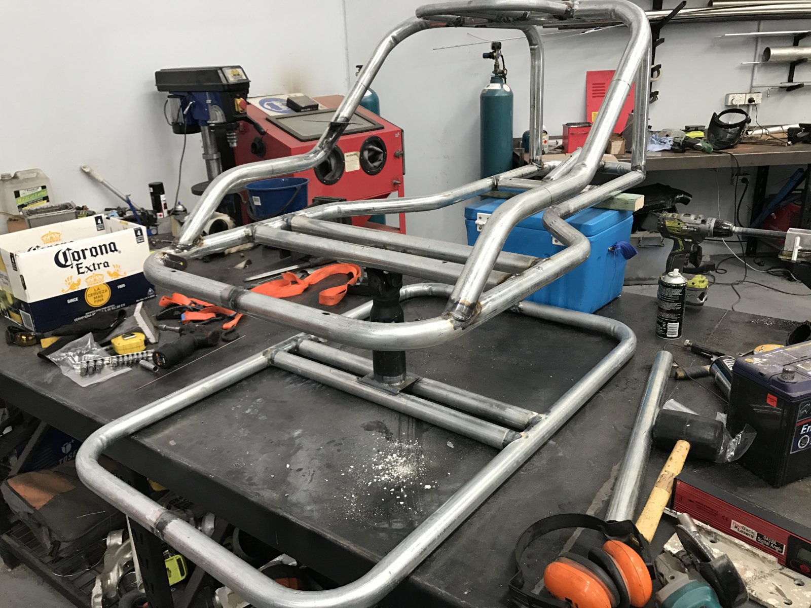

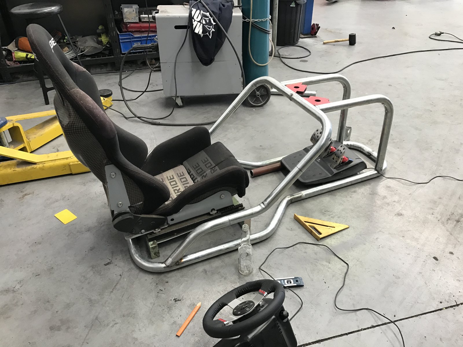

    I made a start on the frame yesterday, bit miffed (annoyed) the extra light NB pipe kinks in the tube bender. I normally bend 2.5mm wall at this radius, it seems 2mm is just too thin. When this one is done I might give it to a friend and make another sans kinks.. It will make the frame about 4kgs heavier though
    Also during a test sit, it seemed the man in my model above is a small child. Turns out he is the same height as me, just has size 3 shoes.. and the pipe running from the steering wheel to the front had to have some adjustment to clear my feet
    heres where im at so far
    Also I managed to pick up two Dell PowerEdge 2950 750w power supplies with a bunch of server case fans for $50 Aus delivered.. which was a score

    I've heard that one way of bending pipe and to avoid kinking is to fill the pipe with sand and cap the ends before bending.

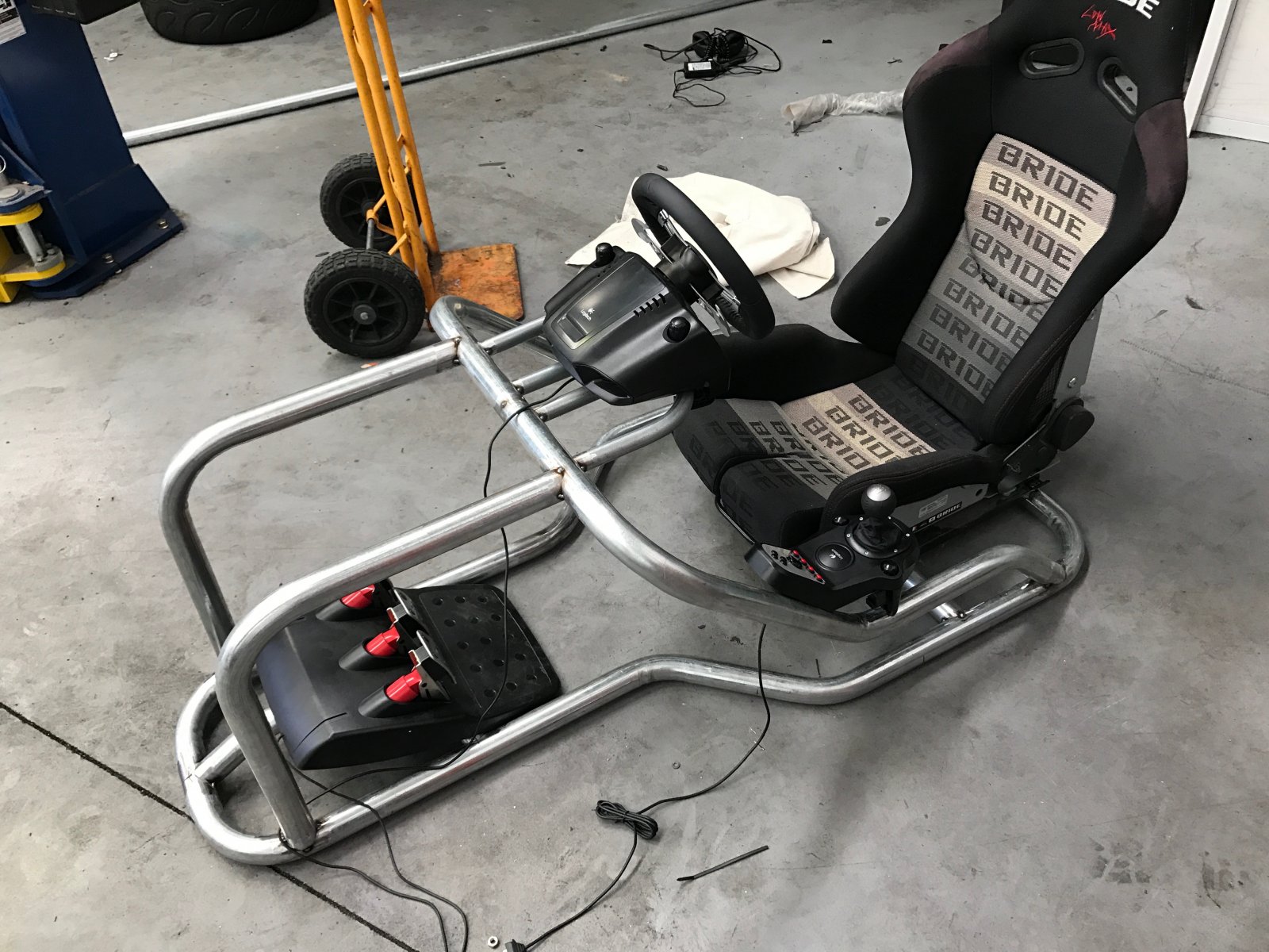

    updates

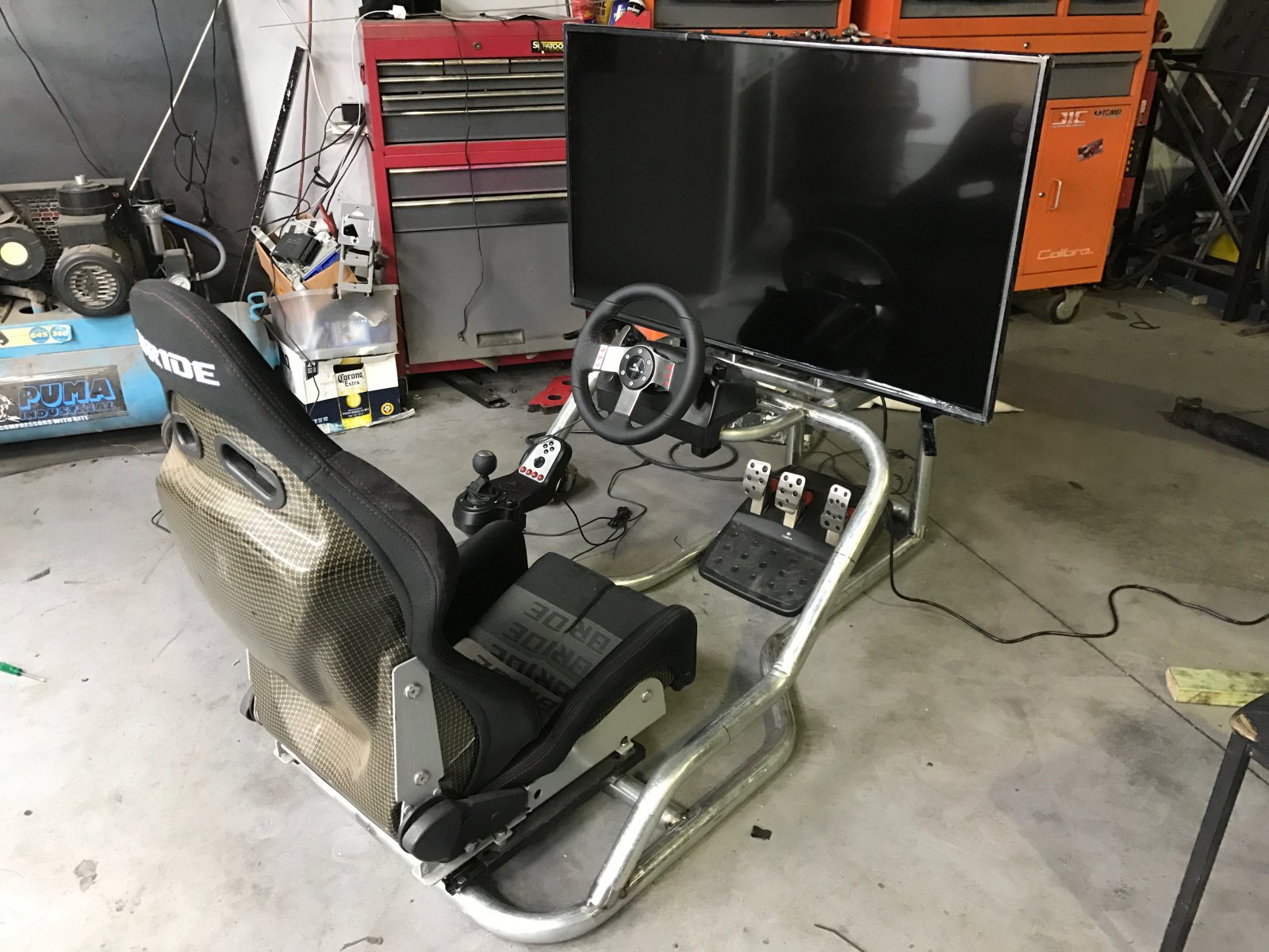

    seat and peripherals mounted.. now i need to get a TV.. hopefully have that mounted this arvo after work as i have just got a text from Aus post saying my motors are being delivered today!

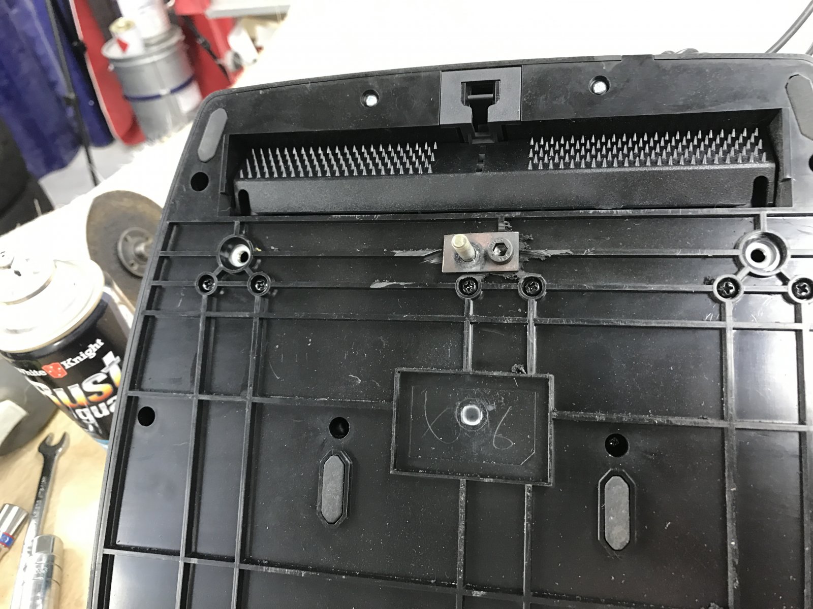

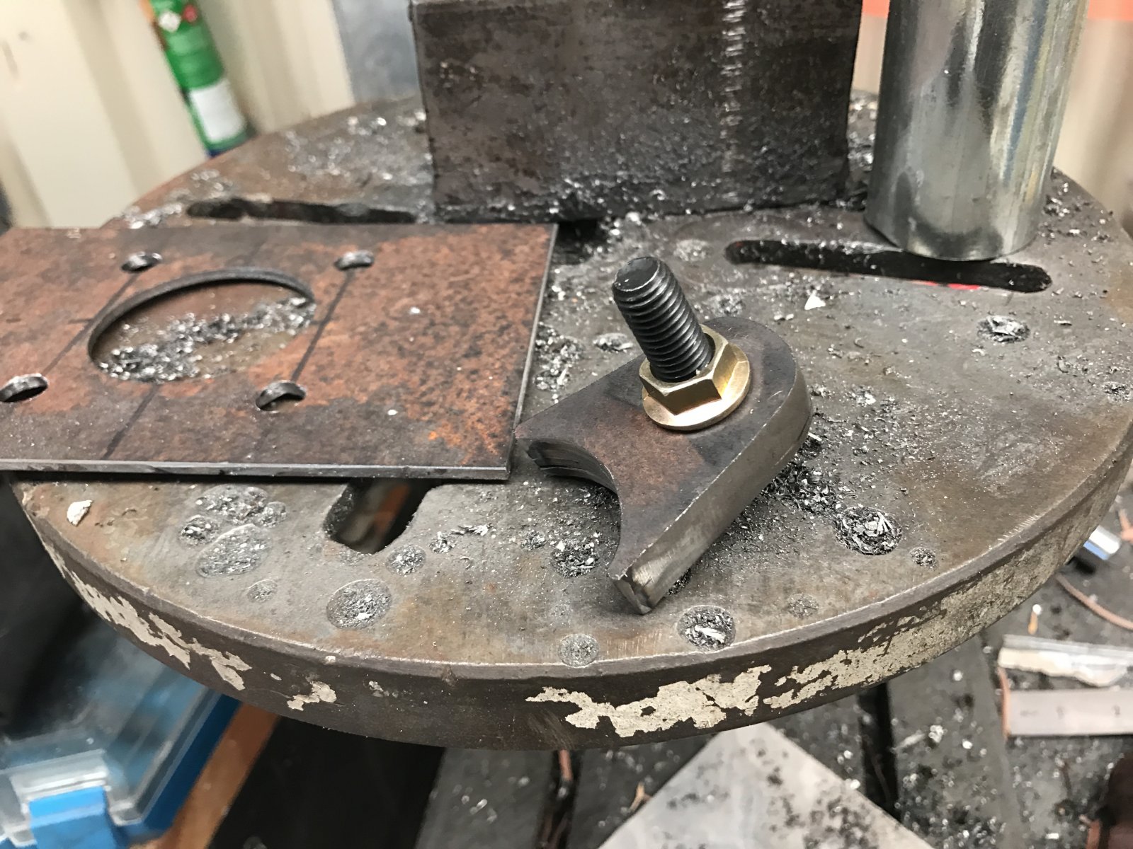

    after spending quite a bit of time settling on how i was going to mount the pedals and being quite happy with the result, turns out the centre bolt hole at the front of the G27 pedals is not centred.. i'll leave my tube centred though else it will look like i messed up and make a lil adapter for the pedals to mount up in the centre.
    yeah ive heard of that.. but who has the time.. i have games to play.. haha.. my draw bender doesnt normally kink 2.5mm walled pipe.. just think the 2.0 is past the limit

    Ok, everything mocked up ready for a cog test tomorrow..

    If you reverse mount the pedals you can probably get more adjustment if that's what you are after. They feel better like that too.

    thats cool.. after seing them dissaembled it explains the design of seattime's carbon pedals..

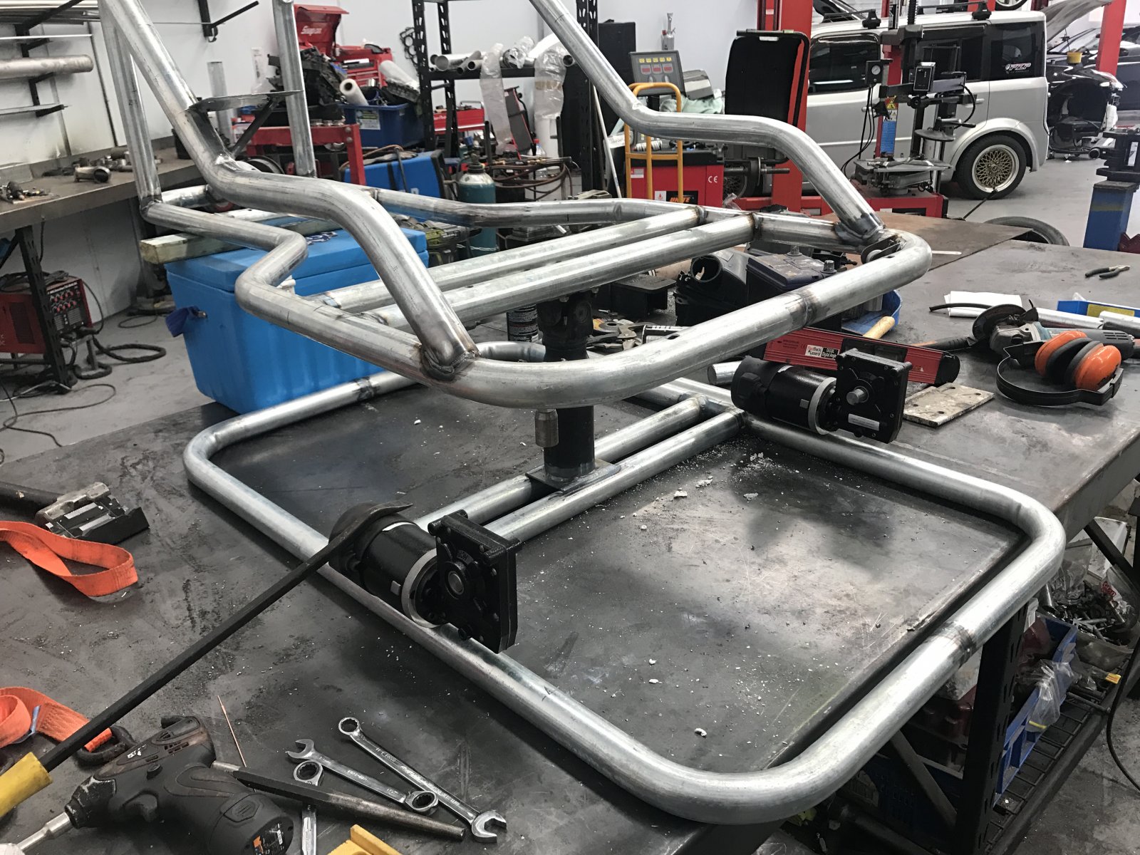

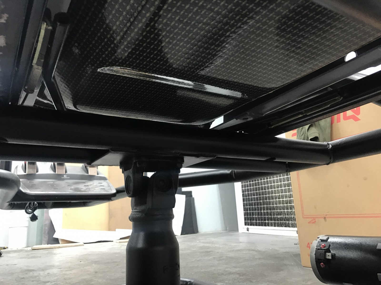

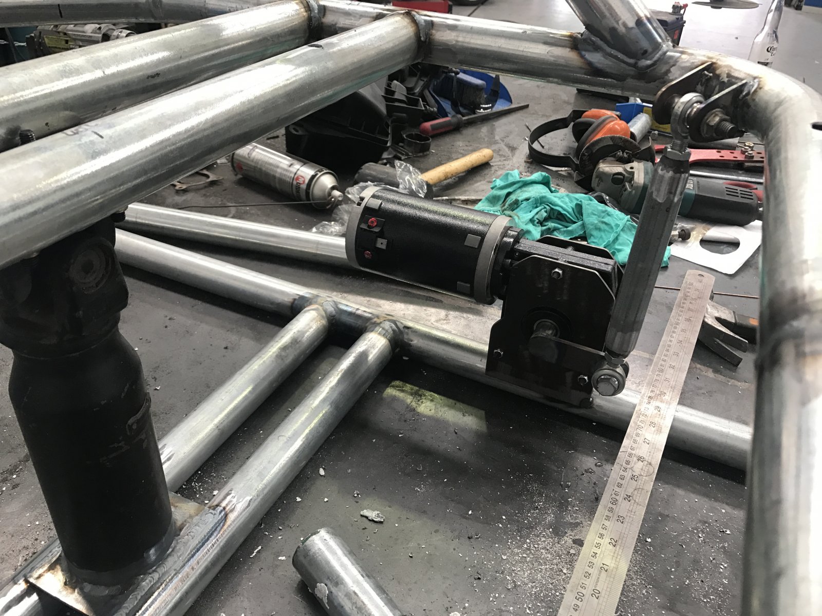

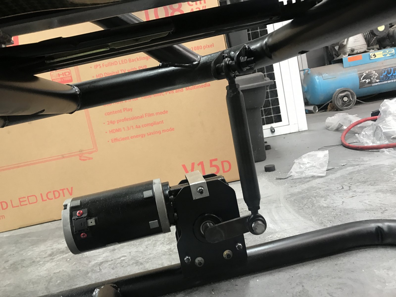

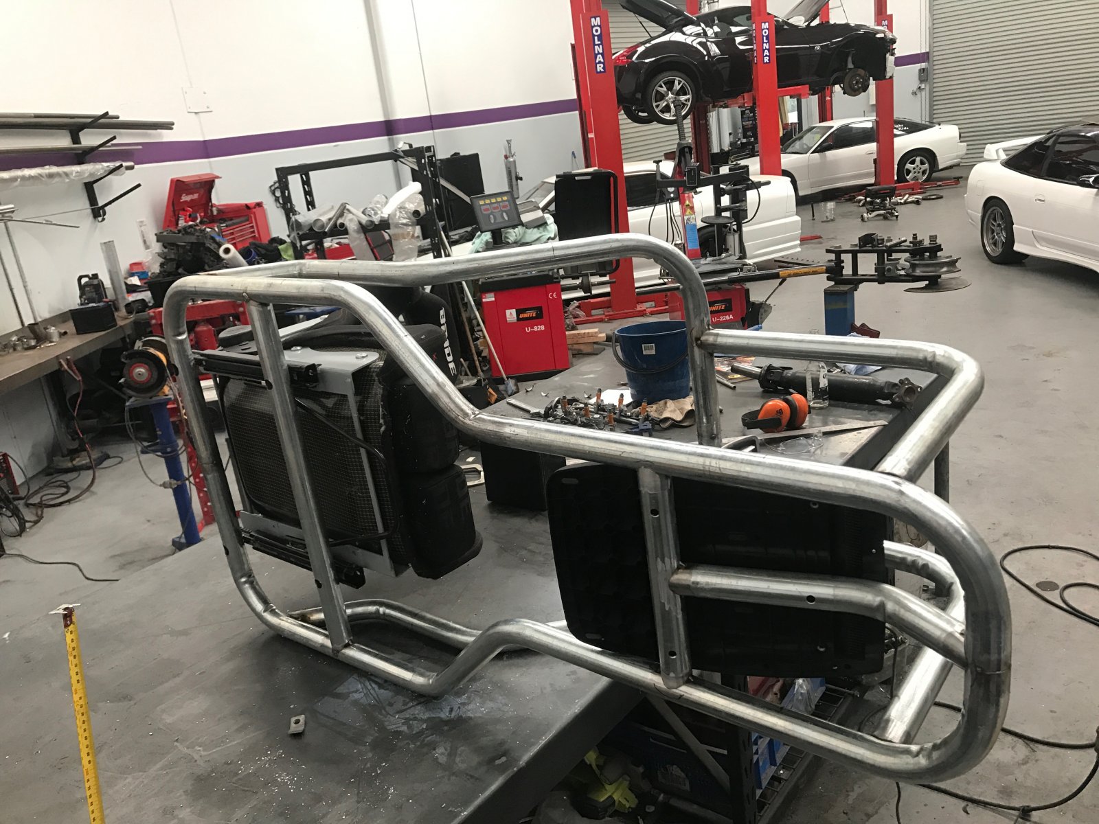

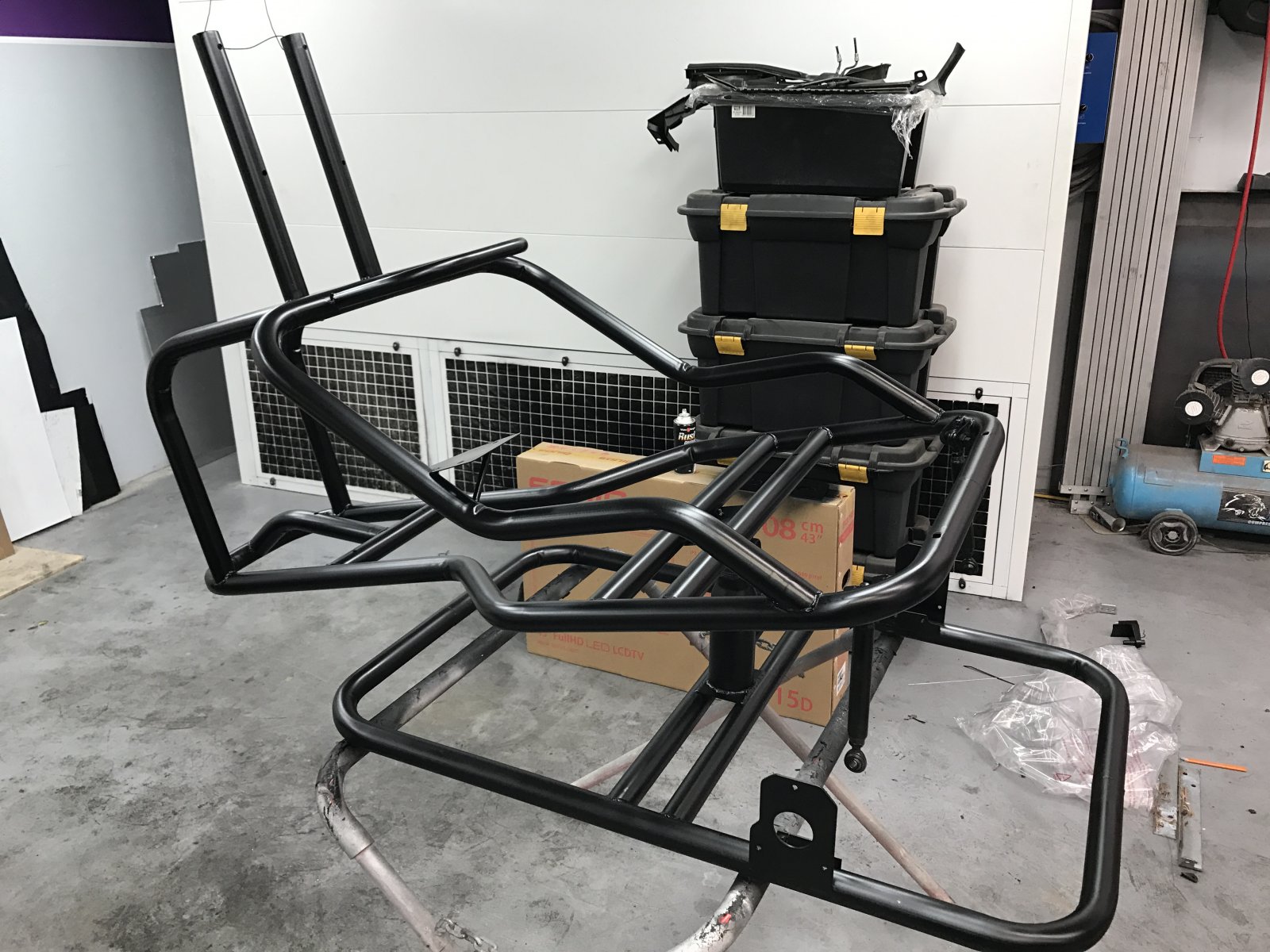

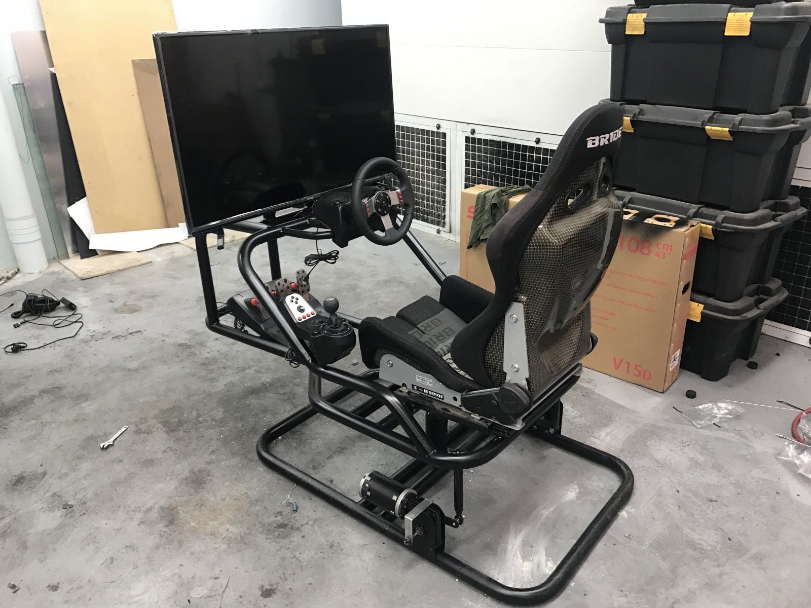

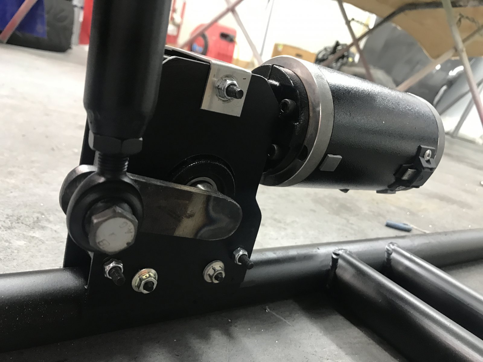

    Good evening boys and girls.. It has been a big few days with the easter holidays and I have completed the fabrication.. all I await now is my cables and wiring gear which should hopefully be here during the week, oh and flexi couplings for the hall effect sensors. I already have the Moto monsters and Arduino Uno. Just need power supplys, headers, wires and some big ass silicon wrapped cable to power my motors, its all in the post somewhere between China, Hong Kong, the UK, Darwin (I know right? who thought Darwin would be the local go to for CNC couplings), Melbourne and here (Perth).. stay tuned!
    some details as follows

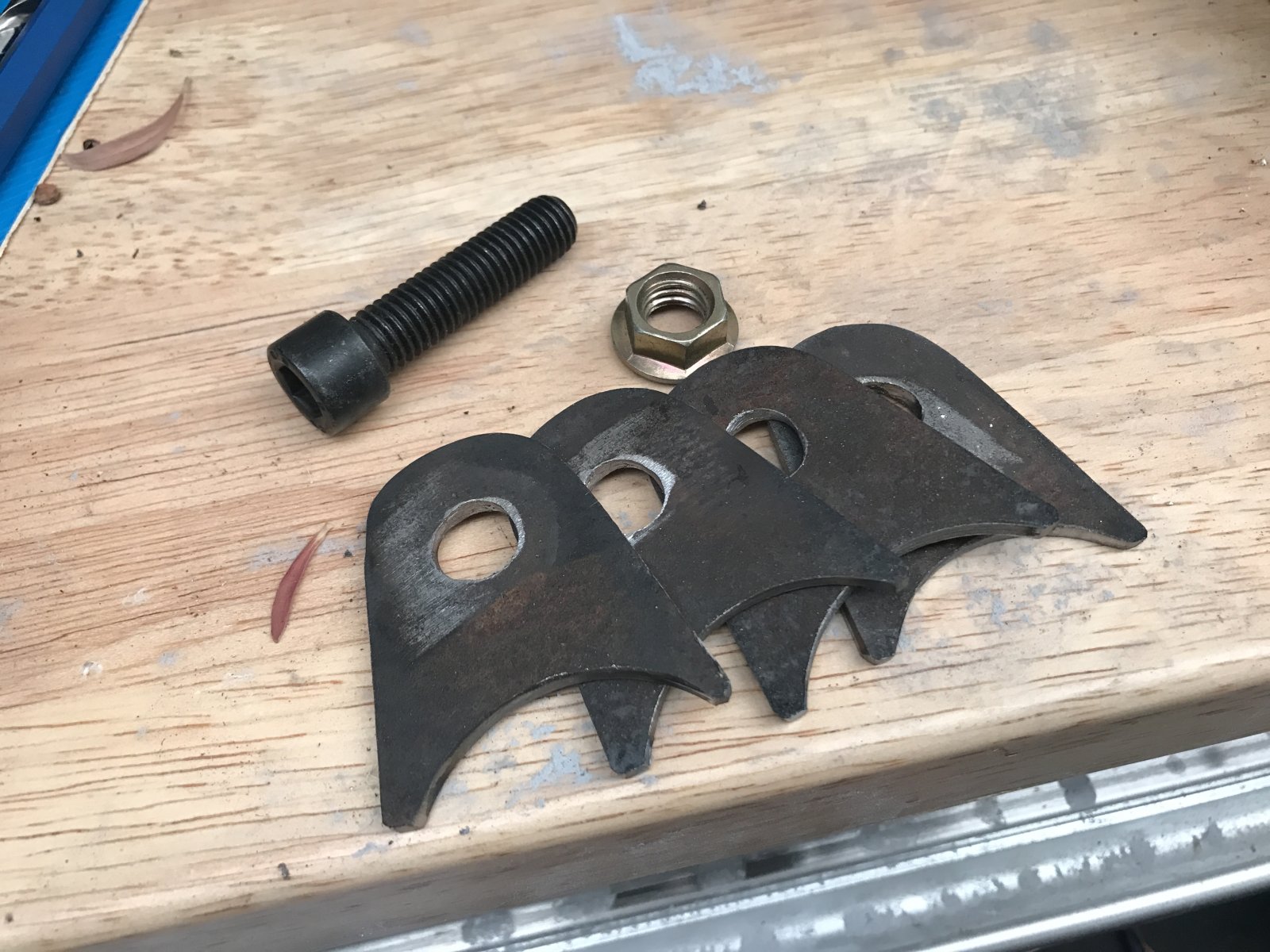

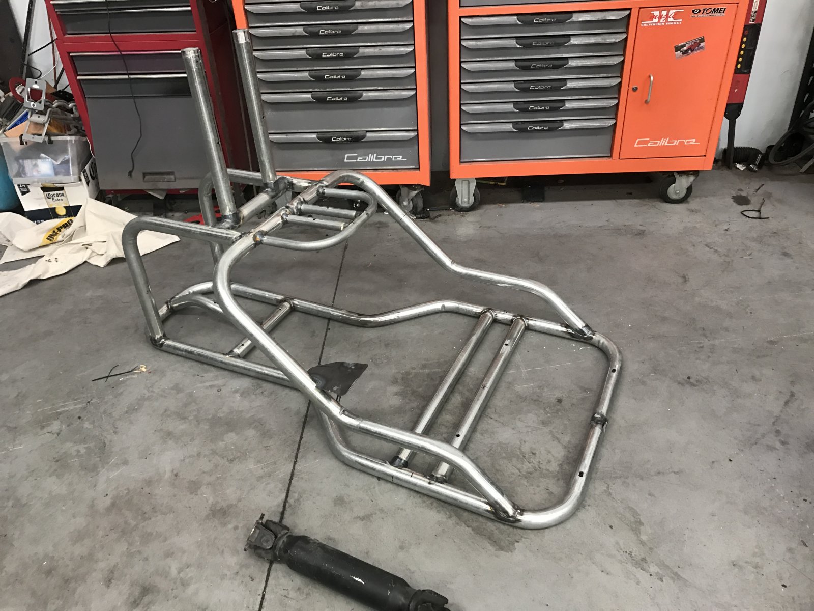

    frame finished ready to be fully welded

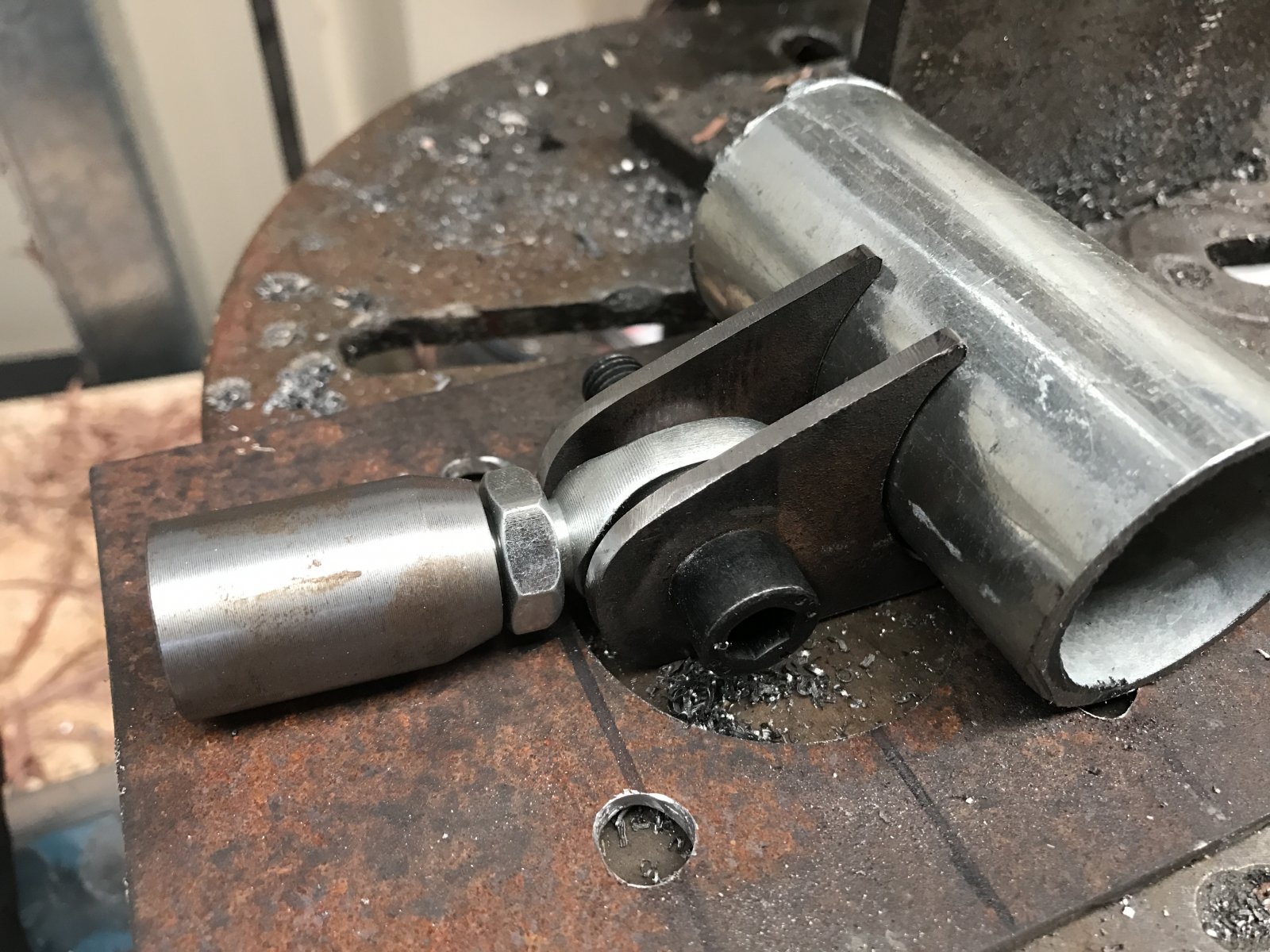

    IMG_0195.JPG Much quicker and more accurate to make 4 brackets at once
    motor mockup IMG_0208.JPG push rod fab, cheapo 7/16 rod ends from local speed shop
    IMG_0211.JPG quick rattle can spray job in satin black

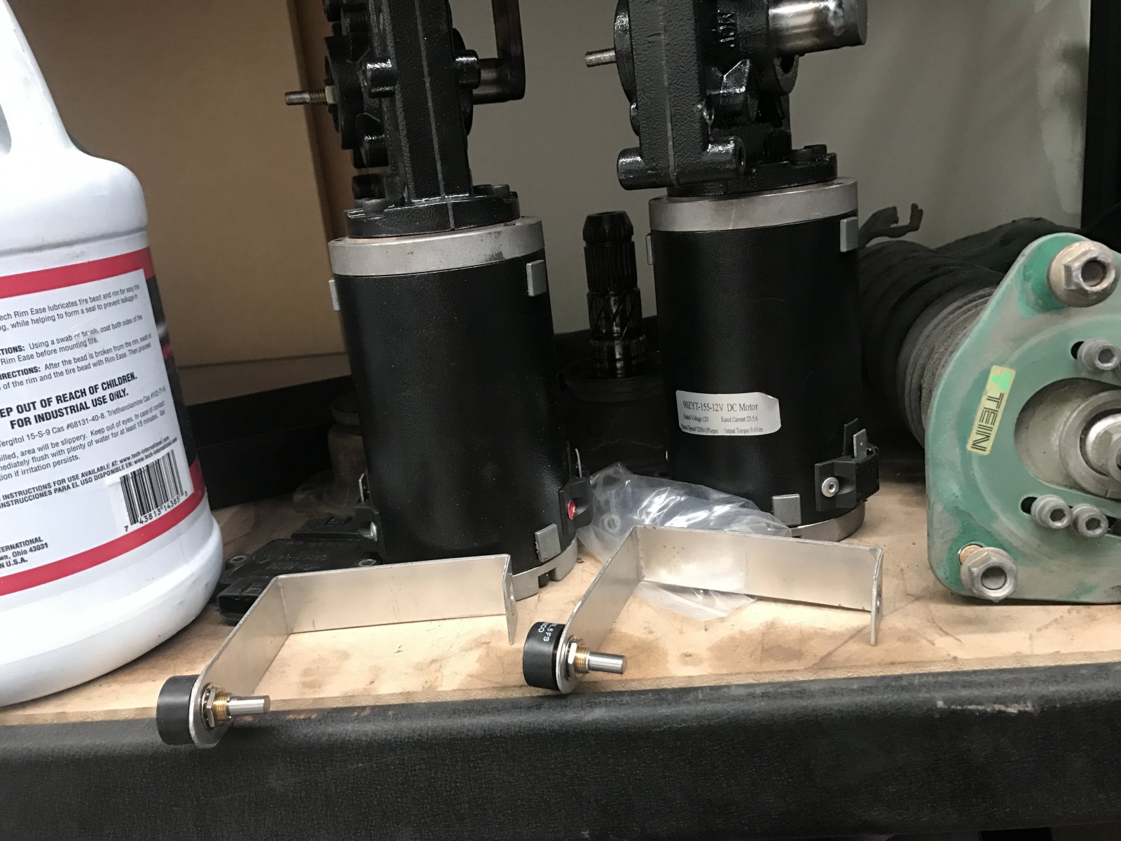

    IMG_0220.JPG 180 degree hall effect sensors as recommended by fellow xsim user. brackets made out of 2mm ally and long to give some flex to allow for some eccentricity on shaft (read i didnt drill it very centre)
    solution to the 'centre' bolt holes on the g27 pedals not being centred.. small bracket to offset mounting 12.5mm so it fit my bar mounted centrally IMG_0231.JPG looking good! just needs some motion! IMG_0238.JPG closeup of the motor actuator rods/connections IMG_0241.JPG I toyed around with so many options to fix the arms to the motiondynamics motors.. i ended up just TIG welding them directly to them. (did it in 4 passes waiting around 10 min between each till they were cool to touch so as not to overheat the oil in the gearboxes and bearings) IMG_0243.JPG being a car guy i had plenty of these things lying around. this one i found kicking around left over from a car my brother sold ages ago with no engine as he stole it for his car even longer ago IMG_0244.JPG
    any details you guys are chasing about this please dont hesitate to ask..
    I was surprised how far back the COG was when tested. I guess my lard ass is heavier than I admit to.. getting pretty excited now.. I may or may have not been sitting in her this arvo making car noises while smashing through the 6 speed

    Slick fabrication work, your rig looks really nice :thumbs
    You have somewhat limited the leverage advantage in where you placed the motors. At least if you find it struggles under load you can move them and the attachment point toward the back, as you have plenty of room.

    thanks man, appreciate the feedback
    I chose the points based on the range of motion I was trying to achieve. its hard to calculate the force required on a balanced rig to accelerate the given inertia. thought a suck it and see approach was better than pondering what ifs for too long.. can always shift the connection points as you suggest, or shorten the arms on the boxes, (those are free), or worst case, put bigger motors on, change gearbox ratios etc (not so free).. thats the next part of the fun, testing phase..
