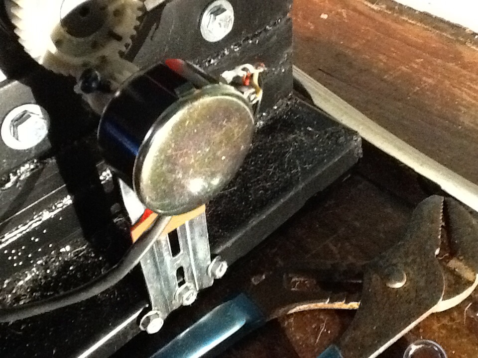

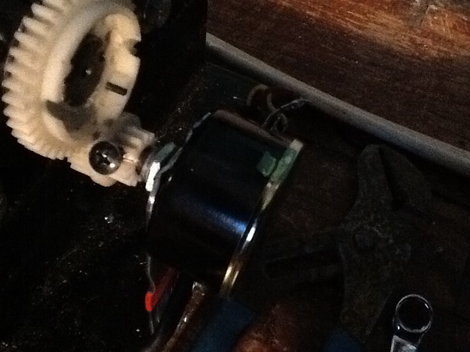

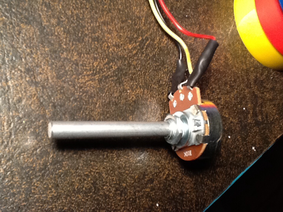

    This is a radio shack 10kohm linear potentiometer. They work fine. Just wear out quick.
    This is 10kohm wire wound linear potentiometer. Cost a little more not much though. And has already outlasted the ones I started with. Can't speak of halls haven't tried yet. I'll get a better pic of the wire wound and post. But to answer your question I believe they have to be 10kohm and linear. So not sure if the 5k will work. I have 10 meg pots from old project and they do not work.

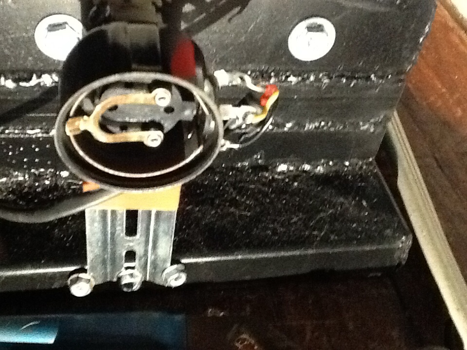

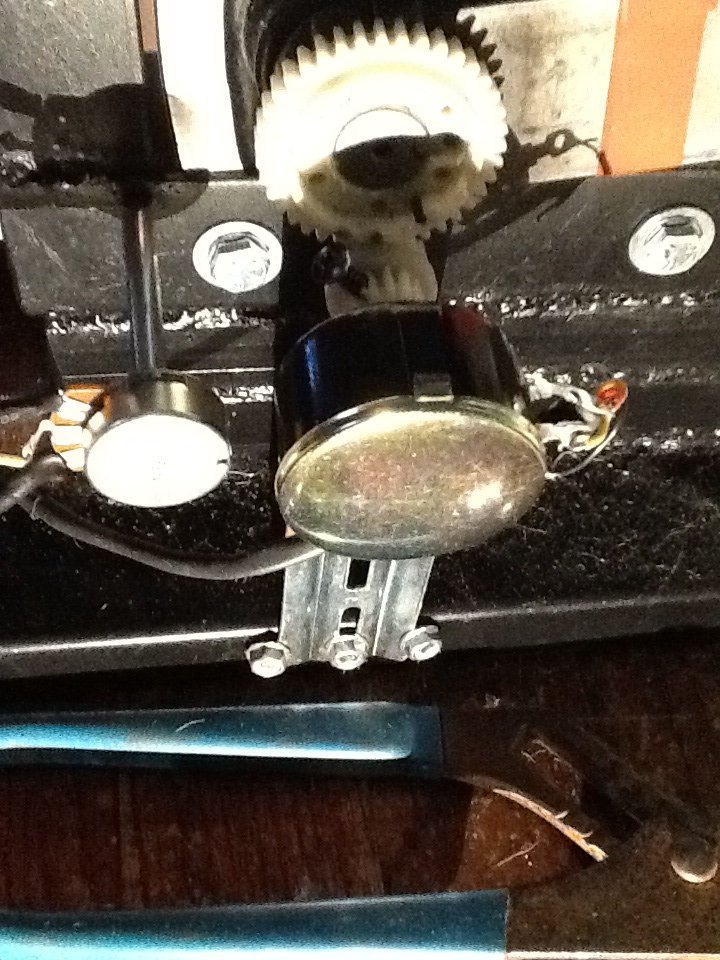

    A couple more of the wire wound
    With and without cover
    And side by side. Quite a difference.
