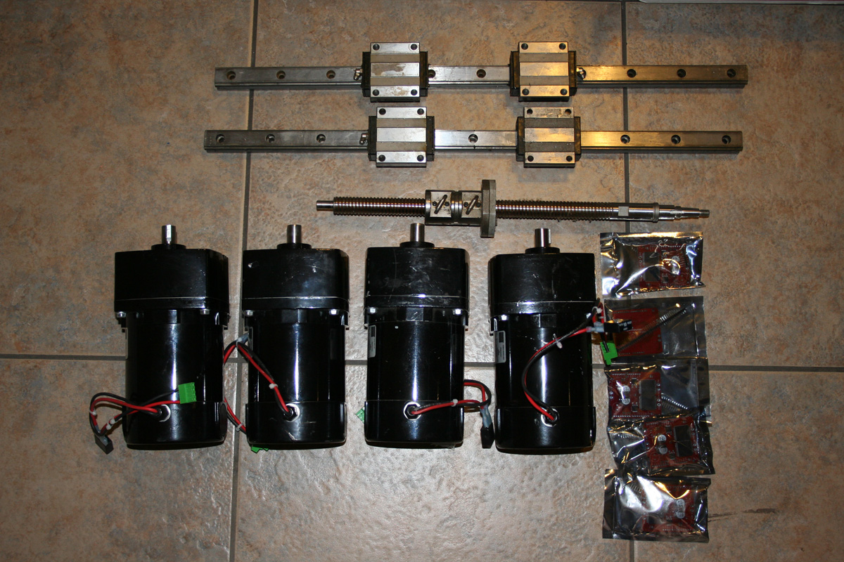

    First I would like to say thanks to a few nice dudes here that has been nice enough to answer a lot of my dumb question via some thread and PM. @bruce stephen, noorbeast, SilentChill,
    BlazinH
    Now I have finally get the idea how this work and got the motor running using Ardruino and MM driver. But I am sure got a lot more dumb question coming soon. I decided to buy a bunch of these DC brushed motor and try them out first, I haven't give up on my DC RC Brushless motor yet. Just want to get a brushed set up to run first to understand how thing work. :) In case anyone want to know what I'm saying " http://www.xsimulator.net/community...he-motor-have-to-change-direction.7163/page-2"
    So, here's what I gather so far. ( I am planning to build a couple of platform, so I bought spares)
    Assetto Corsa
    Logitech G27 Racing set up
    6x + Bodine DC brushed motors
    10x MM driver (mind as well right? giving the reputation of defective) (this is why I want to try brushless rc motor, them speed controller is 95% more realiable).
    2x HP power supply on the way.
    Here's what I have laying around...
    25mm heavy duty rail
    25mm precision ball screw.
    This isn't a build thread yet, I am still trying to throw around idea of what I should build? Any suggestion? Ball screw for surge? but these motor are slow, 45rpm (probably won't be fast enough with this ball screw. Are there any benifit using ball screw for surge or no?

    I gather your plan is to test ideas and then cannibalize the test project to build something grander once you figure out the kinks.
    A basic 2DOF seat shaker is always a good way to come to grips with the basics.
    @Simon_lebel has just got his rail based surge going and a ball screw would be more efficient than worm drive: http://www.xsimulator.net/community/threads/4dof-bass-shaker-wind.7217/#post-84479
    I guess you are only constrained by your imagination and how much time and energy you want to devote to testing/learning.

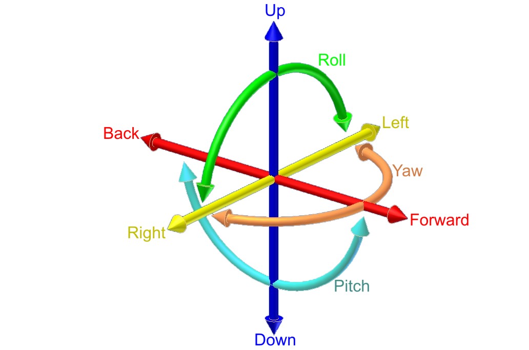

    I kind of know what I want to build... 2dof + surge? But then I thought since I already have bought a lot of motors, enough for a 6DOF, why not go straight there? But a 6d0f does have not have surge right?
  4. Pit
    3,013
    30,418Coins
    +3,088 / 31 / -0
    IMHO I determine you do not know what "6DOF" does it mean and how it is working. The big advantage of a 6DOF is the moving of the platform in all directions. Already the 6DOF says it is a "Six degrees of freedom" platform: "the body is free to move forward/backward (surge), up/down (heave), left/right (sway )(translation in three perpendicular axes) combined with rotation about three perpendicular axes, often termed pitch, yaw, and roll".
    20,570
    145,238Coins
    +10,783 / 52 / -2
    A 6DOF is a complex beast, it would not be impossible for a newbie but is certainly not an easy project to start with as there are numerous complexities in the build, the electronics and in setting it up.

    Hi again helisfreak. May I ask why you are so intent on having a surge table? You do know that a 2dof seat mover does surge already don’t you? If fact, imo nothing works better than a seat moving to simulate surge. Again, just my opinion, but I believe a surge table, to really be effective, needs to have a lot of movement (with good speed). I’m talking about a dedicated building for your simulator to operate in a lot of movement (or at least a very large room). And a platform that rotates on its pitch axis to simulate surge is not as good as a 2dof seat either because the rotation at your feet does not feel natural and it also takes too long to move from one extreme to the other. A 2dof, with the right components, moves extremely fast and keeps up with you as fast as you can accelerate and brake and does the best job in making your brain think its real, again imo.
    And while a 2dof is simpler to build than a 6dof, a 2dof with a surge table too makes it much more complicated and may be just as difficult as a 6dof in ways. But to be quite honest, imo the biggest issue with 6dof and simtools atm is there is not a way to do the math calculations required to make a 6dof work its best. It works yes, but the motion is just so-so from what it could be with proper math applied to your specific design.
