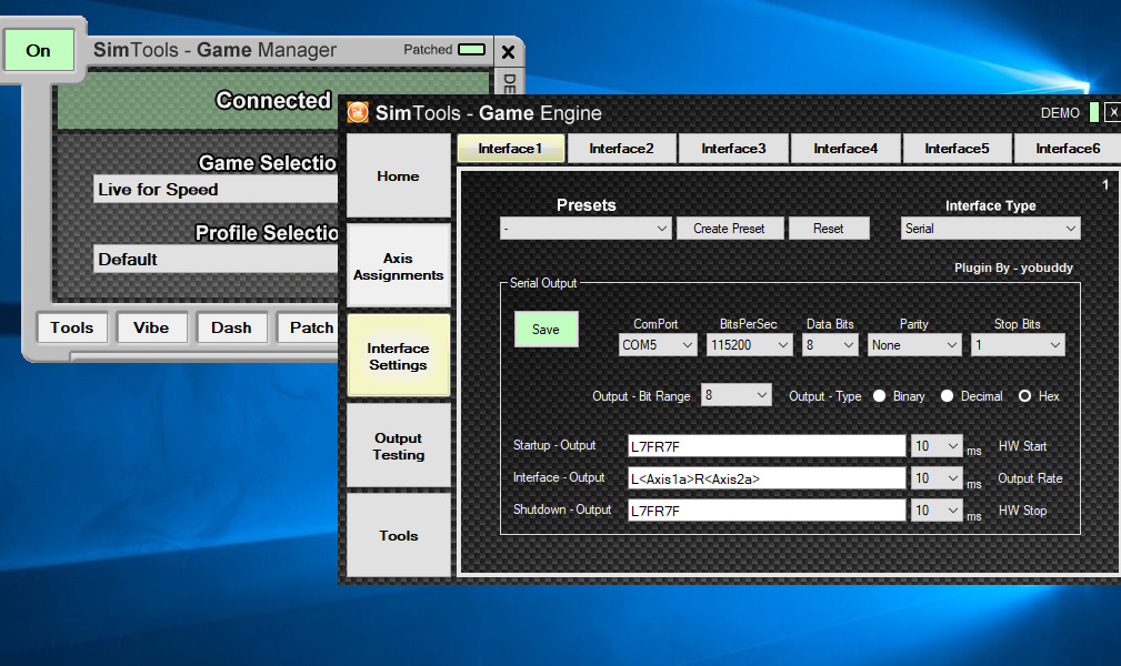

    Hi guys, I finally had some time to continue my work with the simulator. Later when I come home from work I will upload a video with what I've done until now.
    I managed to control the direction and the speed of the motors, but I have minor problem and I don't know how to fix it.
    The problem it is that when I turn the pot one of the motor will stop. (not always, only if I am turning it fast, if I go slowly the motor will not stop).
    Another question that I have: is there any possibility to get a license for a month? I'd like to integrate the game with what I've done.
    21,512
    150,692Coins
    +11,018 / 55 / -2
    The demo version of SimTools has the fully functional Live For Speed plugin pre-installed specifically for testing purposes: https://www.lfs.net/downloads
    Make sure you run a LFS race in first person mode before patching it for motion, as that generates some required files.

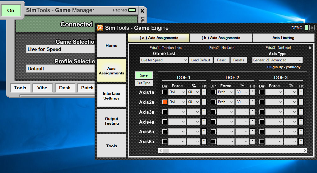

  8. Andrei14
    Andrei14 New Member
    Nov 7, 2018
    23
    183Coins
    That's the problem I'm facing, I managed to connect my motors with the SimTools, but I don't know why the motors stop..
    21,512
    150,692Coins
    +11,018 / 55 / -2

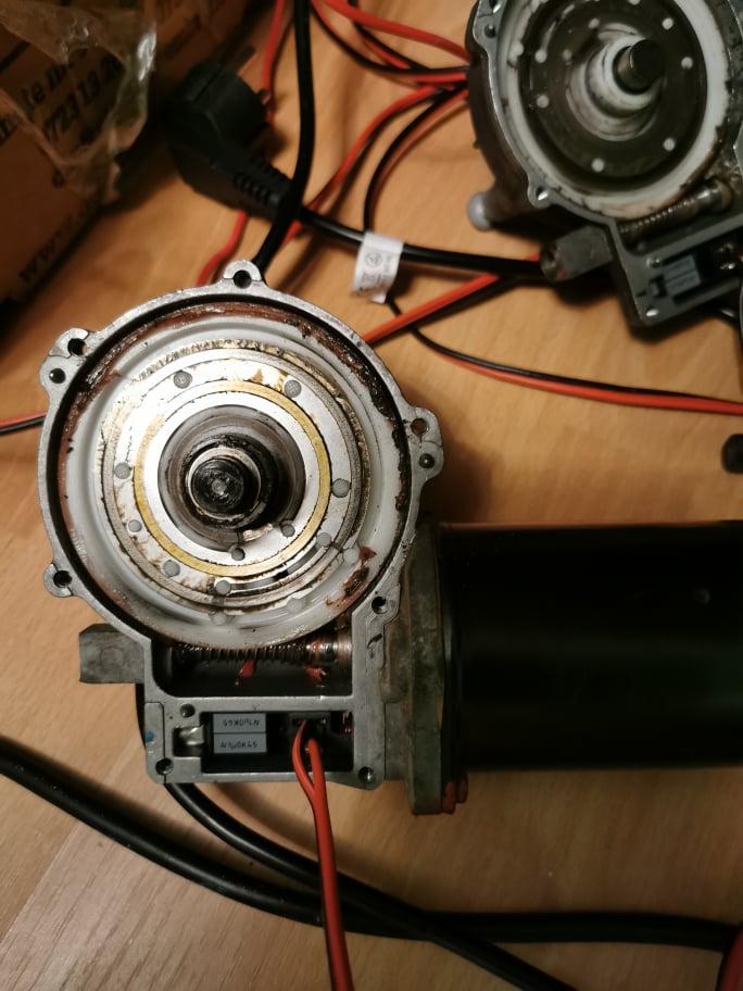

  12. Andrei14
    Andrei14 New Member
    Nov 7, 2018
    23
    183Coins

  15. Andrei14
    Andrei14 New Member
    Nov 7, 2018
    23
    183Coins
    Checked everything and I can't figure out why it behaves like this.
    Do I have to isolate the motor ground? I can't figure out why when I'm turning the pot my motors/PSU stops..
    It's frustrating.
  16. noorbeast
    21,512
    150,692Coins
    +11,018 / 55 / -2
  17. Andrei14
    Andrei14 New Member
    Nov 7, 2018
    23
    183Coins
    Wiper motors isolated - and I still have the same problem.
    Tried with another motomonster, same behavior.
    I believe that the problem is with the back EMF, that's why my PSU keeps shutting down.
    I found some threads here, but I don't understand what it would be better to use:
    1. A diode.
    2. Capacitors to absorb the power.
    The problem is: where and how do I connect them.
    I hope to fix this problem, right now this is the only problem that I'm facing, and stops me from building the sim...
    The fact that I can't fix it is frustrating..
