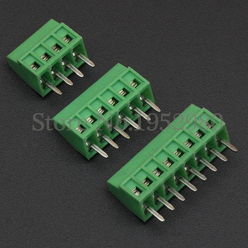

    Any chance of screw terminals instead of jumpers? dunno if your design is final or not, would make it so much more secure.

    The design is not final yet, can be changed. I was thinking to use screw terminals as I did in the prototype 1.x version AMC1280USB boards, but there is not enough space to for them even if I were to use 2.54mm pitch screw terminal. Also these terminals do not come in the size I need.

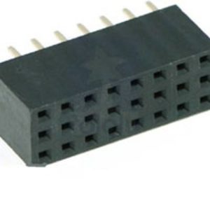

    Using normal 2.54 pitch pin headers is much easier as these are very common and can handle well the low voltage signals for the sensors. You could use some Female headers to solder the sensor wiring on them and plug/unplug the whole group of sensors if needed:
    Or break them to any size you want:

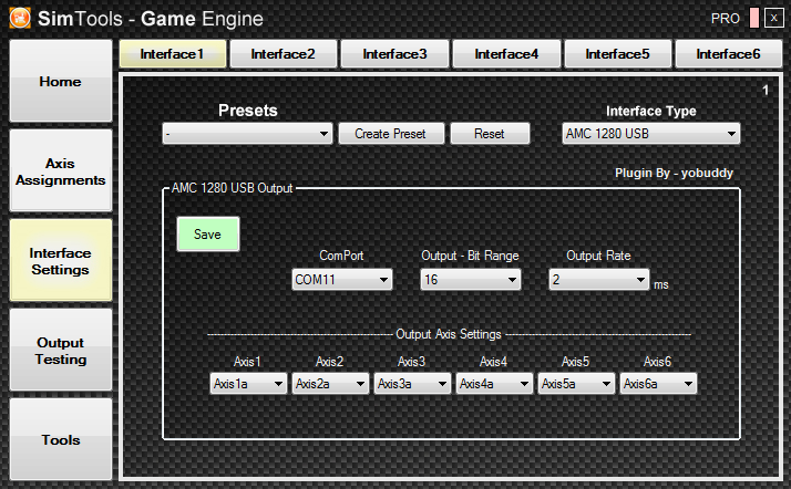

    Plugin interface for the AMC1280USB is in the works!! First initial simple beta was successful before the kickstarter ended! Now on to more features!

    I'm going to post the simple interface plugin here for now, for anyone that already has the AMC1280USB to try, but there will be a specific thread about it later on.
    You only need to choose the COM port that the AMC1280USB takes (autodetection will be implemented soon).

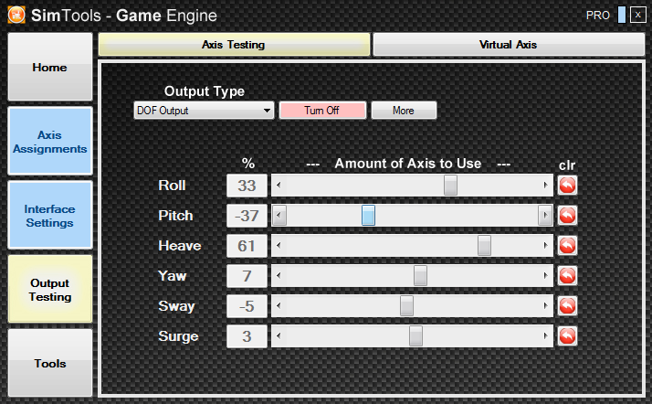

    Here is what I used for testing
