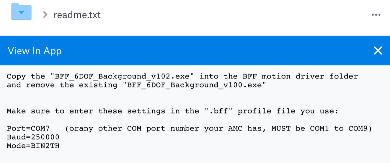

    The reason that you can't link BFF could be that you are still using the old ID.
    Since firmware V3 the new "FF FF" ID forces you to update all softwares so they can talk with the firmware. That's also the case of BFF.
    Last version of heXpod is already updated, concerning BFF you have to do the update manually.
    I'll try to find the procedure which Thanos gave already many times.

    Hi @hexpod Once again thanks for some more info , I did the upgrade as mentioned above but because of all the issues ( maybe self inflicted due to parameter settings ) I reverted back to the Original BFF file and with all the swapping and changing im going have to check which version I have on my Test Pc ..
    Yes it seems I Now have the expected voltages at the AMC and when I do the manual testing using the onboard cursors all seems fine < just the issue of communicating with BFF but thanks to your suggestion I will check out that aspect to be sure im getting the correct / best when I reload V3.5 Rev 1b .
