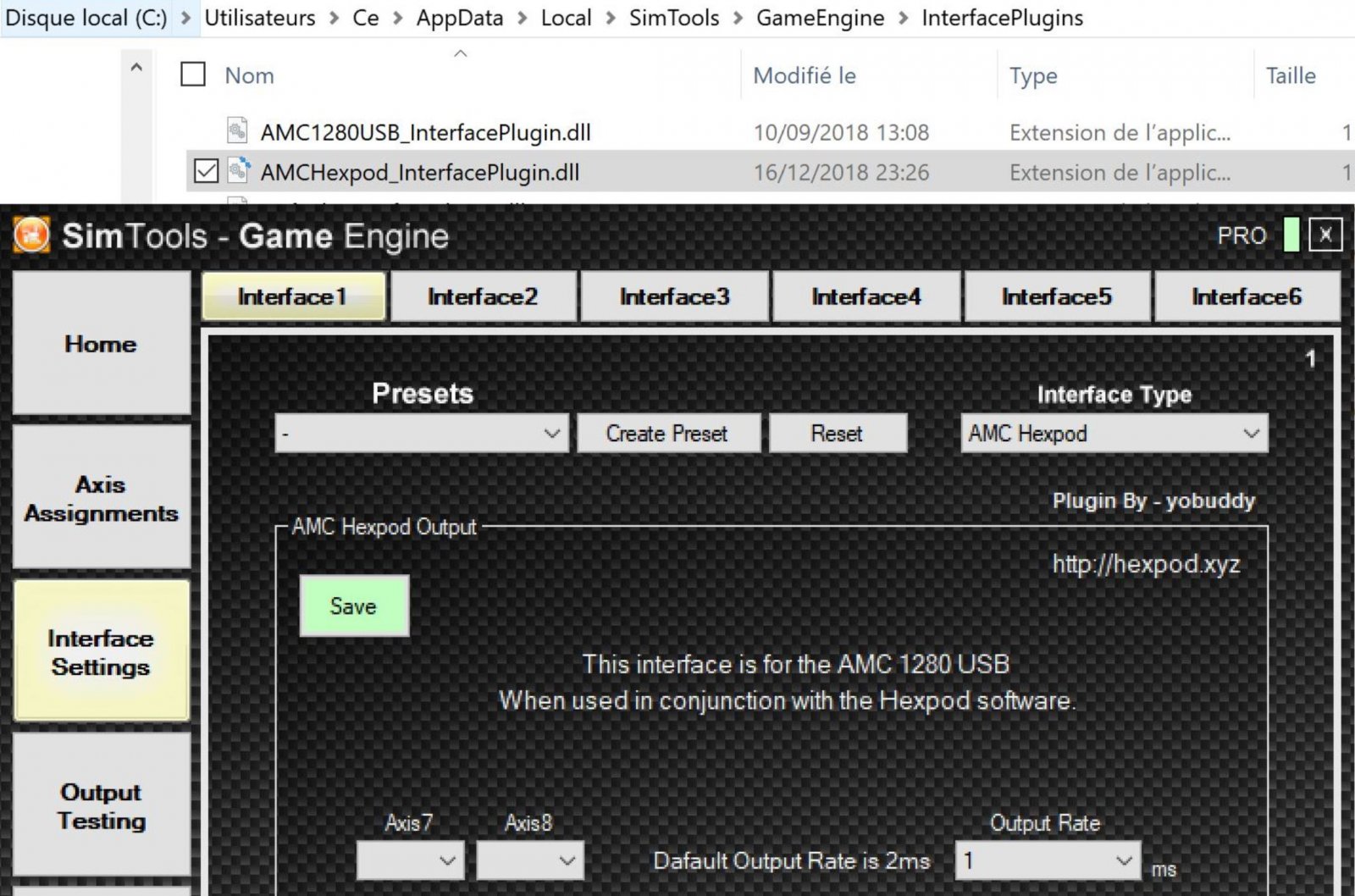

    1.)
    In the "Interface Type", select temporary another one.
    2.)
    When "Remove Saved Settings?" dialog shows, press yes.
    3.)
    Re-select heXpod, set 1ms delay and hit save.
    4.)
    Go to "Output Testing" hit the green button and select "(a) Axis Output"
    If the heXpod interface is properly installed the SimTools and heXpod sliders should be linked.

    It works correctly, but AMC1280USB board does not do anything :(

    Looks good than.
    To establish the communication between heXpod and the AMC I advise to activate your heXpod copy.

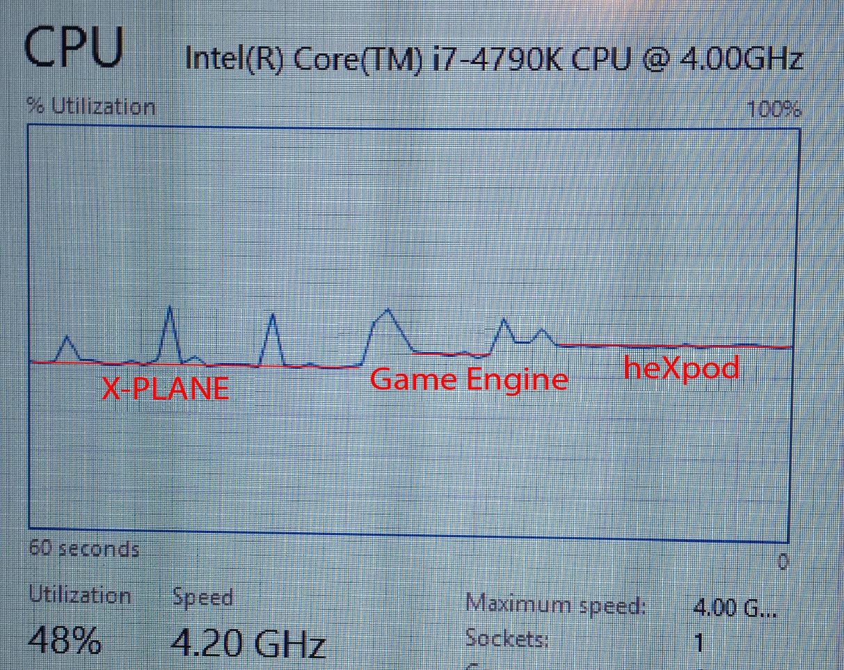

    Unless somebody brings a proof that splitting SimTools between two computers gives a substantial performance boost, I would advise to put everything on one single high-end machine.
    I understand the argument to tune on the fly the "Tuning Center" values, but it can also be done from a single PC setup using alt/tab key or just by putting the game in the windowed mode while fine tweaking you settings.
    I've experienced that heXpod kinematic calculations behaves better on a high-end machine and the amount of resources taken for this task is not so big to justify a separate computer. Another parameter which you could consider is the network latency resulting from a dual comp setup. Although I didn't tested it I can imagine that it could add an unwanted delay to the whole motion system.
    Personally I didn't experience any issues running everything on my 4 years old Win8.1, i7-4790k/1080Ti setup. Nowadays, if you're a rich man, you could consider a i9-9900k/2080Ti if the FPS rate is crucial for you.

    I just activated hexpod and everythings work. AMC works well too on firmware 3.5. Thank you very mutch!
    I dont know what wrong when simtools and AMC connected directly, but using with hexpod is a better way to configure my platform perfectly I think. Im appretiated. :)

    This is my proof , with all 4 SimTools apps running when in game and in full blow it can take more than 20% of the CPU which can affect gaming especially with VR CPU usage can hit 100% easily, I have now got a laptop running all the SimTools apps everything runs much better in high end games. I'm on a 6700k OC'd to 4.5ghz

    When I lounch the game engine and the heXpod driver (fully loaded), I see about 7 percent processor increase.
    For me, as I said, it doesint justify a second PC.
