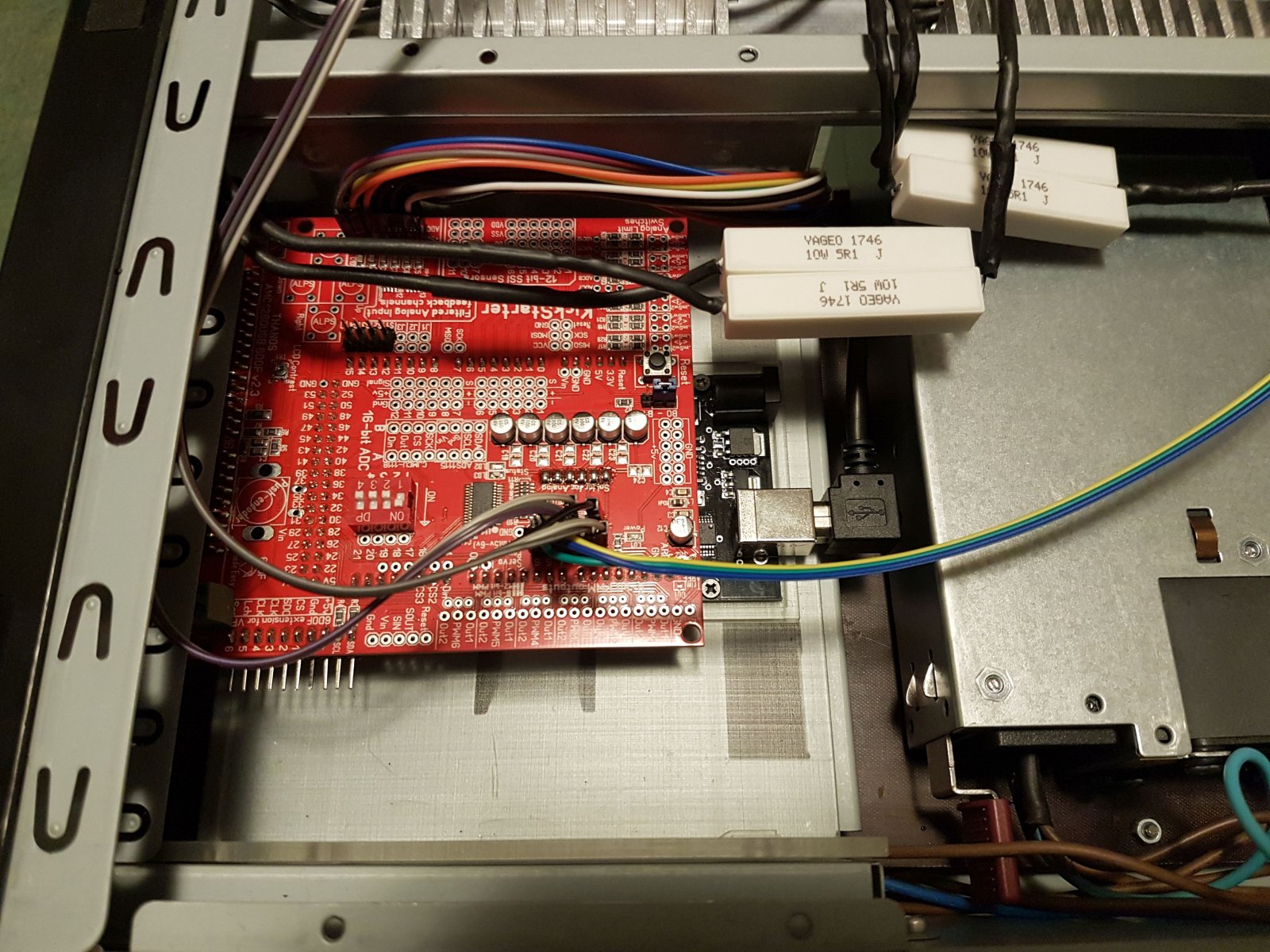

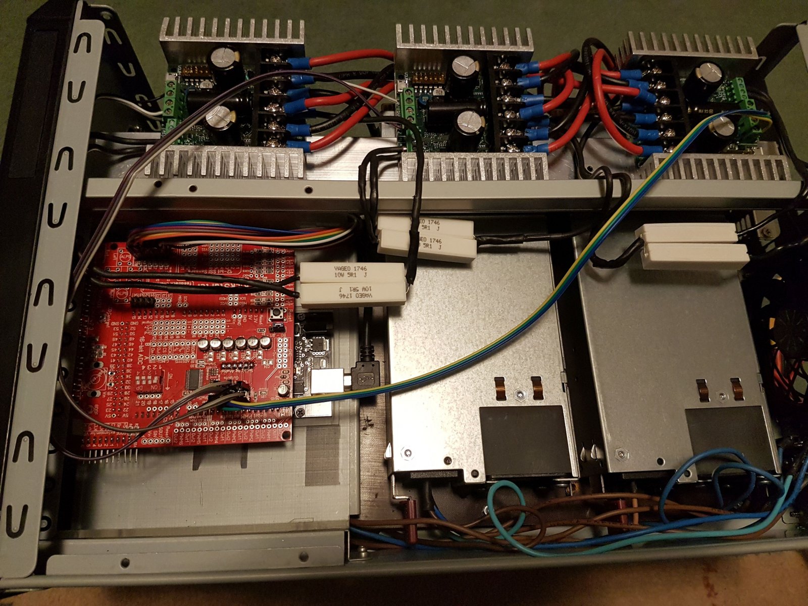

    Can you post a photo of your amc1280usb boards?
    Also tell me what settings you have in LCD menu... saying it doesn't work, does not help at all to find the conditions of your setup and reproduce it and fix it if needed.
    -number of motors DOF ?
    -Serial ID format? (make sure its set to FF FF and serial feedback off!!!)
    -input sensor type?
    -output mode type?
    Regarding the Serial ID format option, if wrong setting is chosen it may not connect to the motion software. See correct setting on video

    You sent AMC1280USB board about a week ago, I got it with firmware 3.0.
    - Im building a 6dof stewart platform with 6 24V DC motors and sabertooth 2x32 controllers
    - After updating firmware 3.5 I couldn't change Serial ID format, ...push the button but nothing happens. However it shows FF FF and ser feedback off would not work. I chosed "motion data only" for sabertooth, on firmware 3.0 rev2, it didn't work too.
    - input sensors are analog 10bit HAL effect feedback potmeters (type 6127V1A180L.5)
    - output type PWM 12-bit, SNS Uni-Dir
    After I roled back to 2.4 everything worked.

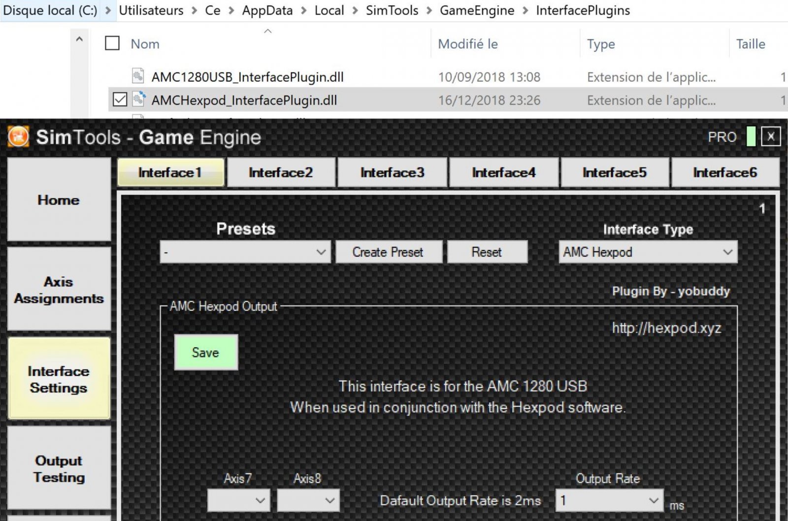

    With FW 3.5, make sure you've updated the simtools heXpod interface.

    Thanks for the vid.
    Ok, did you updated the interface?
