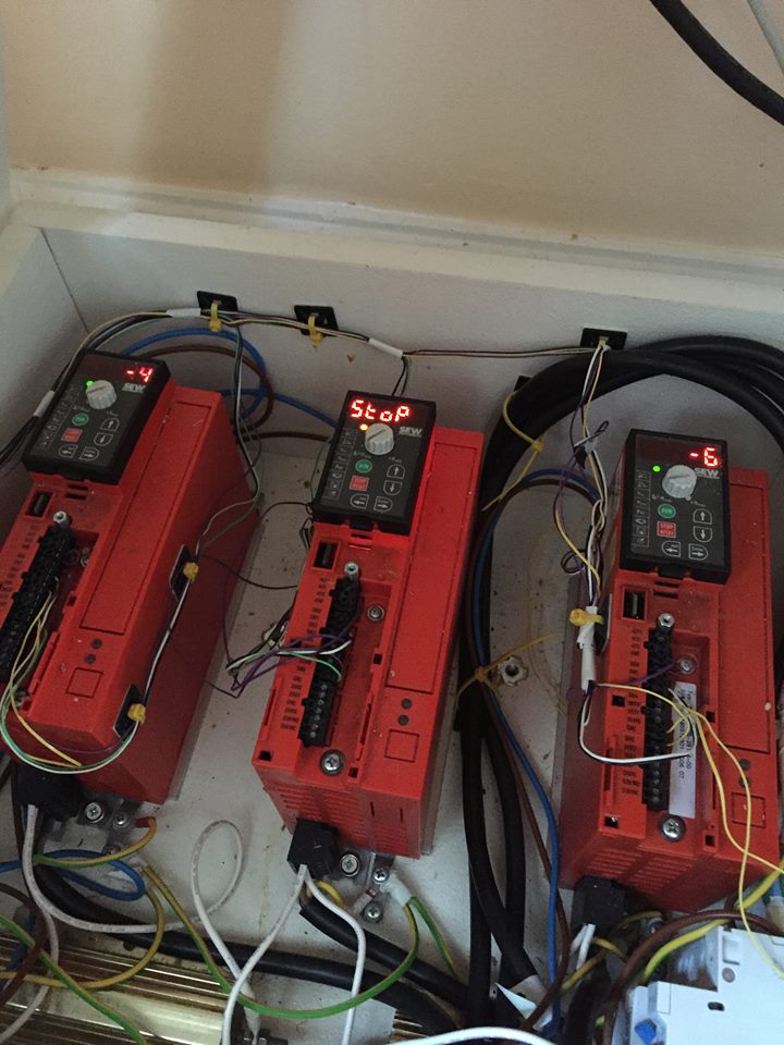

    I have gren thanos board 6dof all work nice in firewall 2.1c and last day am instal new update 3.0 and now have problem with one sew inverter B.all time light STOP. next two inverter work corect .i see in display change all time numbers and motor moving .only one inventer still light Stop and motor not move.
    PS: after back update to 2.0 all work correct. 3.0 not work for my.I will by fear to update to new versions.!!!
    PS2: after update 3.0 rev.2a to same problem back on 2.0 work correct

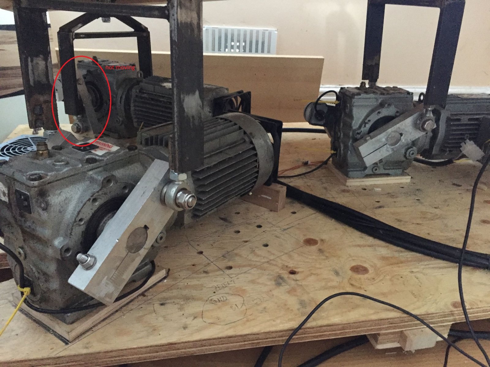

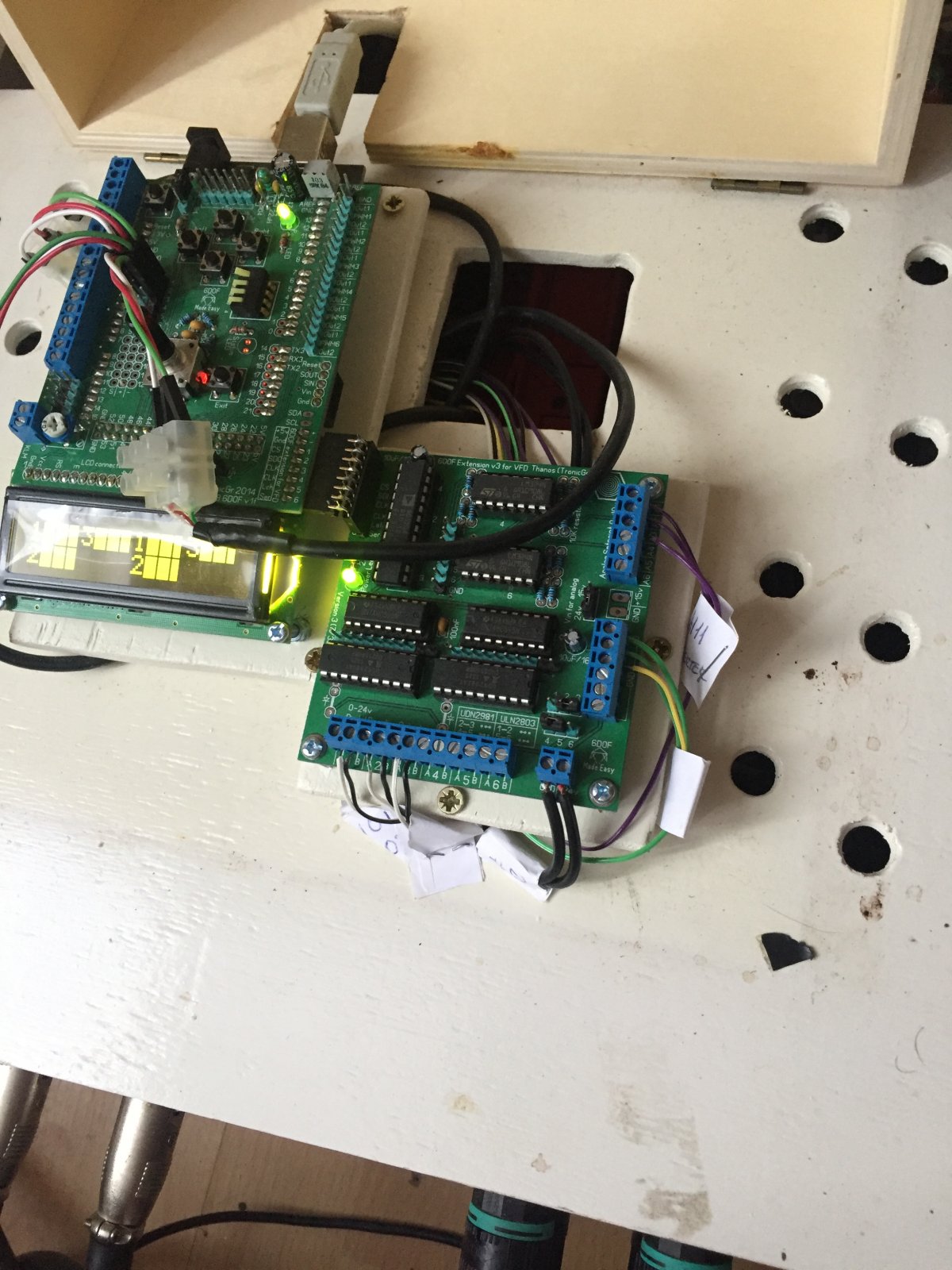

  6. misoswan
    misoswan Active Member
    Jun 27, 2014
    292
    1,038Coins
    +78 / 1 / -0
    3DOF, Arduino, JRK
    Hi
    to same problem .2.4 rev.3.....update 2.0 its work.
    I wrote badly 2.1c not work for my only 2.0
    42344862_307897656655645_4579109769524019200_n.jpg 42385559_248840449167816_7495418079908724736_n.jpg

    It's clear now your platform is a 3dof with 3 motors.
    Thanks for the photos

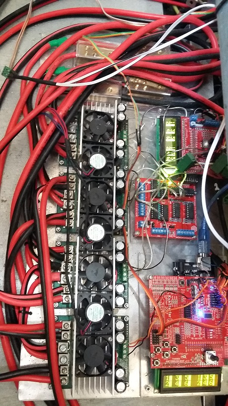

  11. SeatTime
    2,572
    +2,854 / 40 / -0
    Yep wrote down and checked all settings before startup as per normal and tried all the different revs. - picture of my setup below - driving a 6DOF and some G-systems. When I get some time will isolate the motors - easy as they are on a emergency control circuit and break out the test equipment to see what is going on. The kickstarter 1280 is happy to work properly on V2.4 and the older 1280 will only work up to 2.1c.

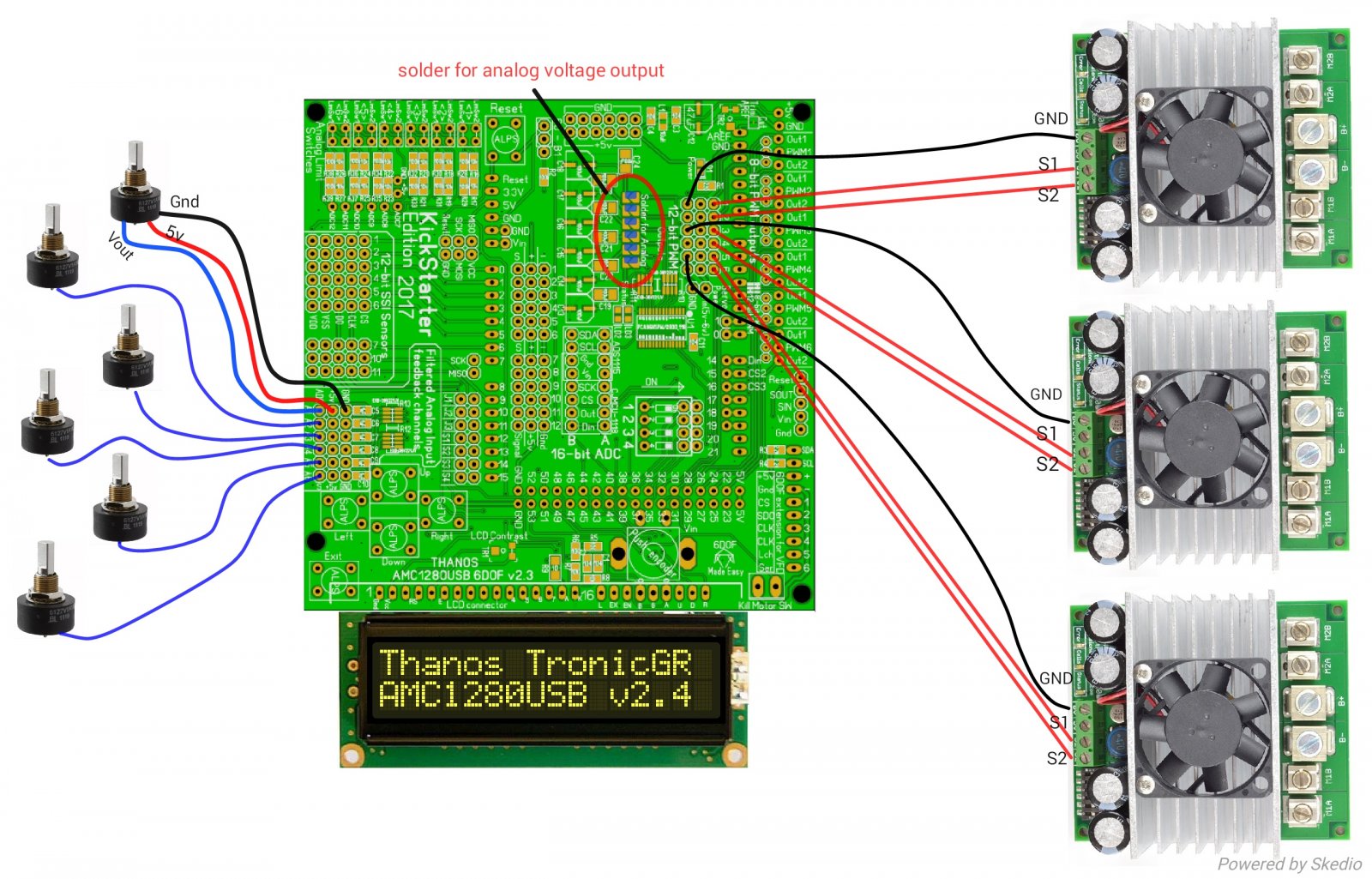

    Hi @Thanos - With the release of Simtools 2.3 - I think I need get this sorted out... So it is wired like above and I ran the test as below with version 1.7 rev2a : Auto scan works, but when using a pot it is stuck at a low voltage - never changes. Works fine on Version 2.4 Rev 7_
  19. SeatTime
    2,572
    +2,854 / 40 / -0
    Well... rolling back again to V2.4 Rev 7 so I can use the sim seems to have broken the 1280, - no voltages at all now to the Sabertooth - although the auto sweep works ? I will have to look to a new solution.
