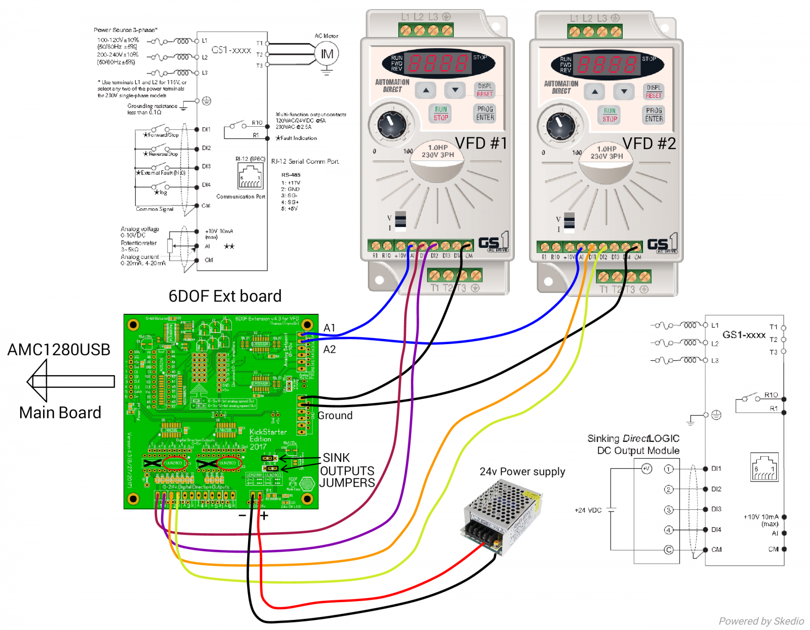

    Thanos posted:
    Hi Tom,
    I think you were waiting for this...
    I hope it's easy to follow, I had space only for two VFD inverters on the drawing, but I think it's easy to figure out the connections for the third VFD inverter. If you need connection diagram for the position sensors too, remind me what sensors you are using...
    Thanos
    Thanos, thank you for your diagram to hook up my AC platform. This is a lifesaver to me. I am using the #6127 Contactless Pots, 180 degrees.
    I know how to hook those to your board.
    1. I have been using a 12v transformer for the SMC3 Setup. Do I "have" to use a 24v or could it be a 15v - Just need to know this so I can order one.
    2. My final issues are programming the board values and how to use the rotary know and buttons.............This would be the icing on the cake.
    Thank you and have a blessed day.
    Tom

    Thanos,
    I understand your diagram, and thank you so much. But, as BlazinH has pointed out, I now "do not know" what power supply I need ???? / nor / how to program with the buttons-knob, and what values I need to start with. I have a 400# top platform that will kill me IF I don't understand what and how to program.

    Hi Tom,
    You will need a 24v PSU. First because the amplifiers need at least 14v to provide full range without skewing, second the LOW level signal has to be at least 13.5v to register into the sink inputs of GS1. Using 24v psu is prefered as the LOW level signal will be same at 24v and won't try to leak voltage to the 6DOF ext board.
    The sink inputs work as:
    HIGH LEVEL SIGNAL (ON) = 0v
    LOW LEVEL SIGNAL (OFF) = 24v
    If not connected it's floating potential.
    You can use any 24v PSU, that is rated at least for 1A. Something like this would work great:
    "110V/220V AC to DC 24V 1A 24W Switch Power Supply Driver,Power Transformer"
    I sent you the controller already all setup for your inverters, if anything you may have to adjust the PID values a little bit to match the gear reduction you have on your motors.
    Navigating the LCD menu is easy, rotate the encoder to scroll through the options and push in the encoder to enter to sub menu or save parameters.
    Check out some of my videos that show how navigate the menu. Here is one for example:
    After minute 11:30...

    Not having time for this anymore, you still don't know what you are talking about. His VFD inverters will work as in the schematic i gave him. The generic one on the old manual works with most but not all vfd inverters with sink inputs.
    Please stop confusing people.

    I'm confusing people? You got to be kidding. Your the one who told him to hook it up using the old manual a month ago, not me. Its your old manual that says when using sink outputs like he is to use 15 volts, not me. This is the first we've heard of that you need to use 24 volts now with your latest extension board because you haven't provided a manual for it either. I'm done with you too because this is just getting ridiculous.
    But before I go, you did say the diagram was OVER-SIMPLIFIED but with what you showed there would be no real advantage in using 16 bit Simtools input when everything else is only 12 bit at most as you know.
    I know. That's the only reason I supported your efforts in the first place since nobody else really needs it. There are other and better options for them.

    Please stop talking if you don't know what are you talking about. You are getting aggressive and not thinking rational, while I'm trying to provide some support to people need it here, and you are taking up my 1 hour a day I have available for that, explaining to you what YOU don't need to know in first place. And on top of that you misleading people that the AMC1280USB is not working at all and they get the feeling that it will EXPLODE if they connect it to anything.
    I perfectly explained that both connection diagrams are completely correct, and explained why his GS1 VFD inverter will work better using a 24v since he owns only a 12v PSU that is not enough to power even the amplifiers that need minimum 14v (hence the 15v requirement in old manual).
    The resolution of the motion of a actuator is as good the sensor resolution it had coupled on it. If you couple a analog sensor with 10-bit resolution you will get 1024 positions.
    If you couple a 16-bit resolution sensor you will get 65535 position for same actuator.
    Don't confuse it with the 12-bit output which is speed indicator not absolute position!!!!
    Have a good day.

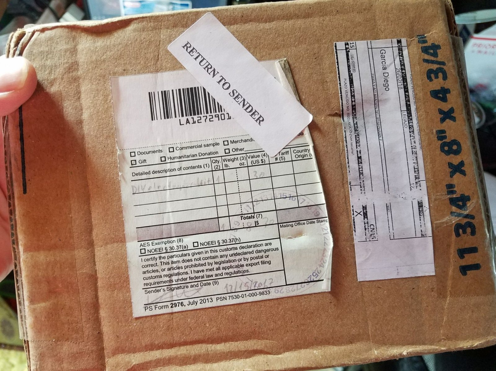

    Well, finally, lost us80, as the controller was held in customs and sent it back because the seller @Thanos sent it without a price... :mad:

    Yes, It came back but there was not such explanation on it, just a note that it was not claimed. The price was declared correctly on the customs form and even less that what is actually.
    I'll send it again, just let me know what exactly they need from customs, I have shipped to all over the world same way, didn't had this issue.

    Hi all, about customs; AU. customs must be OK as my 1280 had NO price and they let it through:)

    If you mean the paper slip, no. I don't include this with kickstarter rewards, because its exactly that, a reward, not commercial item :)
    But there is declared price on the packaging (customs form). The contents are declared as gift (gift=reward=the same), so it should have no duties due either.
