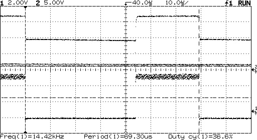

    I am glad you guys are building it too! On my prototype I have removed the small resistors to the IR2110 High and Low inputs, just to let you know. I also added the LED's for direction as you can see. Once I finalize the circuit I will update the schematic accordingly.
    I didn't have time to take proper measurements of the top mosfets' Vgs, I can only use the scope with reference to ground. Trying to measure Vgs for the top will short the source right to ground. Pretty sparks, but they're not worth it! :D
    The bottom PWM signal has noise on the high level which needs to be investigated. It might have been the circuit or some other source.
    Vgate is not a good representation of Vgs because it is referenced to ground and not the source, therefore voltage levels are not relevant.

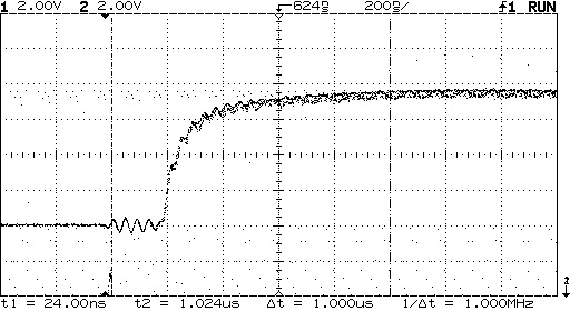

    Gate voltage zoomed in to measure rise-time. Again, voltage levels are not relevant, the small ripple before the rise needs further investigation.
    So far I am happy with the results, the turn-on time looks pretty good, but I will not jump into any conclusion until I take proper measurements.

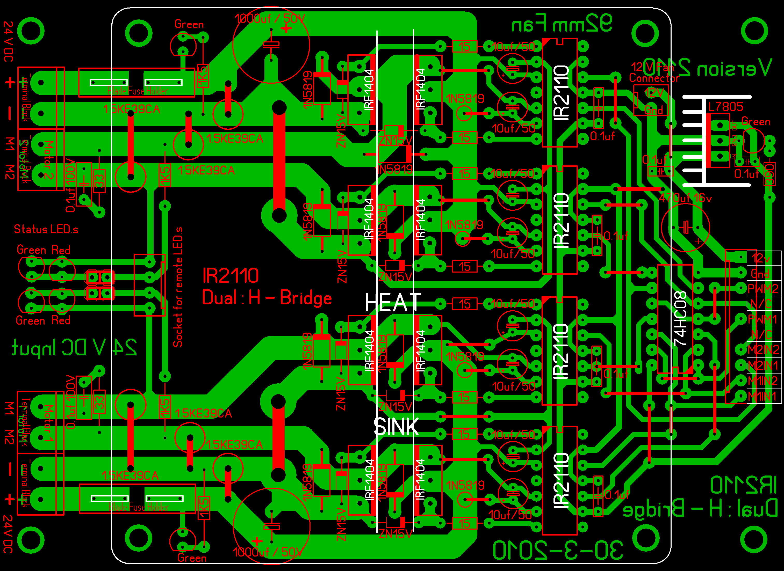

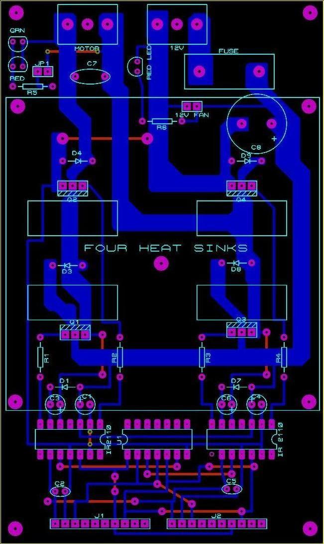

  11. Senetor
    Senetor Member
    Oct 23, 2008
    90
    Australia
    595Coins

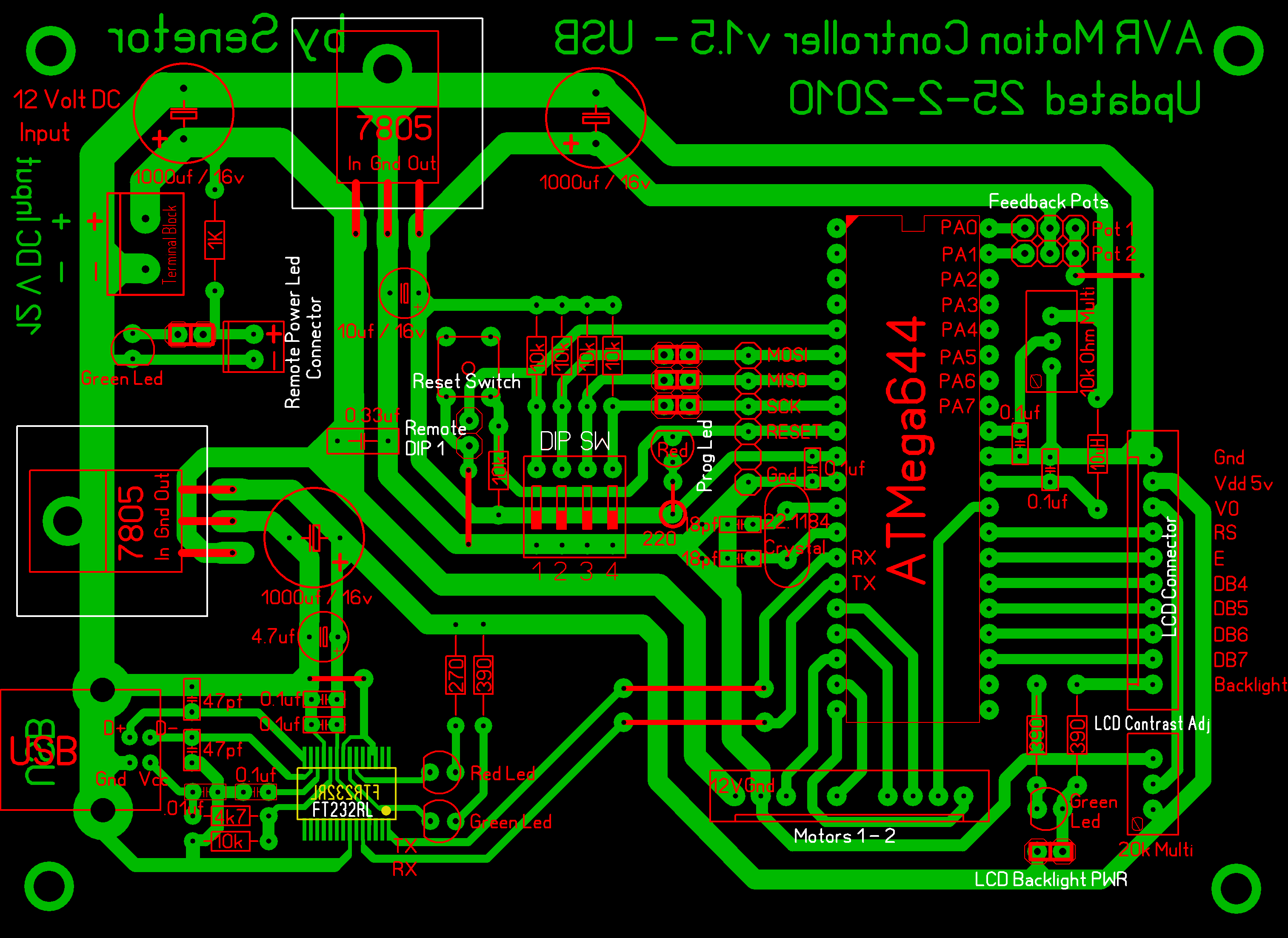

    Frakk
    Here is my version of the IR2110 Dual H-Bridge.
    And the AMC USB Controller that goes with it.
    Senetor.
  12. Frakk
    Frakk Active Member
    Apr 15, 2009
    1,144
    328Coins
    Good job! Although I have a different vision of the circuit, this a very good version. The thick PCB traces will handle about 10A continuous which is enough for most people. You should post the AMC circuit in its thread too! Do you plan on building them?
    Everyone please note that the H-Bridge is still under testing and there will be changes to the schematic.

  14. Frakk
    Frakk Active Member
    Apr 15, 2009
    1,144
    328Coins
    The driver won't work with 5Vcc. You can connect 5V to the digital side Vdd and Vss and have 5V inputs, but the driver side needs at least 10V I believe.
    Senator, I noticed the PCB is for 24V and you included 15V zeners across gate-source. This will not work. Zeners will blow in seconds after you start driving the gate with 24V. Also consider that 2 fully charged batteries will be about 27-28V. The IR2110 has an absolute maximum Vcc of 25V as per the datasheet.
    As of now, the circuit will work up to 20V (Mosfet Vgs limitation) without the gate-source zeners. Anything above 20V will damage the transistors and blow the zeners. Anything above 25V could damage the IR2110's.
    I will continue testing and make sure the circuit is bulletproof with 2 car batteries.

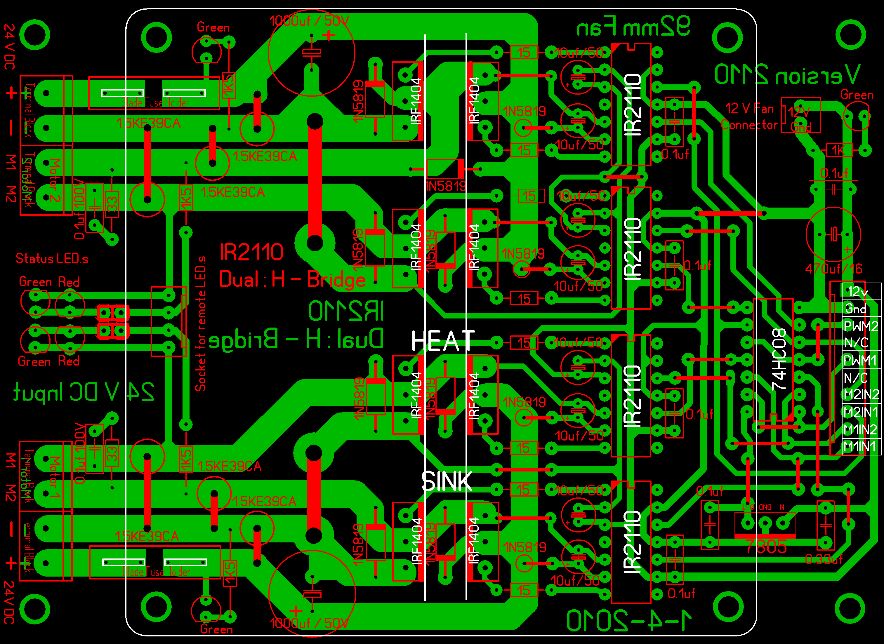

  15. Senetor
    Senetor Member
    Oct 23, 2008
    90
    Australia
    595Coins
    Frakk, I have powered the IR2110's with 12V and removed the zeners.
    Senetor.
  16. pathetic
    pathetic Member
    Jul 5, 2009
    62
    - 38Coins

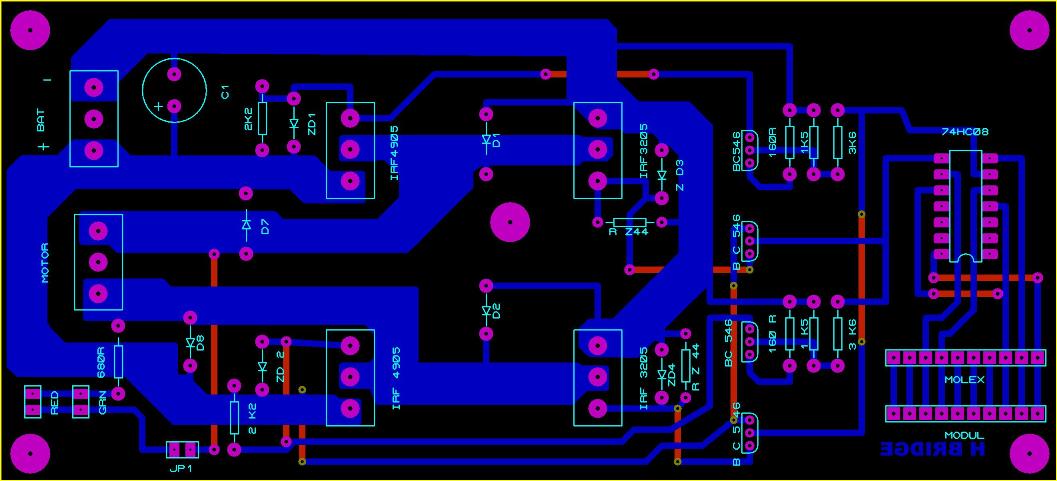

    I ve draw two pcbs for my hbridge. First is based on Frakk's schematic and the other is mono hbridge version of tronic's.
    I've not used them yet. I will add infos after testing.
