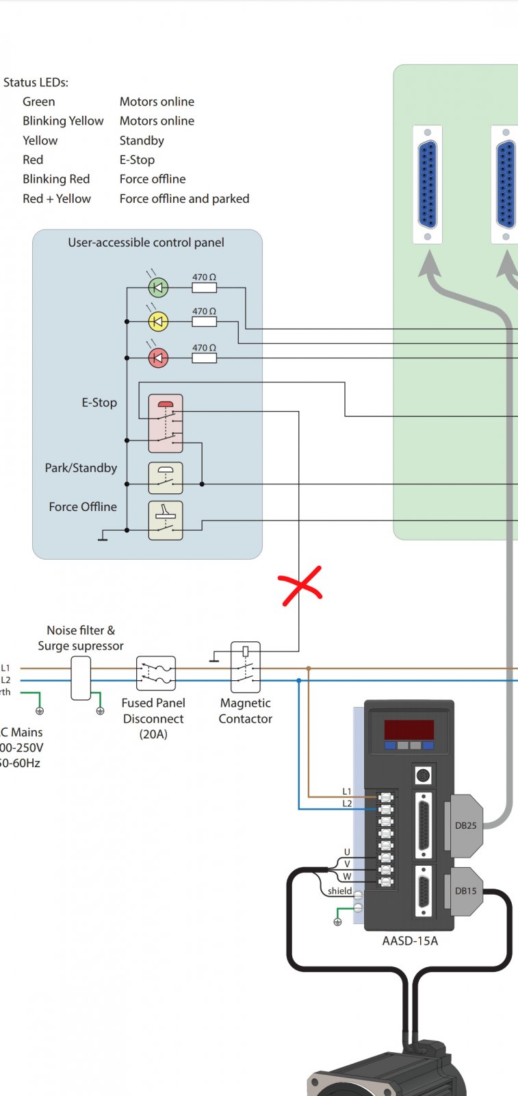

  14. ADNSV
    ADNSV Alex Denisov Gold Contributor
    Aug 7, 2020
    Windsor, Ontario, Canada
    86Coins
    Hi Thanos,
    Can you please have a quick look at the electrical wiring (in the attachment). Just want to know if I'm missing something.
    Thanks,
    Alex
  15. Thanos
    Jul 6, 2017
    1,379
    Electronics Engineer
    United States
    2,917Coins
    +1,079 / 10 / -0
    You cannot wire the power magnetic contactor on the KLM switch... The e-stop is for the controller to stop the signals to the servos.
    You would need separate switch for the mains power contactor to the servos. Plus I don't know how much current the magnetic contactor relay needs and might overload the USB port...
  16. ADNSV
    Aug 7, 2020
    86Coins
    Thanks, yes you are right, those 5V coming from USB through your board would not be enough. I guess, a little 24V psu with a solid stay relay can fix that. I was already using a double-pole e-stop button so the circuits are separate. It's a bit weird to have one NO and one NC in it, but IIRC, most of modular dual-pole e-stop switches would accept NC/NO/dual-throw modules. The updated drawing is attached.
  17. Thanos
    Jul 6, 2017
    1,379
    United States
    2,917Coins
    +1,079 / 10 / -0
    Sure, it will work this way, but you don't really need to disconnect the servo power using the e-stop... A separate switch to power on-off the servos is enough.
