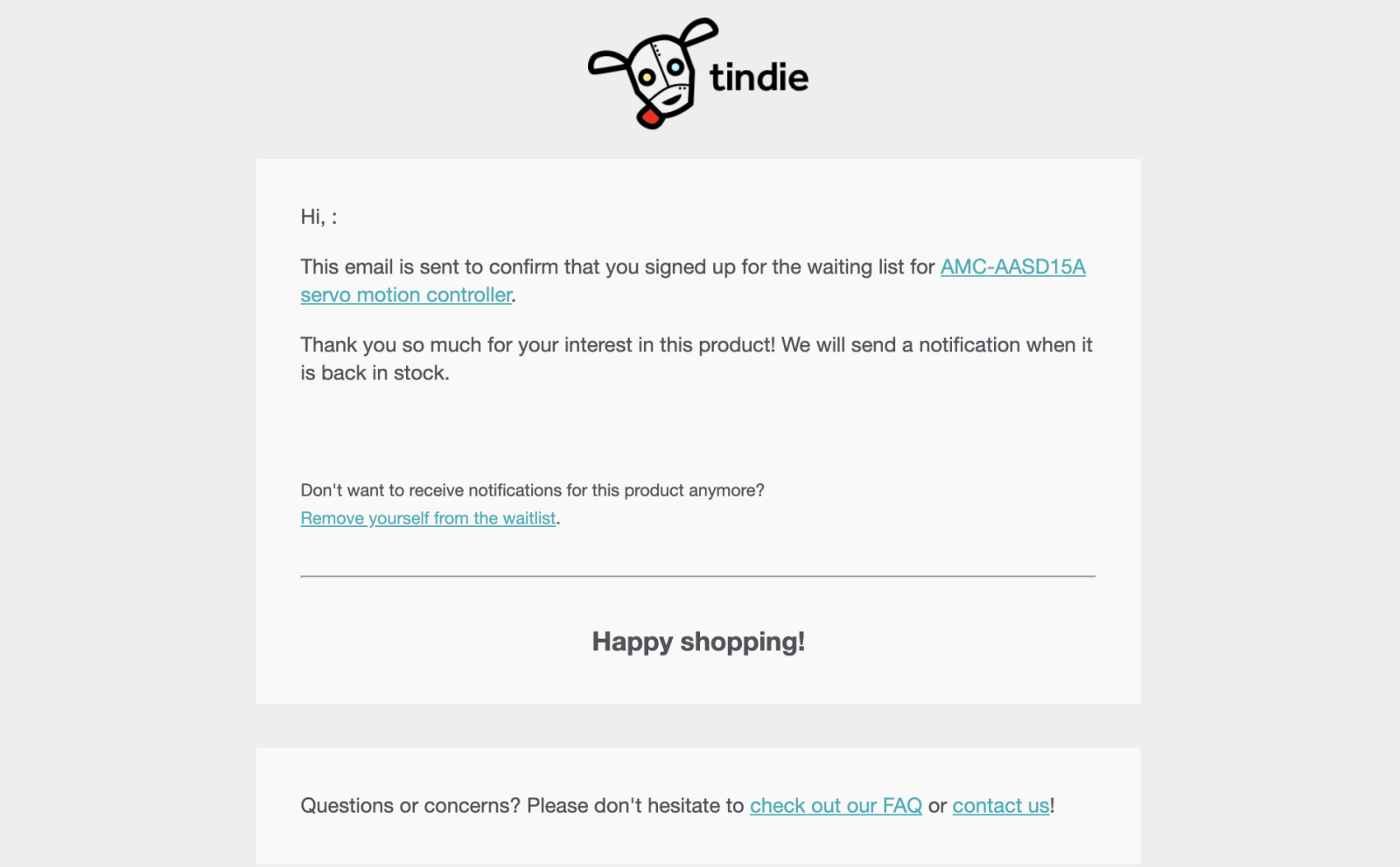

    I should be on the waiting list i signed up over a month ago ? Let me see if i can find the email.

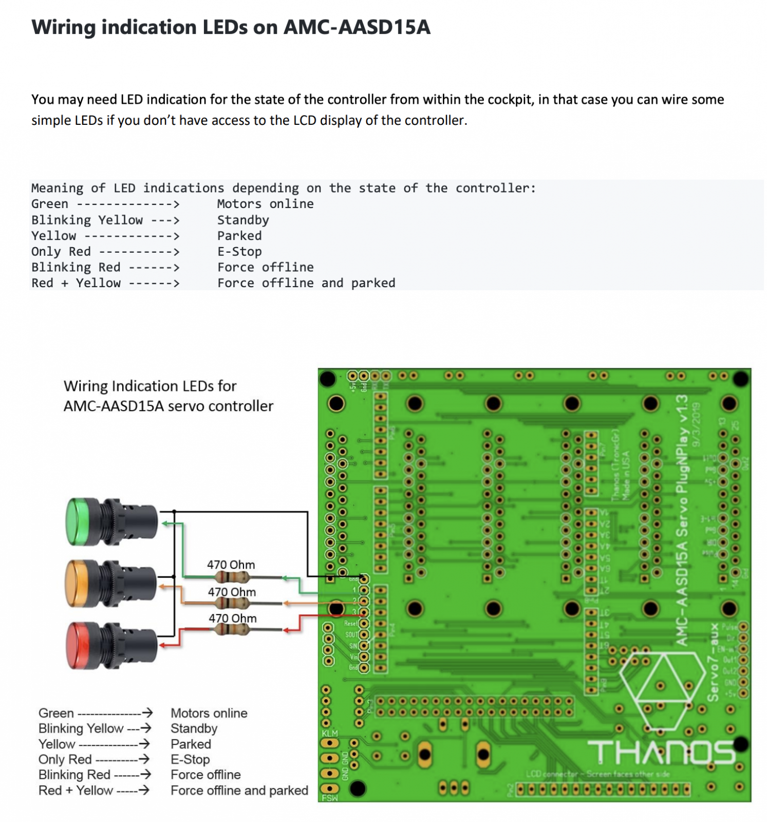

    guys, quick question as i haven't found an answer in the manual (i believe it's worth adding):
    what kind of LEDs can be connected to the controller? i have DC 12v ones, will they fit or will i smoke something? i understand it's powered by USB so 5v only...

    hiya @pooh thanos will give proper explanation , but i think youll find that these are low powered 5Vdc led's as the current supplied via usb to amc AASdDboard is limited, the other option is to use relays and seperate power supply where the control signals from the AMC are used to triger the relevant releay/ Light option ...thier is a Wiring diagram showing this on his Githun ...i dont have link at moment but suspect it will be the same place you got the diagram you posted .... Wiat for Thanos to give you proper advice though :)

    No you can't use 12v leds connected directly on the AMC-AASD15A controller only 5v leds (or 3v leds with 470ohm resistors), but perhaps you can use some drivers if you absolutely need to use 12v leds. See this diagram:
