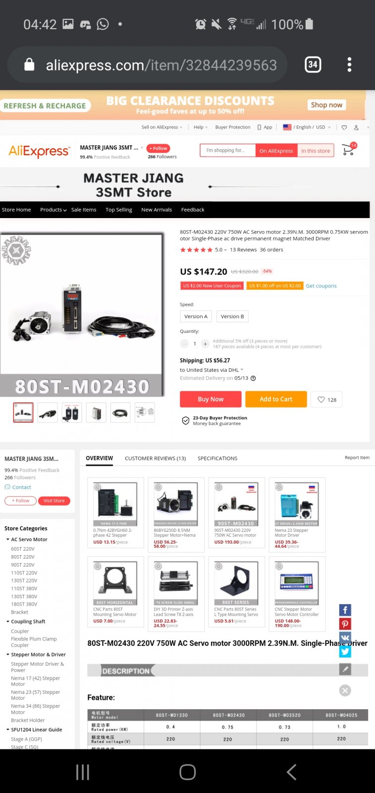

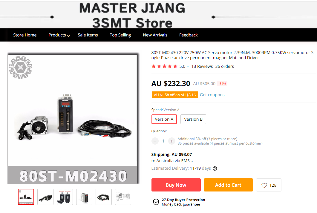

    How about this one?
    https://www.aliexpress.com/item/32844239563.html

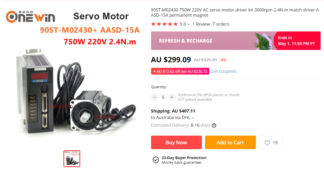

    Thanks for that! The thrill of the hunt!
    I just found that one too as you posted it. Its currently in my shopping cart.
    They are doing something weird with shipping rates and its only economical if buying one at a time.
    I was about to post it but thought I might be pushing my welcome by spamming your thread with shopping finds.
    I cant help myself to keep going back for another look.
    But thats it, no more looking, thats as good as its going to get, Im pulling the trigger 6 times.
    Total x6 price is down to AUD$1952 inc delivery + tax

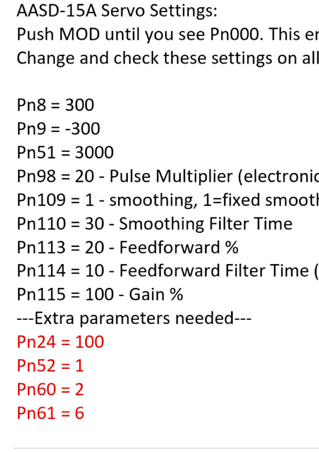

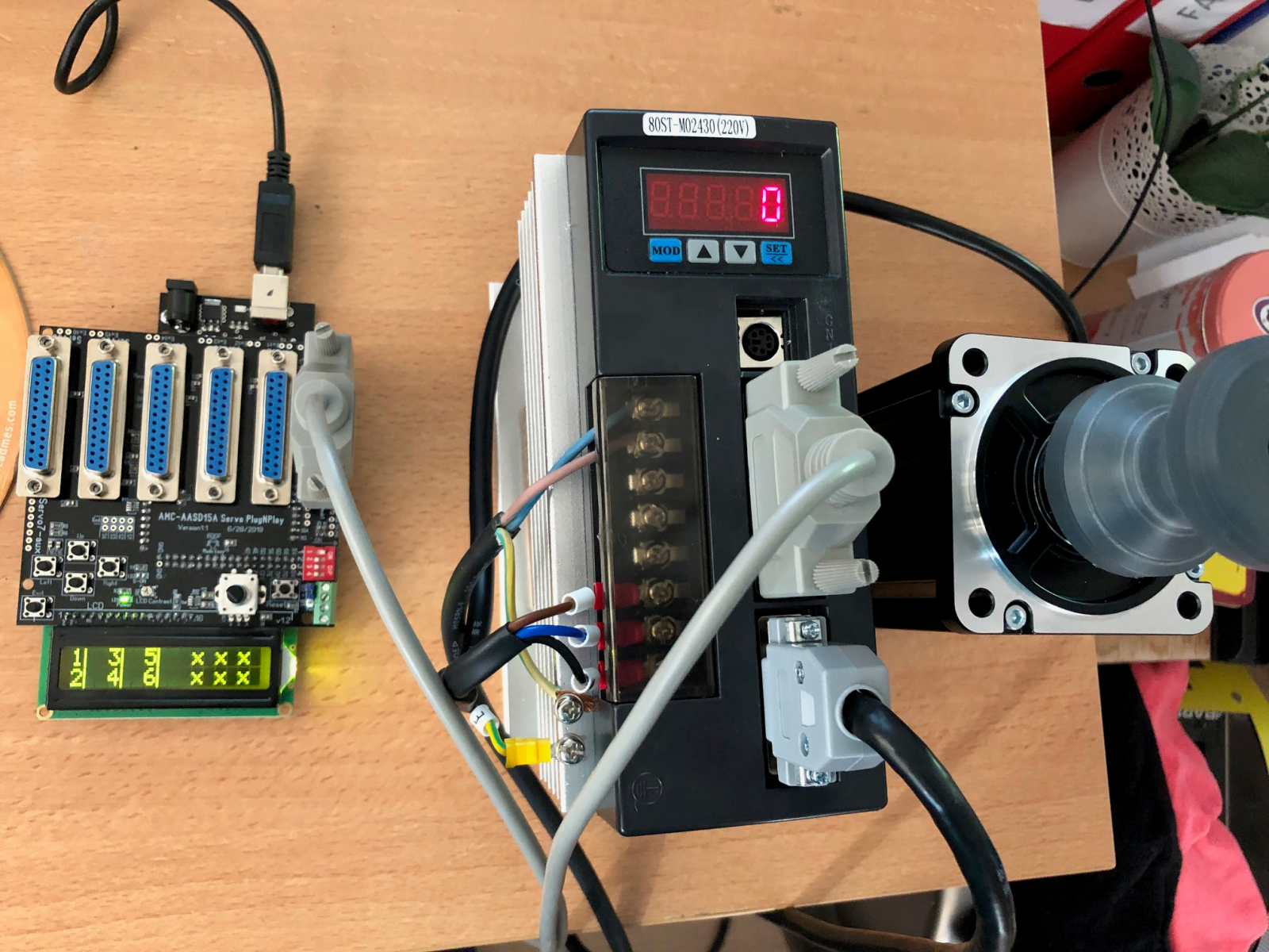

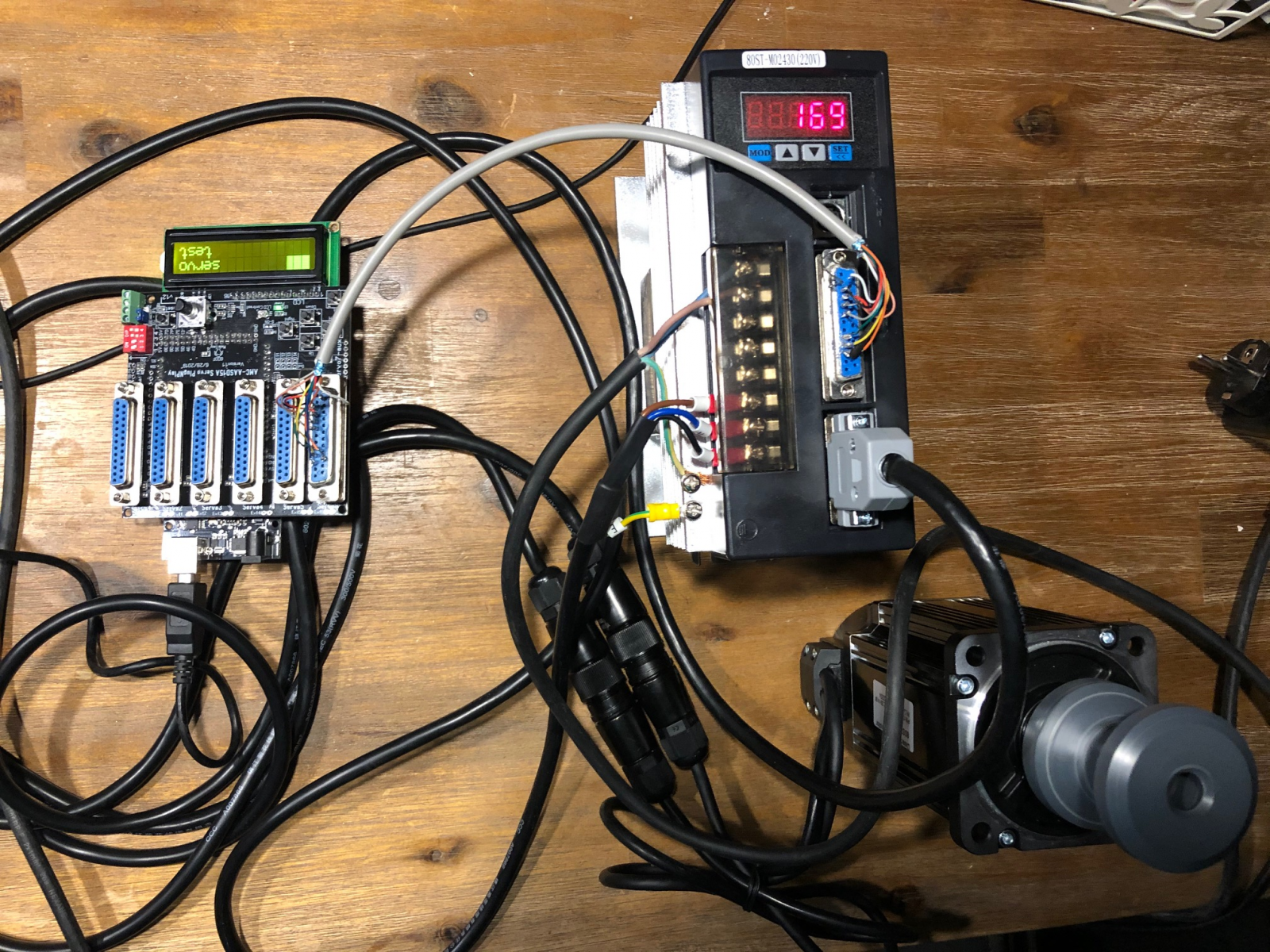

    Have the @Thanos controller here. Reluctant to post as I feel quite stupid: cant get the motor to calibrate and move at all with the controller. What I did:
    • Read the manual back and forth multiple times
    • installed the latest firmware v2.09 according to video
    • Put all the settings according to the manual 2.3
    • Jumper is in the right position (up)
    • dipswitches also ok
    • (next to the usb is a power connector. No mentioning of this in the manual, nothing connected in pictures/video's so I guess not needed)
    • no emergency stop or something connected
    • Settings into the servodrive according to manual: its the EXACT same type as recommended from the exact supplier.
    • Motor turns when using "jog" so the drive&motor seem ok
    • When turning the motor by hand it shows values on drive display (speed? Pulses?)
    • The thanos controller is recognized by mover software, and thanos controller shows "motors online receiving data"
    But when switching them on there is no homing, and no reaction to up-down-left-right buttons.
    What I did to try to get it to work:
    • Switched both off- on again, tried different switch on sequences.
    • pressed reset button on thanos
    • tried all other servo ports
    • tried other 25 pin data cable
    • Reset both to factory settings and tried without setting anything
    • Input servodrive settings again according to manual
    • input thanos settings again according to manual
    In all cases: zip nada rien. Pointers really appreciated, maybe I'm missing something obvious. I hope so.....

    Just a shot, did you set all parameters, including the extra ones in red color?

    Hey Thanos, thanks for your reply. It was the d-sub25 data cable.... Really weird pin assignment, not 1-1 and not modem. Made a test cable to check and that works fine! So now hunting for the right data cable. Local computershop has never heard of it :)
