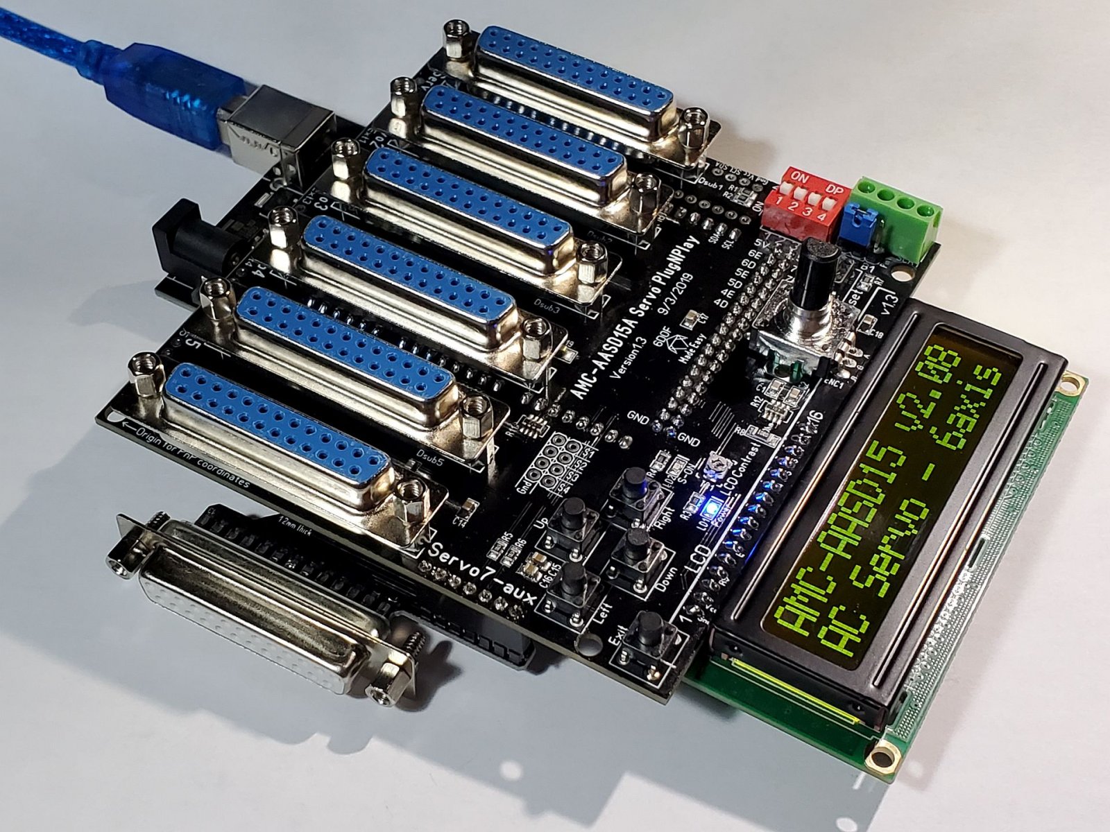

    Hi everybody. Its time to update the firmware of your AMC-AASD15A!!
    There are other things that wanted to add, but this update was long due now so I released the most important features for now:
    -Additional functionality on E-Stop and Force Offline inputs.
    -Addition of calculations for easy use with Gearbox reduction rotary actuators.
    Download the firmware file and the bootloader utility and unzip them. You can watch this video if you haven't updated the firmware before: Firmware update procedure for AMC-AASD15A
    https://github.com/tronicgr/AMC-AASD15A-Firmware/tree/master/Latest_firmware
    Here is the list of changes for the new firmware v2.08:
    ======= enc_6dof_AMC_AASD15A_v2_08 =======
    release date: 01/22/2020:
    -Added option for KLM input (e-stop) to either HOLD powered position or Kill power to the Motors
    -Added option for FSW input (Force offline) to either Always Park or let user use park/standby button.
    -Added Actuator type selection for Linear or Rotary type (gearbox reduction). The menus are showing new options fit for describing the gearbox like reduction Ratio, Steps of the motor and output Angle range as well the CW or CCW direction of the motor.
    example calculation for gearbox:
    (500pulses / 360 ) * 180degrees = 250 Pulses
    250Pulses * (50:1 Reduction) = 12500 Pulses
    *keep in mind that the max pulses buffer that AMC-AASD15A can use is 65535!
    Thanos

    The AMC-AASD15A will be available now with Servo7-aux connector included, on the little PCB board already soldered, ready to plug and mount on the 3D printed enclosure.

  10. Mark Pattison
    Mark Pattison New Member
    Nov 26, 2019
    19
    Engineer
    Michigan
    267Coins
    +9 / 0 / -0
    Can we still order just the 7th aux servo connection for those of us who don't have it yet, but would like to add it for potential growth options in the future?
  11. Thanos
    Jul 6, 2017
    1,380
    Electronics Engineer
    United States
    2,925Coins
    +1,080 / 10 / -0
    I may add a separate product on Tindie for it assembled, but otherwise you may order the PCB made and solder a DB25 female connector and male-female 2.54mm pitch headers yourself to it:
    https://oshpark.com/shared_projects/pSGlJpx4
    Thanos

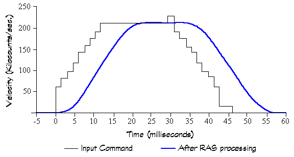

    Here is the results of using the new rolling average filter on a large Closed-Loop stepper motor (Nema34). It definately inproves the quality of motion!!! Note these closed loop steppers can reach up to 3000RPM, have lots of rotor inertia and without proper acceleration-deceleration slopes, they overshoot too much !!!!!
    These closed loop stepper motors, are hybrid servo motors, meaning to be used as constant speed (pulse rate) and have NO proper PID control so they lack acceleration-deceleration properties and pulse signal smoothing. Still much more noisy in my opinion that the real servomotor solutions.

  16. Mark Pattison
    Nov 26, 2019
    19
    Engineer
    Michigan
    267Coins
    +9 / 0 / -0
    No way... Is this similar to what ClearPath calls their "RAS" (Regressive Auto Spline)?
    If so...
    AWESOME AWESOME AWESOME SAUCE ! ! !
  17. Thanos
    Jul 6, 2017
    1,380
    United States
    2,925Coins
    +1,080 / 10 / -0
    That is exactly what it is... it corrects the S-curve response of the motor, injecting pulses in the process!
