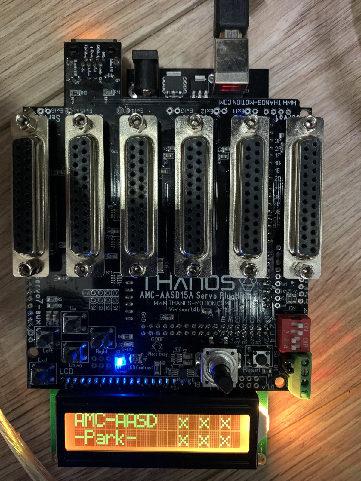

    Hi @Thanos I'm building a gseat and I have a calibration problem with an actuator. I also have a 3dof platform with 3 actuators that work well, no calibration problem. I selected 3dof+tl+surge from the menu. The actuator that causes me problems is on output 4 of the AMC. The actuator works well except that when I cut the power supply (120v.) and reconnect the actuator it only turns 3 turns in one direction (without calibrating). On the other hand, if I connect it to output 5 of the AMC, it works correctly, it calibrates and go back in its place.

    Have you updated the firmware to the latest version v2.26 fix0?
    I just tried to replicate the issue, but all works as intended. Powering off and the powering back on the servo on DB25 port 4, fully retracts the actuator to calibrate and then moves to 50% parking position correctly (3dof+tl+surge setting). Did you try with another DB25 cable in case the one you are using is damaged?
    Also make sure to restore defaults in case some other setting you did causes conflict on the park function. After loading the new firmware, hold down the 'EXIT' button on the Thanos controller. While continuing to hold down the 'EXIT' button, press and release the "RESET" button to restore the default parameters. Now release the 'EXIT' button. This is needed to remove any incorrectly stored values from the epprom from the previous firmware as sometimes these get updated too. (Click here for video).

    Hi, sorry for the delay , i was away for works.
    Today I connected a fifth motor and the problem moved to output #5 and now #4 works fine.
    What I suspect... It is as if a virtual calibration switch closes as soon as I turn on the power and so the motor moves immediately by 50%.
    Later in the day I replaced my AMC board with my Flight sim board and everything works fine as expected. Then the problem comes from the AMC board themself.
    I will try it again later by re-installing the firmware.

    Maybe your actuators leadscrew slider have resistance and needs lubrication. I'd suggest to check if you can rotate the leadscrew by hand without resistance.
    And check if the DB25 male-male cables are shielded type. EMI could cause false signals during the calibration if not. Although the AMC-AASD15A controller ignores torque signals when not in calibration mode, an EMI spike could send a wrong pulse and calibrate prematurely.

    I removed the engine, it is free.
    I tried with an other DB25 cable but nothing.
    Like i said everything works well with my other AMC board.
    I downloaded again the latest firmware .
    I'm pretty sure the problem is with the AMC board. I took the board alone and a single motor, I connect the DB25 cable alternately on each output 1-6 and at each output I see the "C" for calibration before the "P" of the park except at the output 5 that i see immeditely the "P" .
    i restored it severals times , i selected "all axis parked" to be sure. I am run out of idea.

    Some photos of the AMC-AASD15A so I can see its version and manufactured date, would help.
    The issue you described could be defect on the PCB, or just dirt deposit interacting with solder paste residue that maybe was not well cleaned during production.
    If anything, you can always send us privately photos or provide more information that could help assist more, with possible repair or replacement if needed. Use our contact form here.
