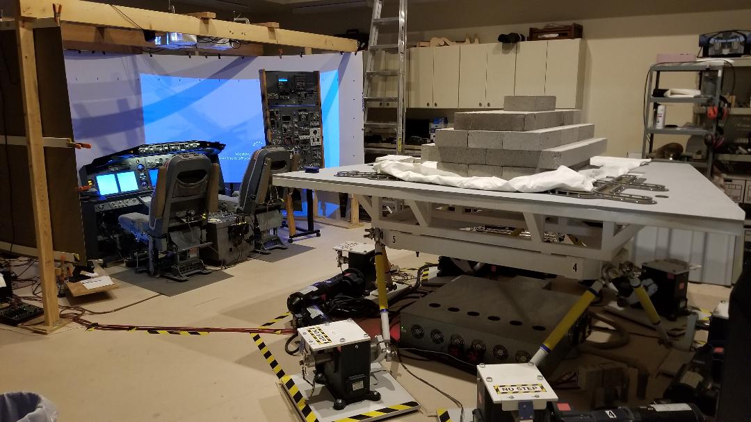

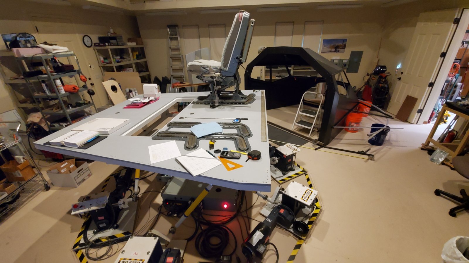

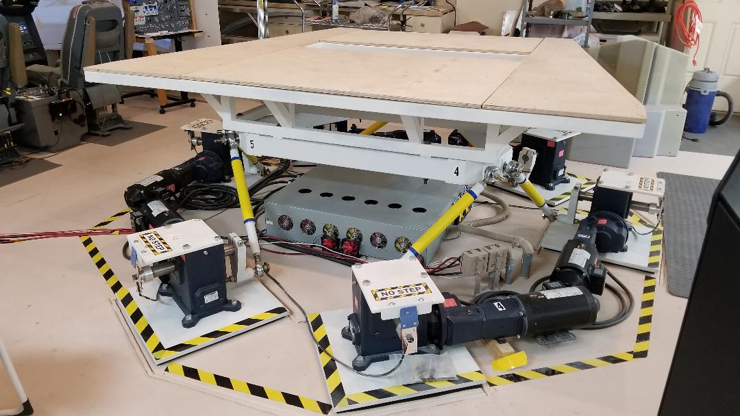

    Hi Mike,
    Here, I'll add some photos and video for you...

  3. sagrada737
    sagrada737 New Member
    Dec 1, 2019
    9
    Retired from the computer industry
    Las Cruces, New Mexico USA
    247Coins
    +13 / 0 / -0
    Thank you for the clarification on adding Photo files directly from my computer.

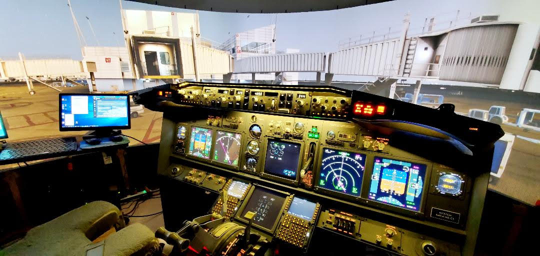

    +13 / 0 / -0
    Yes... Some of them to give folks an idea of what my 6dof Motion Platform looks like. Thanos posted them for me to help get me started on the Forum.

    +2,854 / 40 / -0
    I remember watching videos of you building/testing this 6DOF platform many years ago. To a engineer, a thing of beauty :thumbs. Have to admire the old tech :) TIC.

    +2,746 / 18 / -0
    The cockpit is a work of art!

    +1,080 / 10 / -0
    It is... wait for the cabin to go on top of the platform...

    Normally you would need a gearbox attached on the servomotor right? You can place the limit switch on the arm travel path of the output of the gearbox. So the motor itself will perform multiple turns, especially if you use large ration like 50:1 or 80:1.
    Check the 6DOF platform here with rotary actuators. It actually not even using limit switches, just a hard stop in the path of the arm of the actuator:
