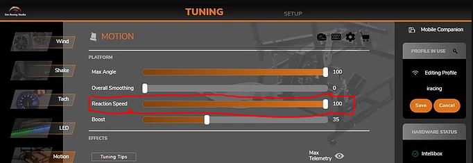

  10. JerryS
    JerryS New Member Gold Contributor
    Jul 28, 2020
    6
    - 58Coins
    2DOF, 3DOF, AC motor, Motion platform, 4DOF
    Hi Thanos,
    I really like the Sim Racing Studio - it is easy to use :) I'm just wondering if you will ever add the Reaction Speed setting feature into Thanos AMC-AASD15A servo controller? The Sim Racing Studio support could only give me few tips on how to simulate the Reaction Speed, but the result wasn't what I'm after. So I would be really happy if you could add this feature to Tahnos AMC-AASD15A servo controller :) fingers crossed it's possible! :)
    Jerry

    Hi Jerry,
    I'm not aware of this Reaction Speed feature. What does it do? Do you have any example to see if it can be implemented?
    Thanos

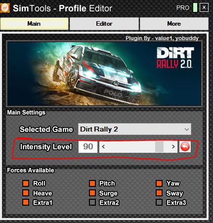

  12. JerryS
    Jul 28, 2020
    6
    - 58Coins
    Thanks Thanos for the response!
    Reaction Speed: Limits how quickly the motors will move to get to the desired position. This is a major factor that impacts the “jerkiness” of the platform.
    Sim Racing Studio "Reaction Speed" this setting is not available for PT Actuator platforms relating to feature in AMC.
    SimTools - Profile Editor "Intensity Level"
    Jerry
  13. Thanos
    Jul 6, 2017
    1,380
    Electronics Engineer
    United States
    2,924Coins
    +1,079 / 10 / -0
    The intensity level on Simtools, is an overall motion filter that adds virtual data points in the motion path and and deliberately lags the response timing to be less than real time.
    SRS doesn't do that in software as they use as much realtime data is available without delays that can cause latency.
    The closest thing that exists on the AMC controller that can mimic the Simtools Intensity level is the "Pulse Filter Crv" which has 5 levels of filtering and smoothing of the motor pulses. It was designed to filter fast occurring and low amplitude spikes and motion data noise, creating smooth curve trajectory path for the motor to move to the target positions with less noise and less vibration. As you increase the Pulse Filter Crv level it adds a bit latency to the motion (Reaction speed) which is close to what you may need. You can see the effect each of the 5 levels have on the motors on this video:

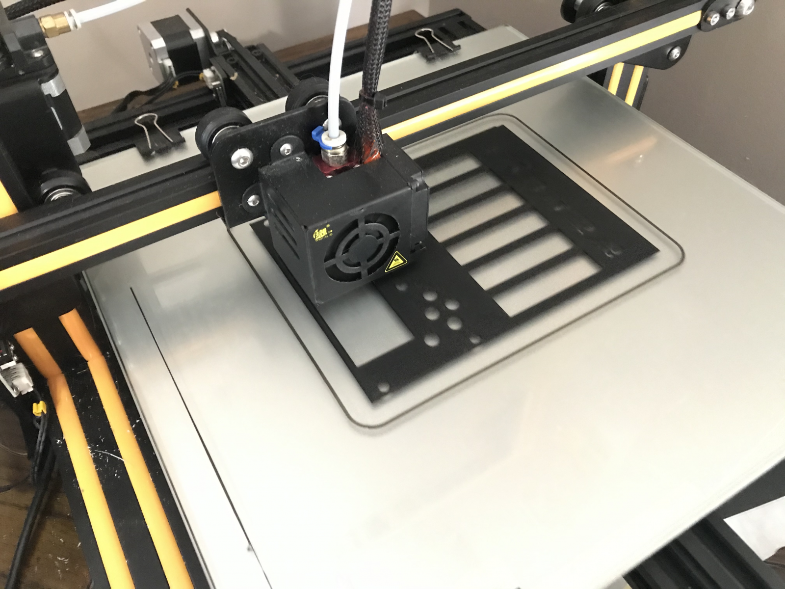

  18. Onii77
    Onii77 New Member
    Apr 13, 2021
    16
    Programmer
    North Carolina, USA
    158Coins
    +19 / 0 / -0
    AC motor, 4DOF
    @Thanos Thanks again for builiding this great board. I am VERY new to the scene and you seem to be one of the most helpful people I have come across in all of my early research so thanks for that too!
    I am about to start the build for the Bajer style "traffic light" E-stop/standby, and I am a little confused about yellow and red switches, in one video you posted () when you click yellow it, it looks (and sounds) very much to me that it's a latching switch, and that red is a momentary, but the directions I see on the MyMiniFactory page https://www.myminifactory.com/object/3d-print-e-stop-amc-aasd15a-155887 notes that it's a momentary switch for yellow and that red is latching.
    Can you clarify a couple of things about how the board interacts with the switches?
    1) Which type of switch do I need for the yellow switch, momentary or latching?
    2) Which type of switch do I need for the red switch, momentary or latching?
    3) Green does not need to be a switch at all, correct?
    4) Are all switches normally open?
    Thanks for your time!

    First of all, there are two switches and 3 leds you can wire.
    The switches are:
    1: e-stop, cuts the power to the motors by disabling the S-ON signal to the servo drives. In this case the actuators might drop free fall if the actuators can be back driven by the load.
    2: Force Offline, which ignores incoming motion data and places the controler offline and parks the actuators.
    Some prefer to wire the yellow led to the force offline switch and some wire the force offline switch to the red button like in the link you shared.
    The official led order I always described is to use the yellow led on the force offline switch as its more relevant. And the red led functions as monetary button to also toggle the platform between park or Standby positions and is wired on the e-stop signal. As long you don't hold it will toggle positions, but if you latch the e-stop signal using the large mushroom type switch it will disconnect the power to the servos.
    Here is a button box that is built upon this principle:
    https://www.tindie.com/products/bajer/emergency-stop-switch-with-led-indicators/
