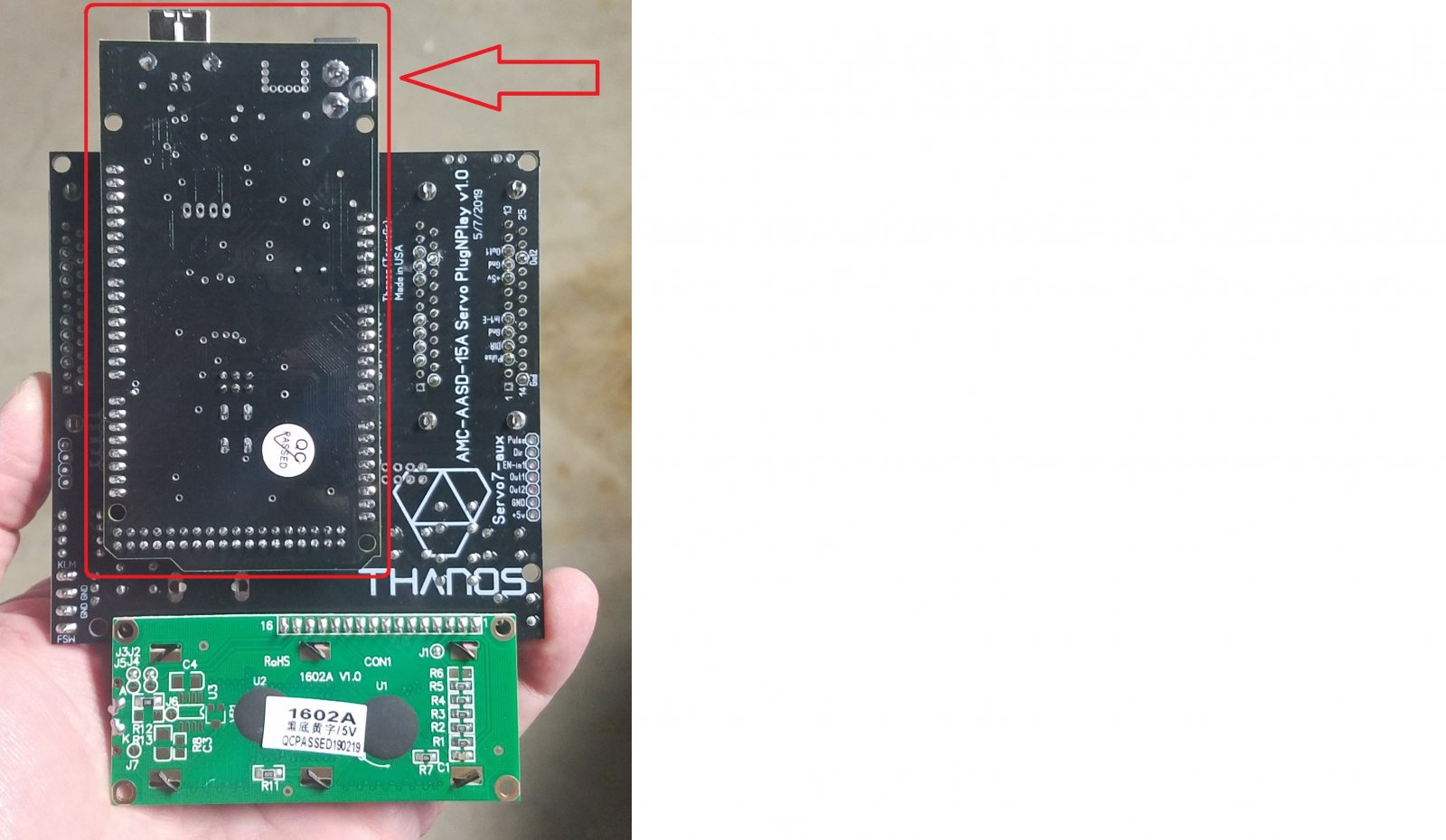

  5. phonghornet
    phonghornet New Member
    Aug 19, 2018
    27
    190Coins
    2DOF, 3DOF, DC motor, Arduino, 4DOF, 6DOF
    @Thanos !
    I want to buy this board. do you sell? Or can I order link?
  6. Thanos
    Jul 6, 2017
    1,380
    Electronics Engineer
    United States
    2,925Coins
    +1,080 / 10 / -0
    Hi, this comes with the AMC-AASD15A controller. Its not sold separately. Sorry.

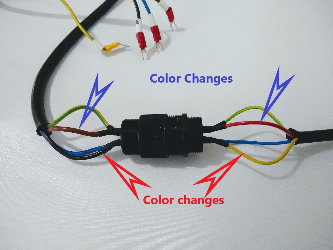

    Just a heads up for those replacing the motor cables on the 90st type servo motors.
    My stock cables have a color coding change at the connectors.
    The red wire from the motor changes to brown at the connector.(wire marker U) at the spade terminal
    The yellow wire from the motor changes to black at the connector (wire marker W) at the spade terminal
    The blue wire from the motor remains the same at the connector (wire marker V) at the spade terminal
    The Yellow with Green tracer remains the same at the connector (wire marker E) at the spade terminal

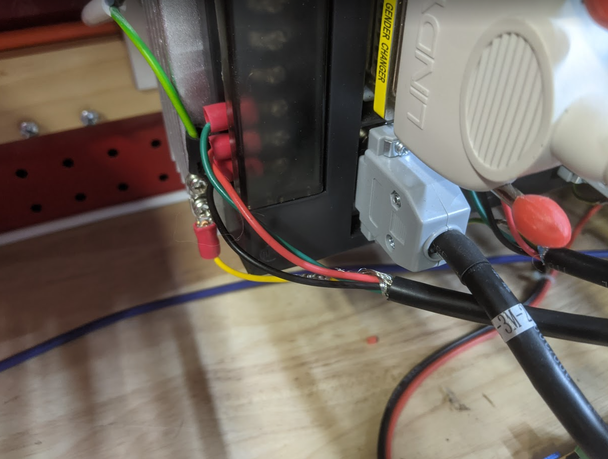

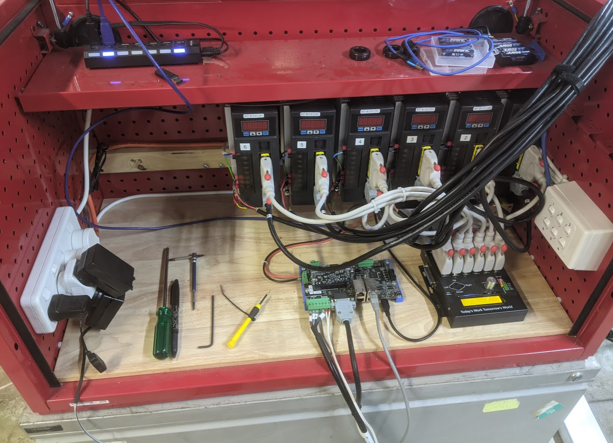

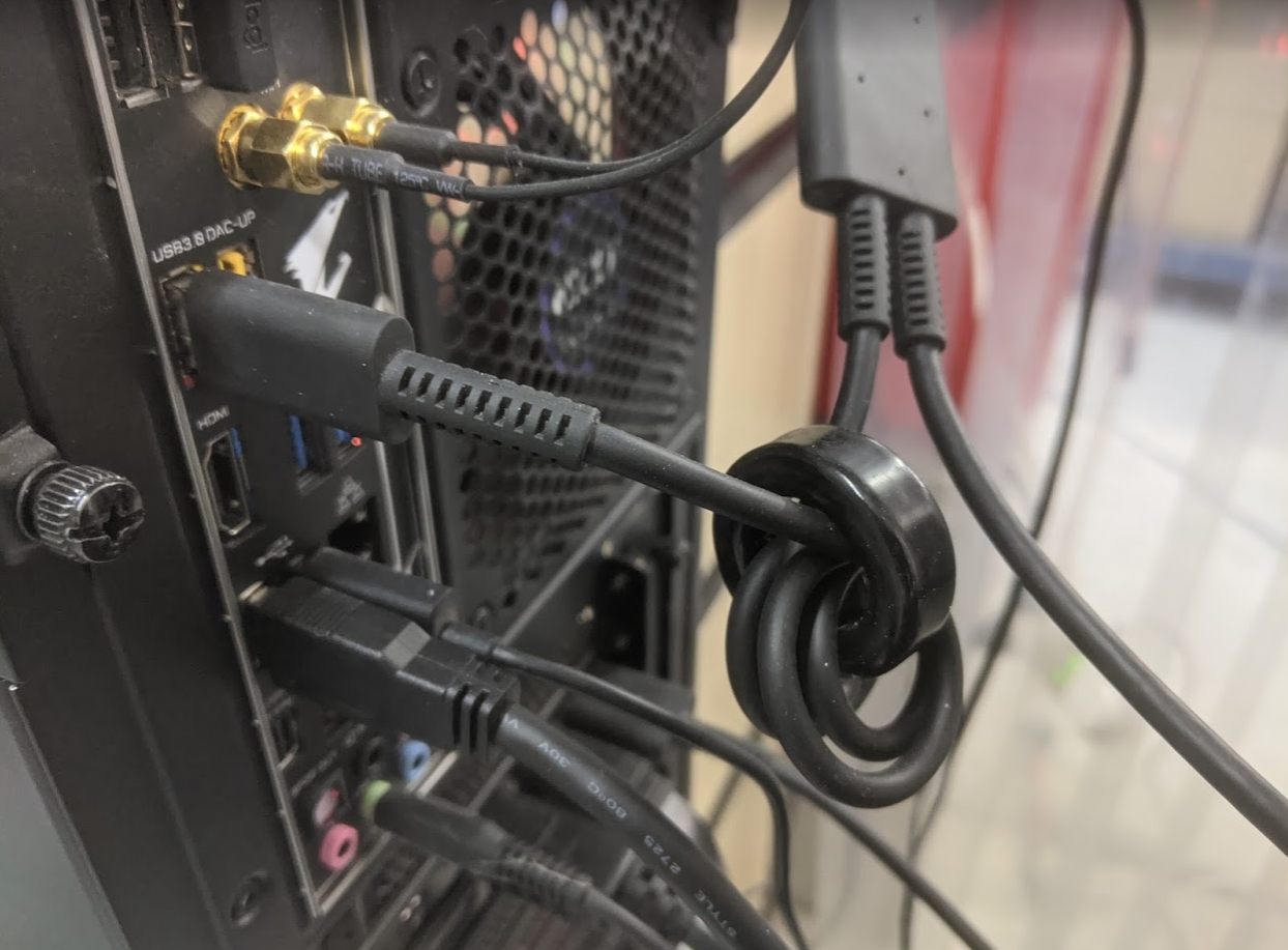

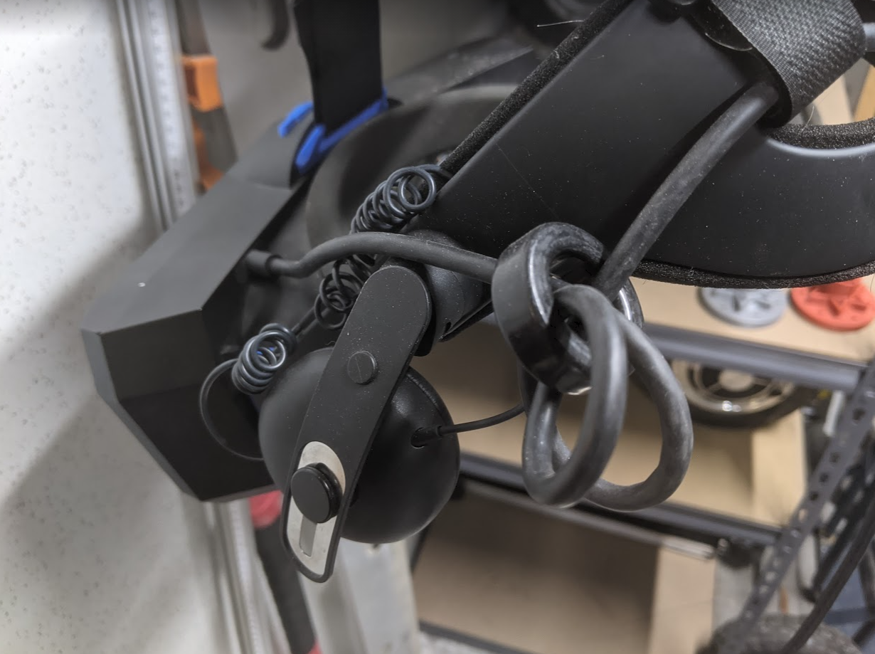

    Since Ive upgraded to AC Servo drives, I'm now trying to resolve an interference/emi problem with my pimax 5k+
    Im having the problem where as soon as I touch to plastic case of the headset, the tracking is lost and it greys out. If I have one drive powered on, it greys out but returns after some seconds, if I have all the drives powered, it never recovers tracking.
    So Ive read about this problem elsewhere and the things I can tell you I have tried so far are :
    -replaced the power lead with shielded cable all the way between the motor body and the driver.
    -run earth wires on every metal component on the rig back to the power supply earth. checked with multimeter.
    -looped the headset cable in ferrite cores at both ends, headset and at pc.
    -using a power filter on the supply for the rig and computer.
    -I have the headset cable hung up high and away from any other cables.
    -I started with one base station, and now tried 2 which doesnt make a difference.
    -Nothing else is powered up except for the servo drives and usb hubs.
    -The tracking is lost no matter if Im sitting in the rig or standing outside next to it.
    -Ive turned off every device in the shed so only the rig and pc are powered up.
    and none of this has worked and Im out of ideas.
    Hoping anyone here can throw some suggestions on what to try next?
    Pictured below are all the things Ive tried.

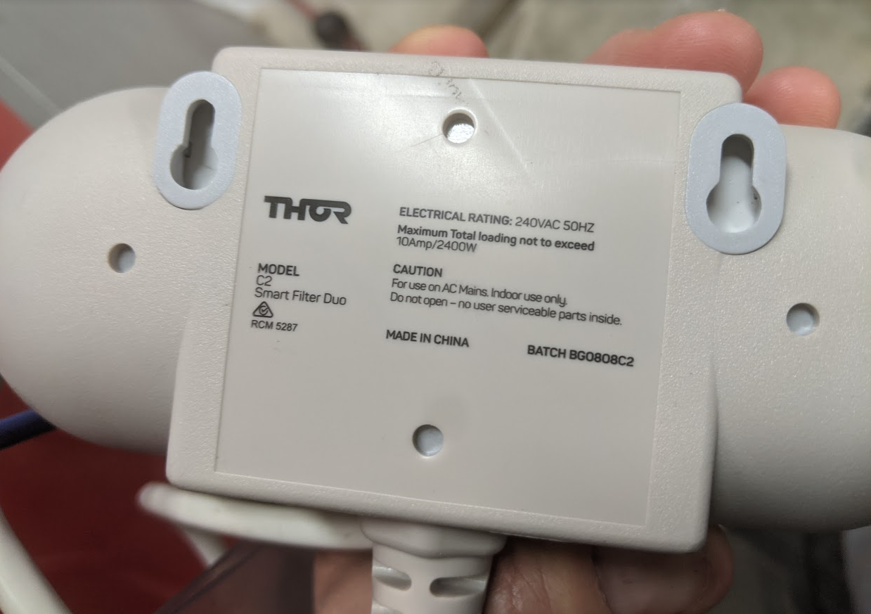

    +142 / 3 / -0
    I tried it out but I only have one filter at the moment. I'll try again soon when I get a second filter.
    What was interesting is I tried the PC on a long power lead into the house on a separate circuit and the rig was on the shed circuit. It was actually worse and my monitor started tripping balls with red sparkles and blanking out. Its becoming a real mystery.
    Anyway, I need to try again once I get a second filter.
    Another thing to try is wraping each of the motor power cords in ferrite rings.
    I think Ive only got one more weekend of troubleshooting left in me before i crack it and pack up the pimax.
    Ive ordered the Reverb G2 so I might just go without VR until it arrives in December.

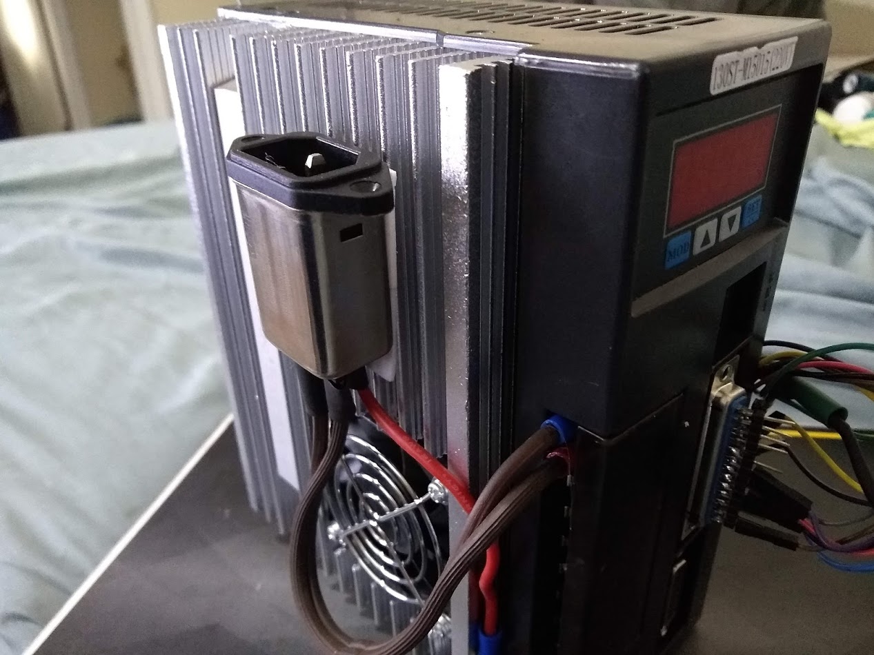

  20. T R Para
    T R Para i make stuff up
    Oct 18, 2018
    385
    Cincinnati, Oh
    2,447Coins
    +358 / 3 / -0
    AC motor, 6DOF
    I believe it does detect the EMI radiating from these servos.
    When you say the drives were powered on and off. Do you mean removal of the AC power mains voltage?
    When the servos are holding position ecc. working against the weight of the rigs platform they are still emitting EMI.
    I also see that all the mains run to a switch block on the right of the picture then must loop back to the left to the filter which appears to be an unshielded filter device..
    These are the cheap filters I use and they seem to work very well. They are located right on the AASD drives, use only a few cm of unshielded wire, are directly grounded to the AASD's and are completely shielded themselves within their metal housings..
    www.amazon.com/dp/B07XMGWF4F/ref=dp_prsubs_1
    Mains power switch all metal shielded.
    www.amazon.com/gp/product/B00BQO5S0G/ref=ppx_yo_dt_b_asin_title_o08_s00?ie=UTF8&psc=1
    Shielded power cable.
    www.amazon.com/gp/product/B002HVYVNC/ref=ppx_od_dt_b_asin_title_s00?ie=UTF8&psc=1
    Sorry for the way too long post.:):):) !
