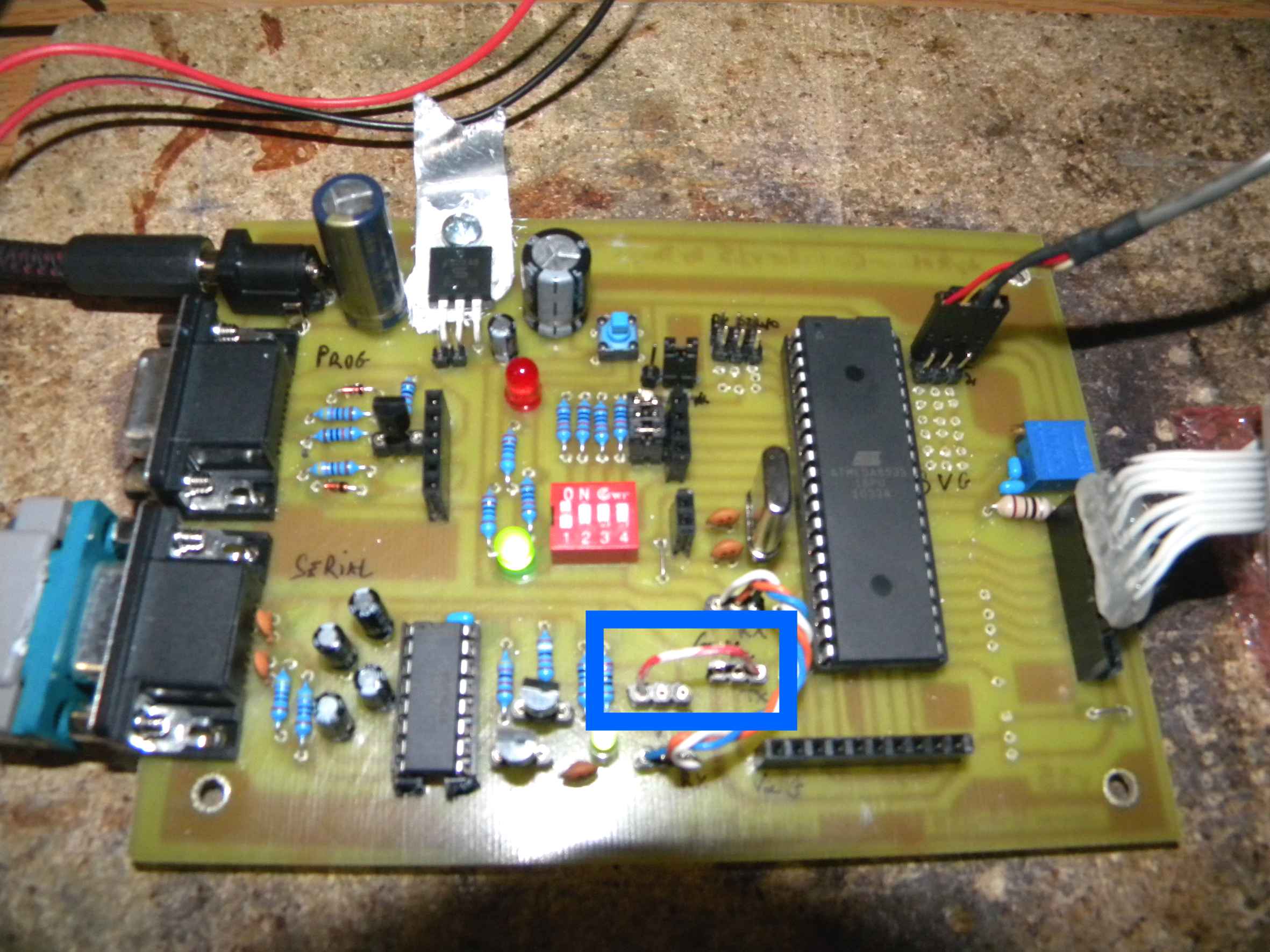

    Hi Fred,
    Thanks for the reply, I am not using the LCD connection board, I just wired it straight to the lcd, is that alright?
    In regards to step by step I do the following.
    1) Flip dip switch to position 2. I connec tthe serial cable to the computer db9 connection and the serial connection of the amc board(note: not the programming db9 the other one)
    2) Open hyper terminal on windows xp and put in the parrameters as per Thanos guide to open new connection.
    3) I restart the AMC and wait for hyper terminal to show the connection, however nothing is displayed.
    I look at the LCD and there is no data, there is only blank squares.
    So i guess can you answer the following,
    do I need the lcd connection board?
    wil the connection board fix the lcd not showing anything?
    Will the lcd connection board cause the hyper terminal not to show anything?
    Dale

    hy guys,
    is there a guide on the first post tronic, following it step by step it works!
    greetings

    For HyperTerm to work, you need to connect both bridges (two way communication). I can't see well on pic, but you're missing two wires on one of two bridges. Make two 3 lead cables (you already have one) and use this guide http://www.x-simulator.de/forum/download/file.php?id=612 if you already didn't read it, which I doubt.
    BR, Igor

    simply connect the cables as in the photo, the three wires that are in connection in connection tx and rx, 2 wires are carrying over Vcc and ground, as if colleagues in the picture will still work!
    bye
    micma80
