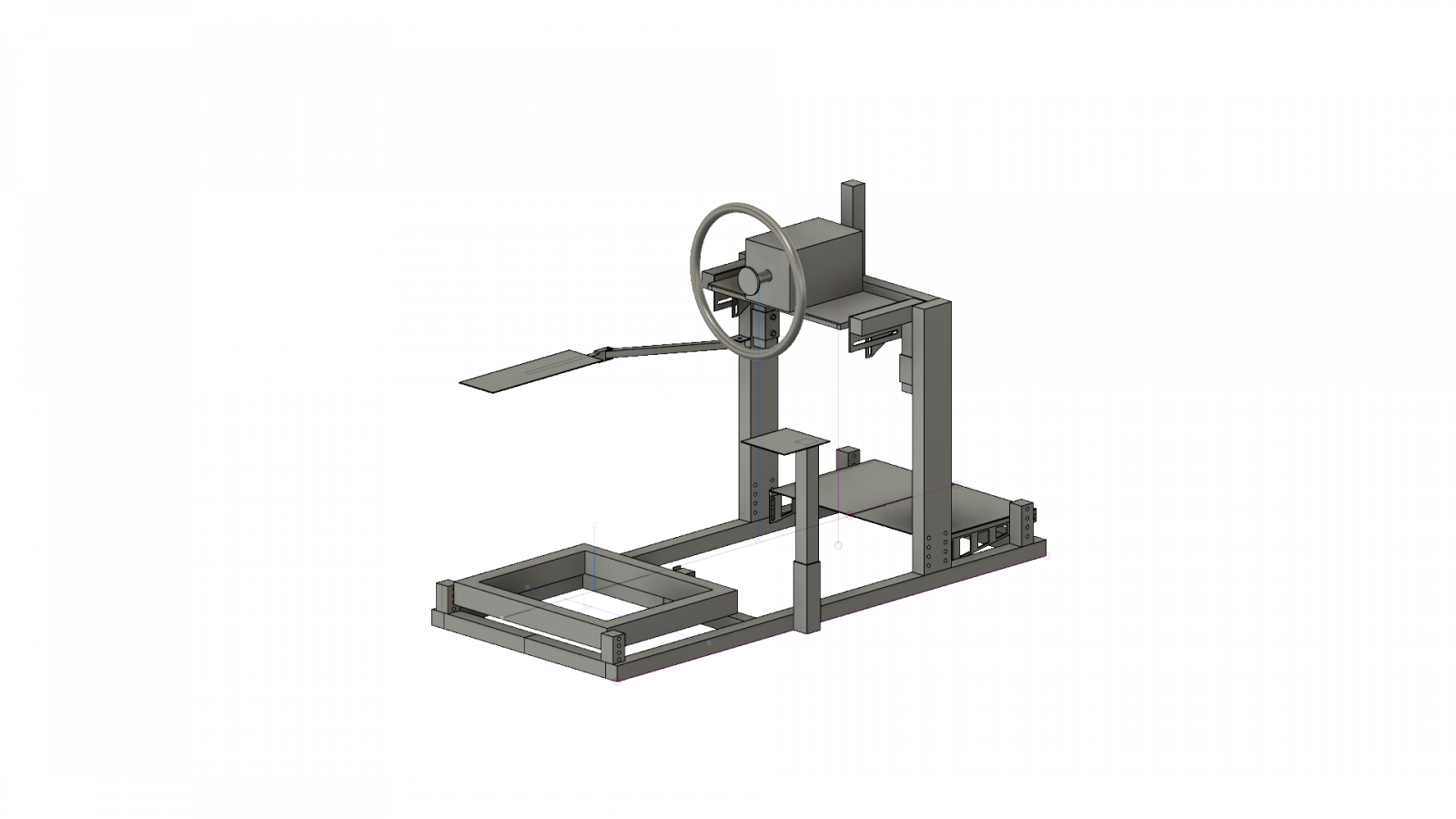

    Im planning on upgrading from a G25 to a DD wheel, most likely a SimuCUBE OSW. My current rig is not suited for the torque a DD wheel delivers so I am planning to weld a new one. These are my goals from the new rig:
    • High stiffness for detailed feedback while still being light
    • Possibility to expand to full motion rig (not a seat mover)
    • High adjustibility
    • Good ergonomics
    • Good cable management
    • Easy access to mouse and keyboard
    • Solid mounting point for VR without vibration
    • Price of about 150€
    I am designing the rig in Fusion360 and I will post the progress in a few days.
    While designing it I had two questions in mind:
    • How big / thick should the square tubes be?
    • Which material should I use for the best weight to stiffness ratio?
    Thanks for any answers in advance.
    Any advice is welcome.

    I am mainly using 35x35x2 in my model now, tommorow i will post some pictures of it.
    Yet I’m still interested if Aluminium is stiffer if I adapt the tube sizes and end up with the same weight compared to the steel rig.

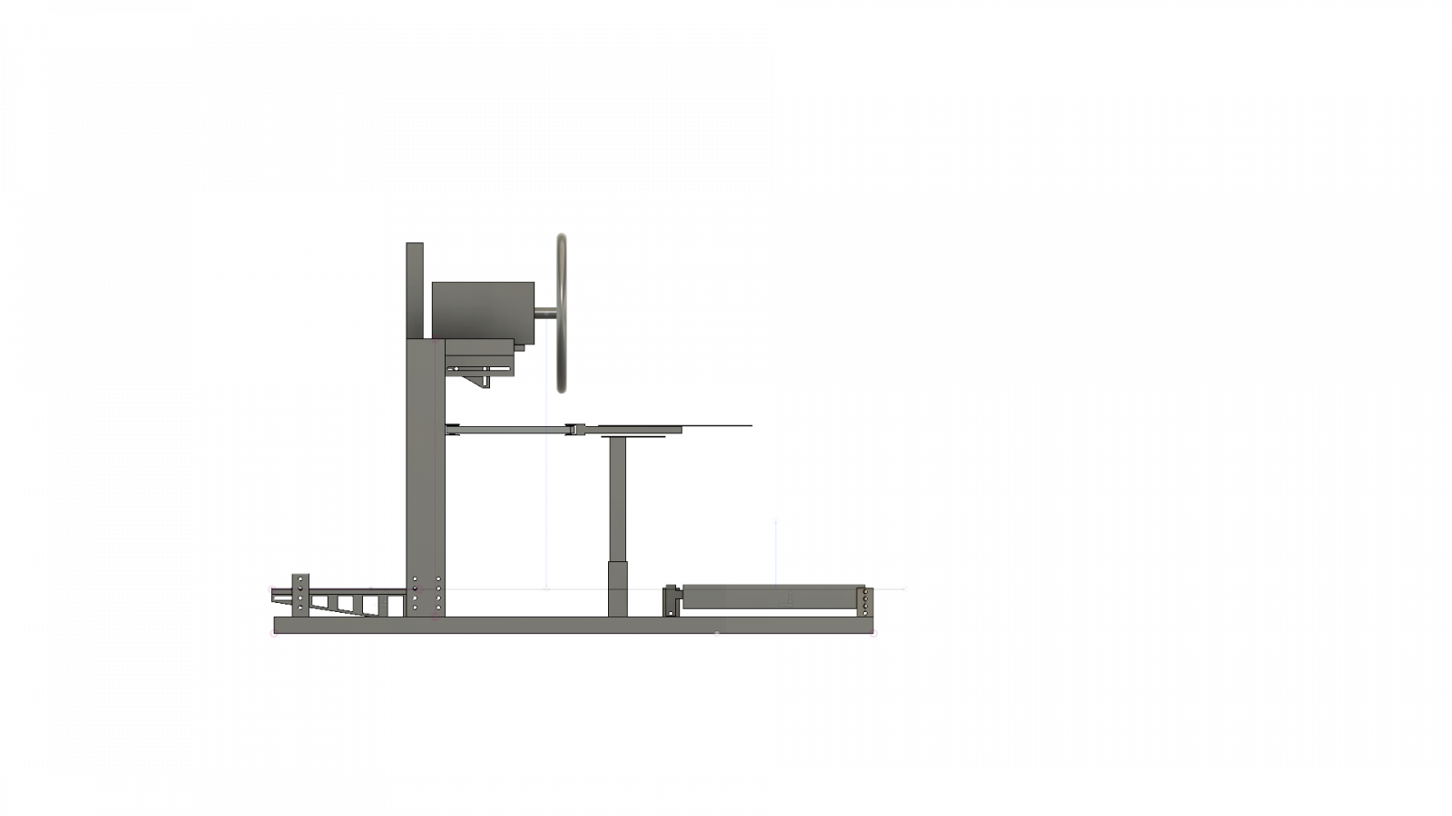

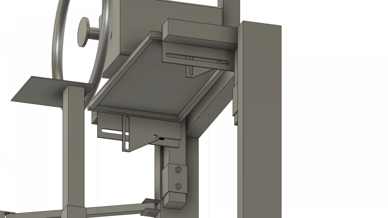

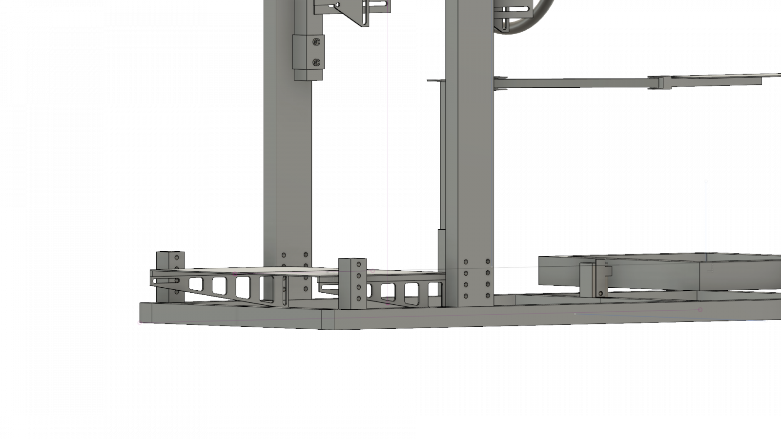

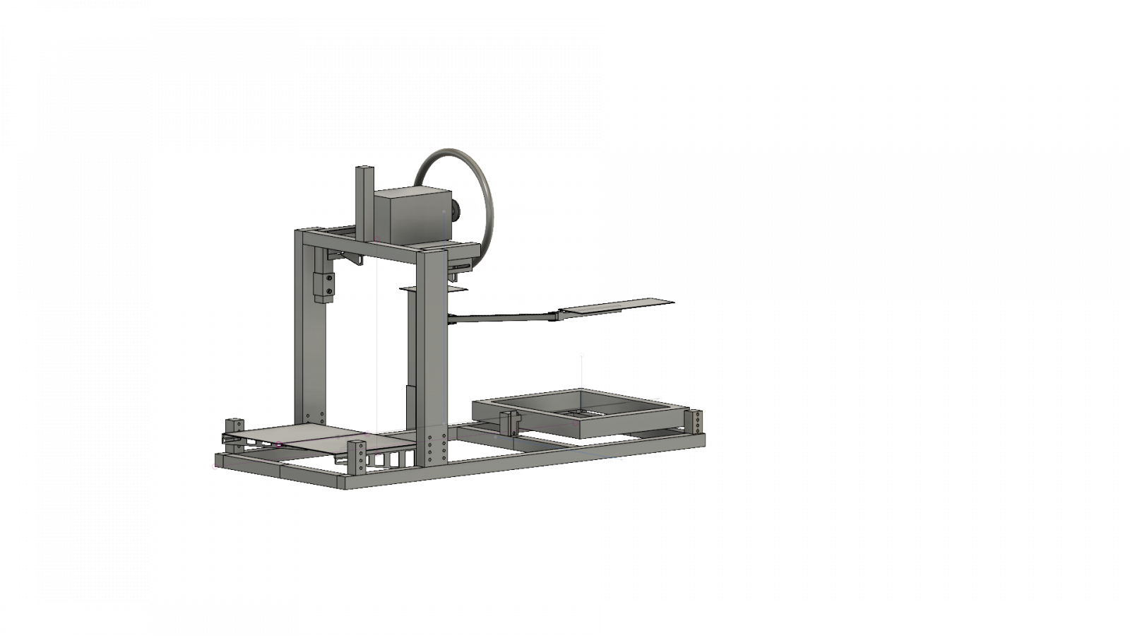

    I ordered all the tubes that I need for the rig (hopefully).
    I decided to go for 35x35x2 steel tubes for the main structures, as steel and aluminium have the same specific modulus (stiffness-to-weight-ratio) while steel is less expensive. I hope it wont flex...
    The steel plates in the model (wheel plate and pedal plate) will be about 3mm thick.
    The design I went for is inspired by the GT1 Evo Sim Racing Cockpit from SimLab.
    I'm open for suggestions and inspiration before I start welding.
