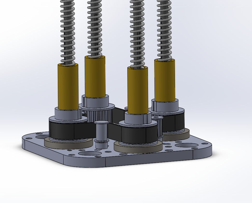

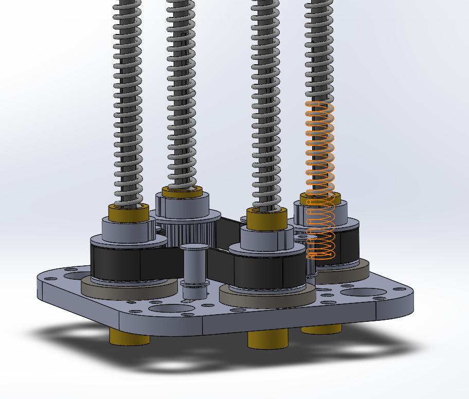

    I'm not following your "Spring_Preload_Mechanism" Drawing in Solid works.
    Can you splain? Do they wind the collective springs to pretension? Assume preset initial position upon assembly?
  20. Tim McGuire
    Jul 26, 2015
    261
    Canada
    2,229Coins
    +317 / 2 / -0
    3DOF, DC motor

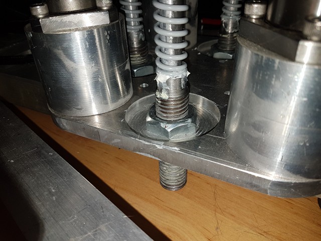

    That was one of the parts that I still have to finish. Think of it like a screw jack for a car, as you turn the outside part, the inner part moves up and down to preload the springs. The part that the spring attaches was supposed to have an ACME thread cut into it, and the hollow bit that it slides into would have the corresponding female thread (I ran into problems trying to find a reasonable way to cut ACME threads without buying expensive lathe inserts). The timing belt is wrapped around the outside to ensure that all of the springs are preloaded equally. I also wanted a small electric motor attached to one of the drive pulleys to allow it to automatically calibrate to user weight eventually, but the mechanism was turning out to be much harder to actually build than I anticipated, so I decided to put it on the backburner for now:
    What I ended up doing as a temporary measure was using a 1 1/8" nut, and a hollowed out piece of the corresponding threaded rod, which I turn manually to adjust the preload (it's a bit messy, just applied a fresh coat of grease to it):
