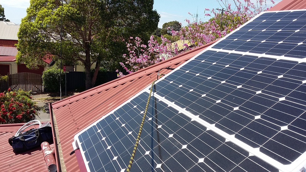

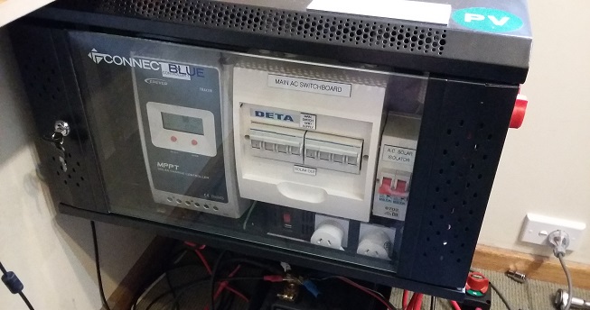

    I use a solar array and two deep cycle 110AmpHr batteries to power my DC rig, works perfectly and is also able to power parts of my house via a Inverter normally and when power is cut in a storm etc(has already been used for emergency power since it was installed). Unfortunately not a cheap setup..(note only one battery shown in old photo - I did later get another on special from the same supplier - they are not cheap :eek:). All that wind generator would be good for is to charge the batteries.
