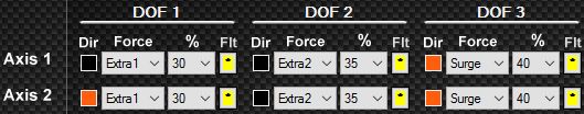

    Here are the axis settings that work quite well for me, though they still need to be improved:
    I configured the following filters:
    Extra1: 40% Smoothing
    Extra2: 25% Smoothing
    Surge: 25% Smooting
    I am really excited about the plugin and I will continue improving my profile asap.

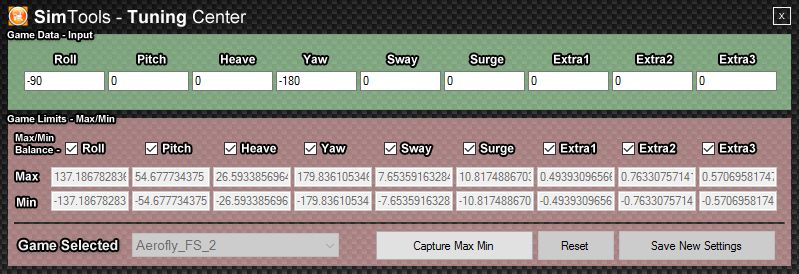

    @value1: One more question about the Aerofly plugin:
    I am still not able to use the Roll force: As soon as I add Roll to the axis settings within Game Engine, my seat immediately tilts completely to the left when I launch Aerofly.

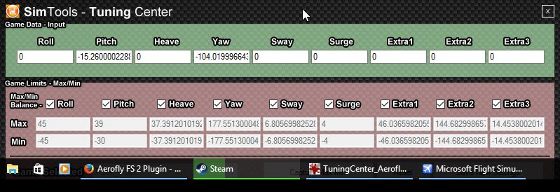

    Now I saw that there is a value of -90 in the Tuning Center's game data input field for the Roll force, while the plane is still standing on the runway (see screenshot below):
    In contrast to this, here is a Tuning Center Screenshot for MS Flight Sim X, captured while the plane was also standing on the runway. You see that here roll is 0.
    So I suppose that the -90 in Aerofly is a wrong value which causes the rig to tilt to the left right after launching Aerofly. Shouldn't it actually be 0?
    Best regards,
    Markus
