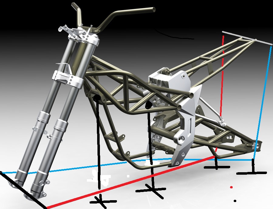

    Either way, being able to mount a screen I already have right to the simulator removes concerns about having structure obscuring view of the screen. This lets me move the pivot point higher than eye level.

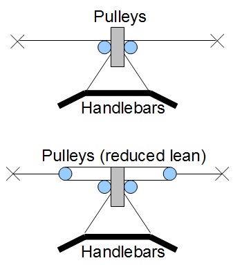

    The more I think about this, the more I think that's the way to go. It has a lower parts cost up front, I'm not having to mess with opposing forces and preload. Reducing complexity also reduces risk of failure; one of my big concerns with a lower pivot point is that I'm relying on forces to keep the bike upright - if those fail and the bike falls all the way to one side there is a high risk of injury. A high pivot point removes that risk.
    Here's how I'm planning to link the handlebars to lean. The beam in front is part of the dynamic frame which leans with the bike, and the cables are attached to the rigid frame the dynamic frame hangs from. Moving where on the handlebars the cables connect and varying the number of pulleys and how they're arranged allows me to adjust how much force it takes to lean the bike vs how much lean I get out of it.
    I use guy wires, saddles, and turnbuckles for guyed masts at work, so everything but the pulleys is available at no cost. No cost makes me happy. :)

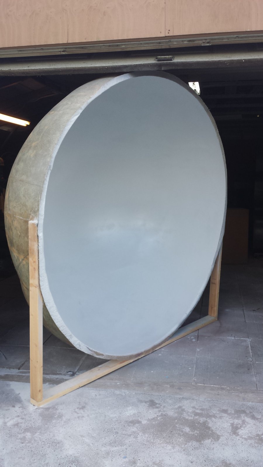

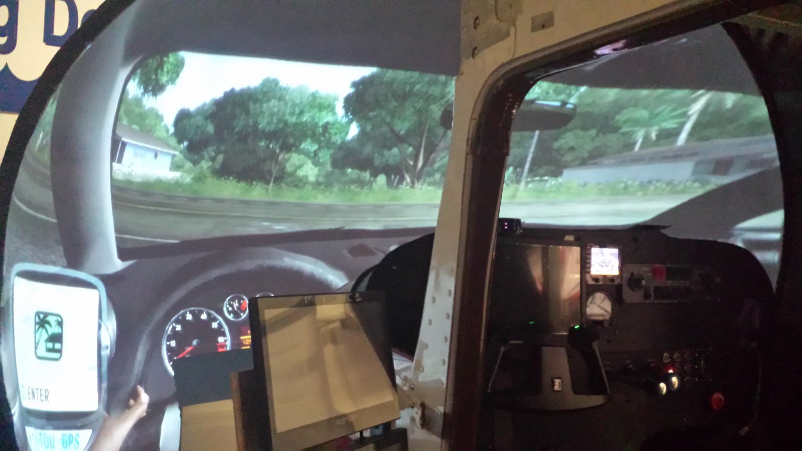

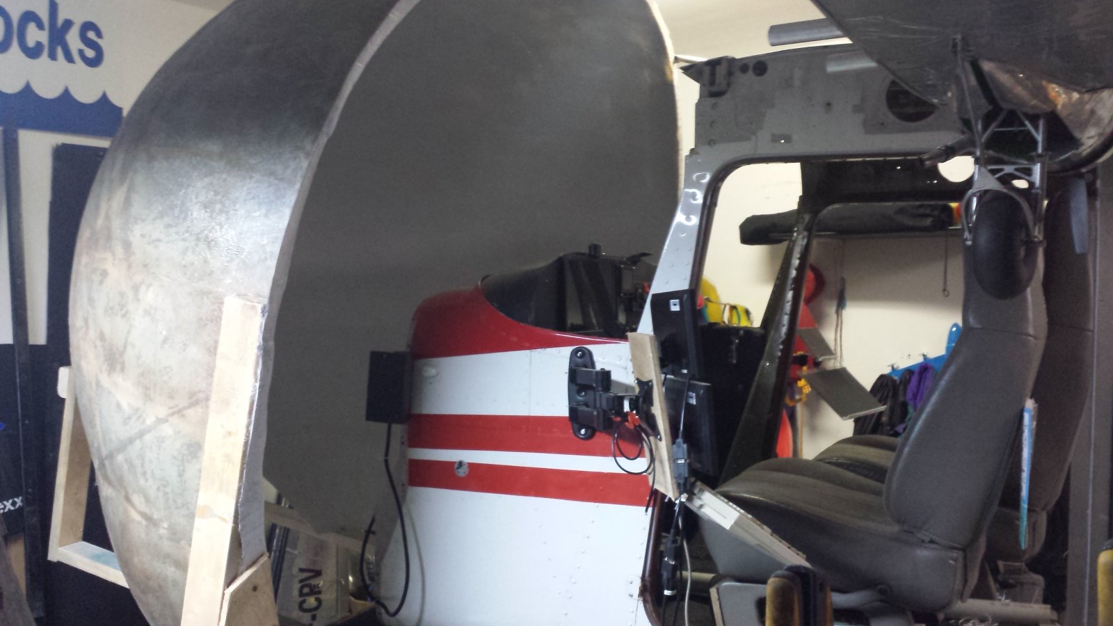

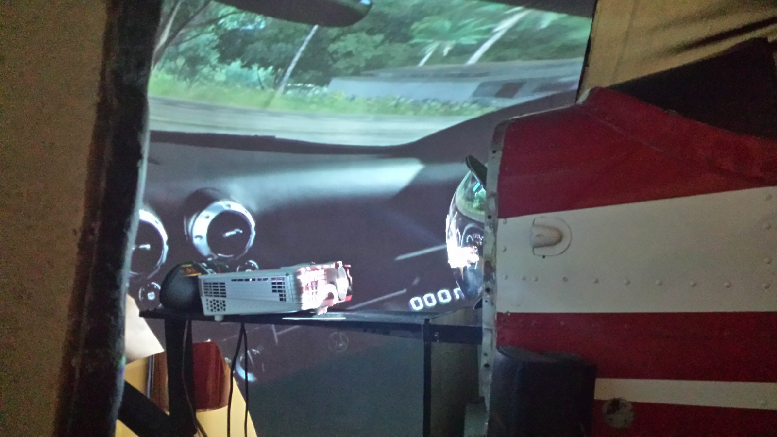

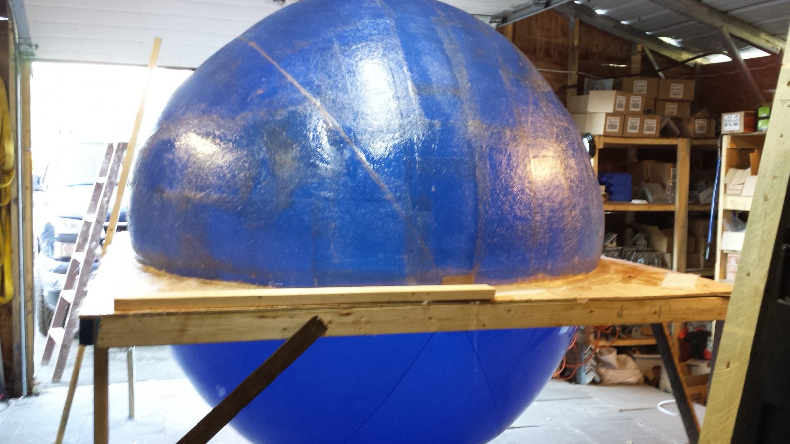

    I built this half hemisphere screen best immersion yet. I had the 3 projectors with surround 3DOF but this with 1 projector( Benq W1070 3d) and a 1/4 hemisphere mirror . Great immersion . Still working on it but 90 % there. One thing I have noticed with simulators that tilt a lot ,people tend to keep their head straight, its a natural tendency to keep your head vertical. If the projection is good you don't need a lot of movement to convince the brain your leaning or pitching. 20151007_184451.jpg

    Off topic but it would be interesting to hear more detail about your screen, its construction, setup including software and if possible post a video of it in use in a dedicated thread.

    Yes I will do a video I am just waiting for a new mirror, the one I am using now is an old very scratched up one.
    I used a 7 ft Beach ball and fiberglass over it . D lp projector and a 1/4 hemisphere mirror requiring NO screen correction software which is a real bonus which I had to use for the 3 surround screen, I was using Fly elise ng. a few quick pics . I will post a new thread next week.

    Quote::If I replace the front axle with a longer bar, I can connect each end of it to cables running to the front of the base. That would cause the handlebars to pull on the cable and lean the bike. There are probably fancier solutions involving pulleys that I might look into.
    I think you are the right track with this idea of a bar through the front axle using cables ,I have had cables various lengths made up for Marine steering ,push pull ,not expensive but very strong and no give to them.() Pivot the bike from the CG point with you on it. Criss cross the cables so the left front goes to the right rear of the bike pulling it down and vise versa for the right front . Maybe use gas shocks to help with the weight shift? Plus with the bar you can make it as long as you want, the longer the bar the more lean adjust it to what feels right.

    After some thought, I think I'm better off attached the cables directly to the handlebars. The forks should be more than able to handle the twisting forces, but why introduce an unnecessary point of failure?
