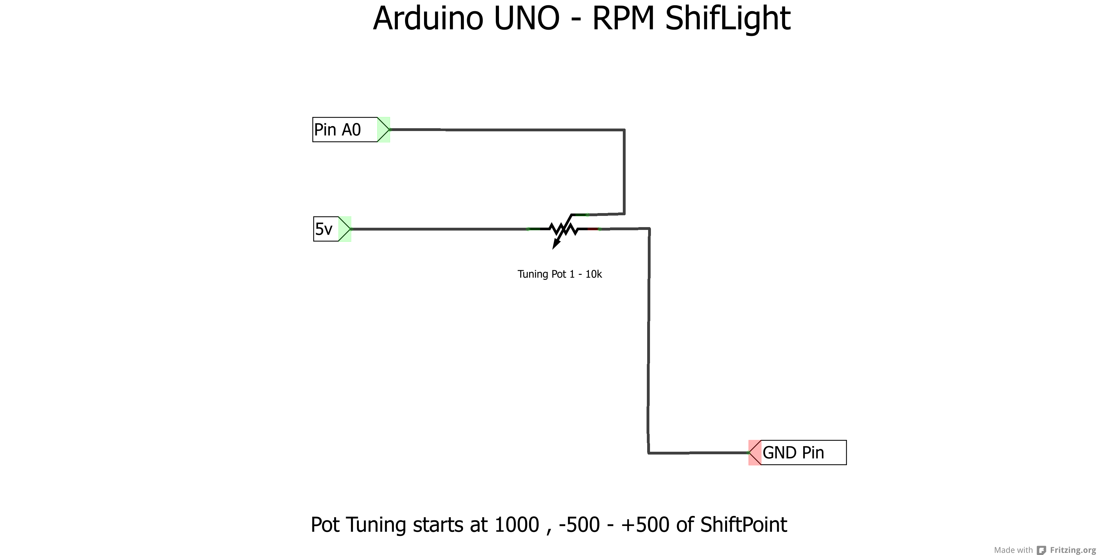

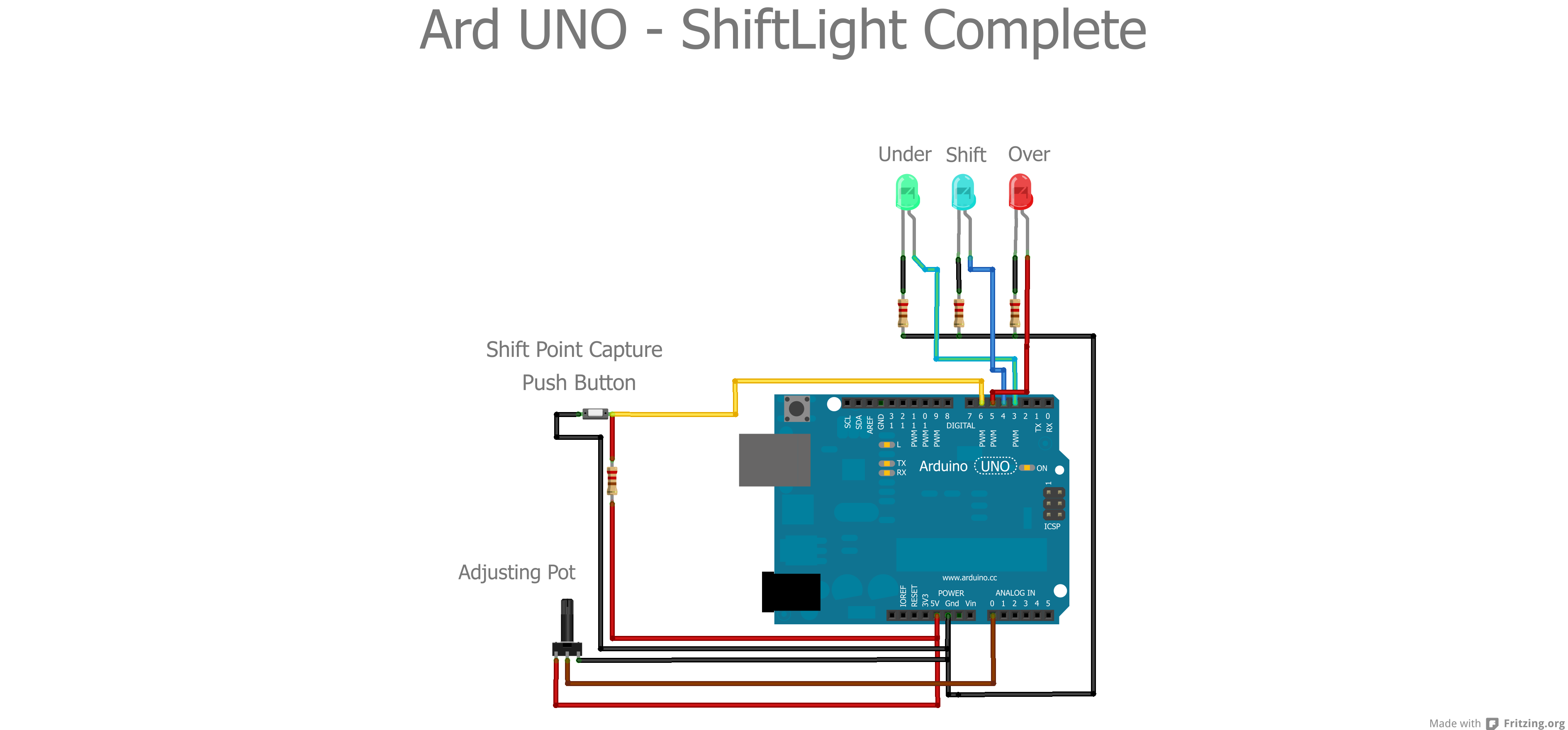

    Adjustable Shift Light with Ard UNO.
    Aim: To use the GameDash to capture the Rpm value from the game and send it to the Ard UNO in a form like Rxxxxx where xxxxx is the real value for the Rpm value for example 1000 rpm = R01000.
    With the Uno we can set a shift point by holding the desired rev point and pressing a button to capture the rpm plus use a pot to change the range the Undershift and OverShift lights come on.
    Diagrams :
    ShiftLight Box.png arduino Shift Light - ShiftLight Complete_bb.png arduino Shift Light - Leds_schem.png arduino Shift Light - Shiftpoint Capture Circuit_schem.png arduino Shift Light - Tuner Circuit_schem.png
    Arduino Code:
    Please note to use this code in Serial Monitor of the Arduino IDE , Type R04000 to show shift point and 500 higher and lower to control both leds, Pot will increase the margin between led points and a press of the button will capture the current rpm and set that to the ShiftPoint.
    To use with the GameDash please comment out any of the Serial.pr* lines with a // in front of them and GameDash will now work with it.
    Arduino Code as tested with a UNO and Freetronics Eleven and Nano contained in zip.

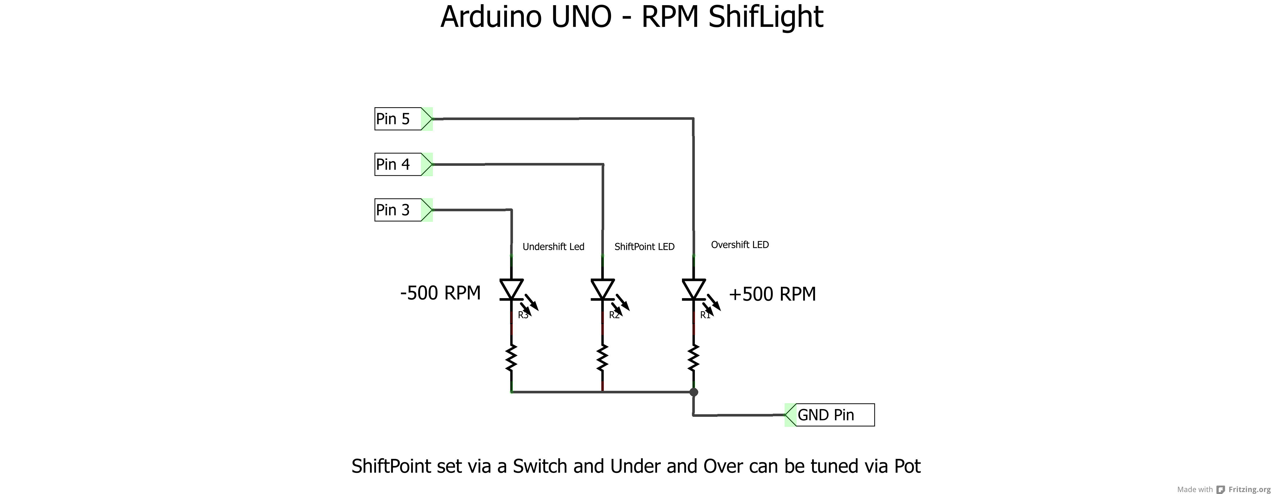

    Setup the pins and Initiate the pins we will use either in Output or Input.
    Pin 3 - UnderShiftPoint Led.
    Pin 4 - ShiftPoint Led.
    Pin 5 - OverShiftPoint Led.

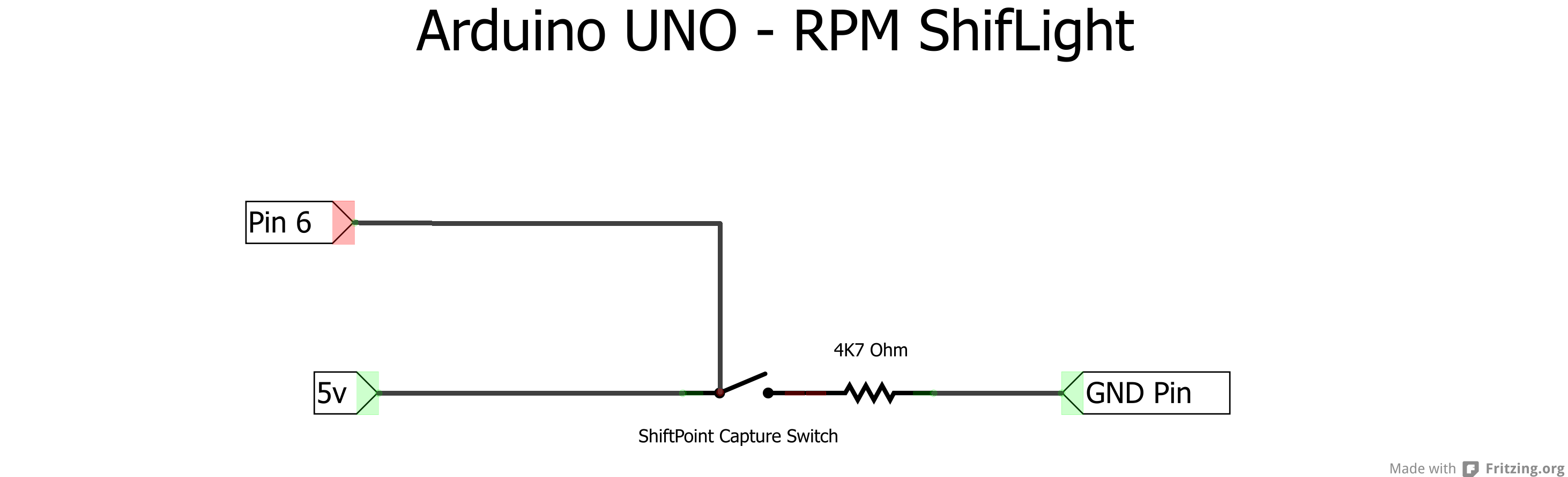

    CheckButtonPress()
    Read the switchs state (reading) that’s connected to pin 6.(HIGH/LOW)
    If the state(reading) is not equal to the LastButtonState ,
    Then start counting in ms and assign this to the lastdebouncetime.
    If the counter millis() minus the lastDebounceTime) greater than the debounceDelay (we do this to filter out any noise ie some moment button when press give 2 to 3 changes on a press. So we debounce it to clear it up,
    Then if the button state(reading) not equal to the ButtonState,
    We make ButtonState is equal to the reading to keep the new state.
    If the ButtonState is equal to HIGH as in it was pressed,
    We make the ShiftPoint equal to the read RpmSimTools we got in ReadData.
    Return to the loop.
    CheckShiftLighAdj()
    Read the pot connected to a01 and return this value to LimitRange(0-1023).
    Now calculate the how far to adjust the rpm but mapping (0-1023) to (0-2000) so that 1023 on the pot equals 2000 rpm for a change to occur.
    Now set the UnderShift which is equal to above calculate rpm.
    Now set the OverShift which again is equal to the above, keep them separate so one may have different settings in the future.
    Return to the loop.
    SetLimits()
    The UnderShiftPoint (where the green led comes on) is equal to the ShiftPoint minus the UnderShift.
    The OverShiftPoint (where the Red Led comes on) is equal to the ShiftPoint plus the Overshift.
    Return to loop.
    DisplayLeds()
    Right to gain the right sequence of lights , for example I used this.
    They follow this truth table below. (On = HIGH) (Off = LOW).
    Undershift Green(pin3)On Blue(Pin4)Off Red(Pin5)Off.
    ShiftPoint Green(pin3)On Blue(Pin4)On Red(Pin5)Off.
    OverShift Green(Pin3)On Blue(Pin4)On Red(Pin5)On.

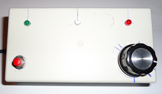

    How to Use:
    Once in game, go onto the track and rev the car in neutral to the desired rev that you want to shift at, and hold it. Now press the button and the shift light should appear, now if you want the Undershift light to be a 500 rpm under the Shiftlight, then back of the rpm by the desired amount then turn the pot until only the green(UnderShift) led is light.But if not worried about an Undershift point and you wish to set a Max Rpm (Overshift) point, then hold the rpm at this point , and turn the pot so that all leds come on at this point. All depends on what you want set.

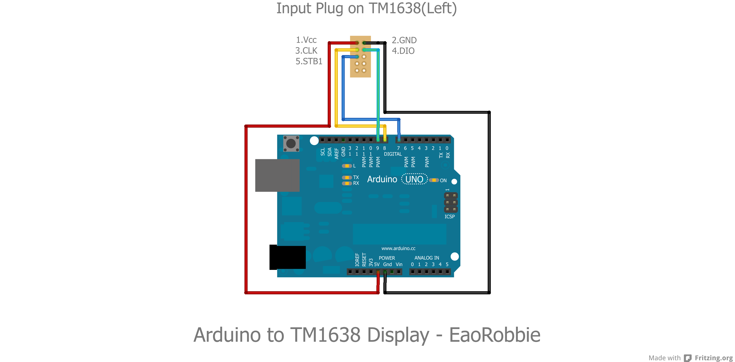

    Above can be added into the wiring and a display can be used to emulate more of the Dash Board, the script become a lot bigger too. Sorry I need to document this separately.

    Im trying to replicate the adjustable shift light without the tm1638, but using an arduino mega2560. Ive' wired it to your spec though i am using 10k resistors on both leds and the button though i only had a toggle switch for thus but wired it the same.

    Question about this set up im using 220 ohm resistors for the 3 leds 4k7 resistor for the capture button and a 5k pot for the adjustment but in lfs anyway when it goes below 3500 ish revs all 3 leds come on and stay on till you go above the 3500 then they go off till all 3 of them come on at once when reached the max rpm of what was captured, now is it as simple as using a 10k pot or something else
    Kind regards
