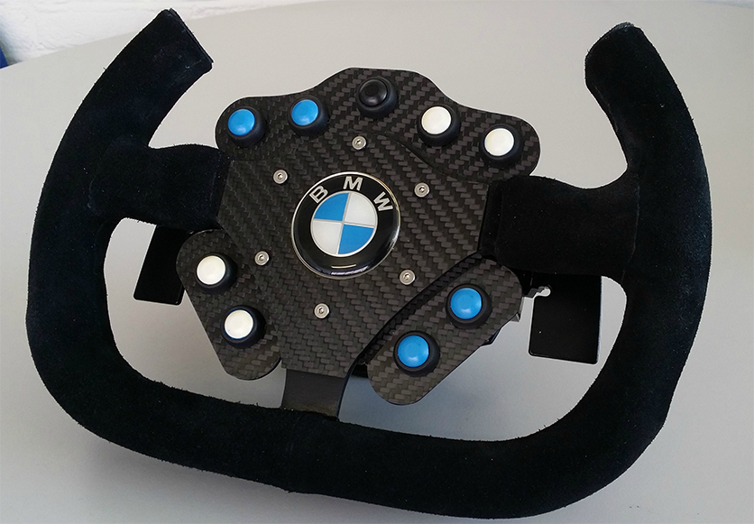

    I'm more than happy with the result and i'm very much looking forward to put this rim on my AccuForce when it arrives.
    I just got shipping notificatons of the DSD32 micro button controler. It's only 50x35mm big and can fit right in the middle of the rim between the 6 bolts.

    Cool! Did you try different button layouts for the Blue / White?
    If it were me, I would make it match the badge a bit more by having all blue top left, then all white top right then all blue bottom right and all white bottom left??
    Artists Impression: :)

    That looks pretty cool too and very impressive photo shop skills :thumbs

    I didn't like the stock rim and replaced with a Momo Mod 30. The BMW formula also works like a charm and is really awesome to drive
    Tonigh i took the AF buttonbox appart and replaced the 4 lower red buttons with yellow ones. It now even looks better.
