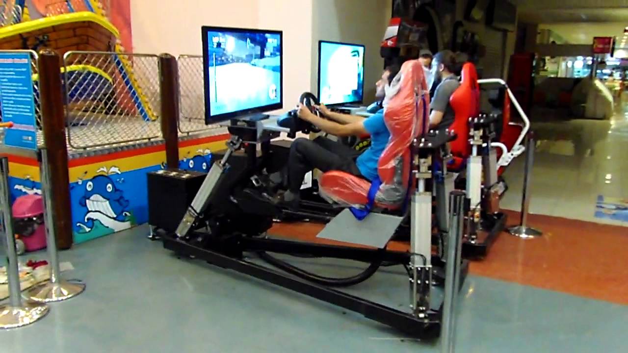

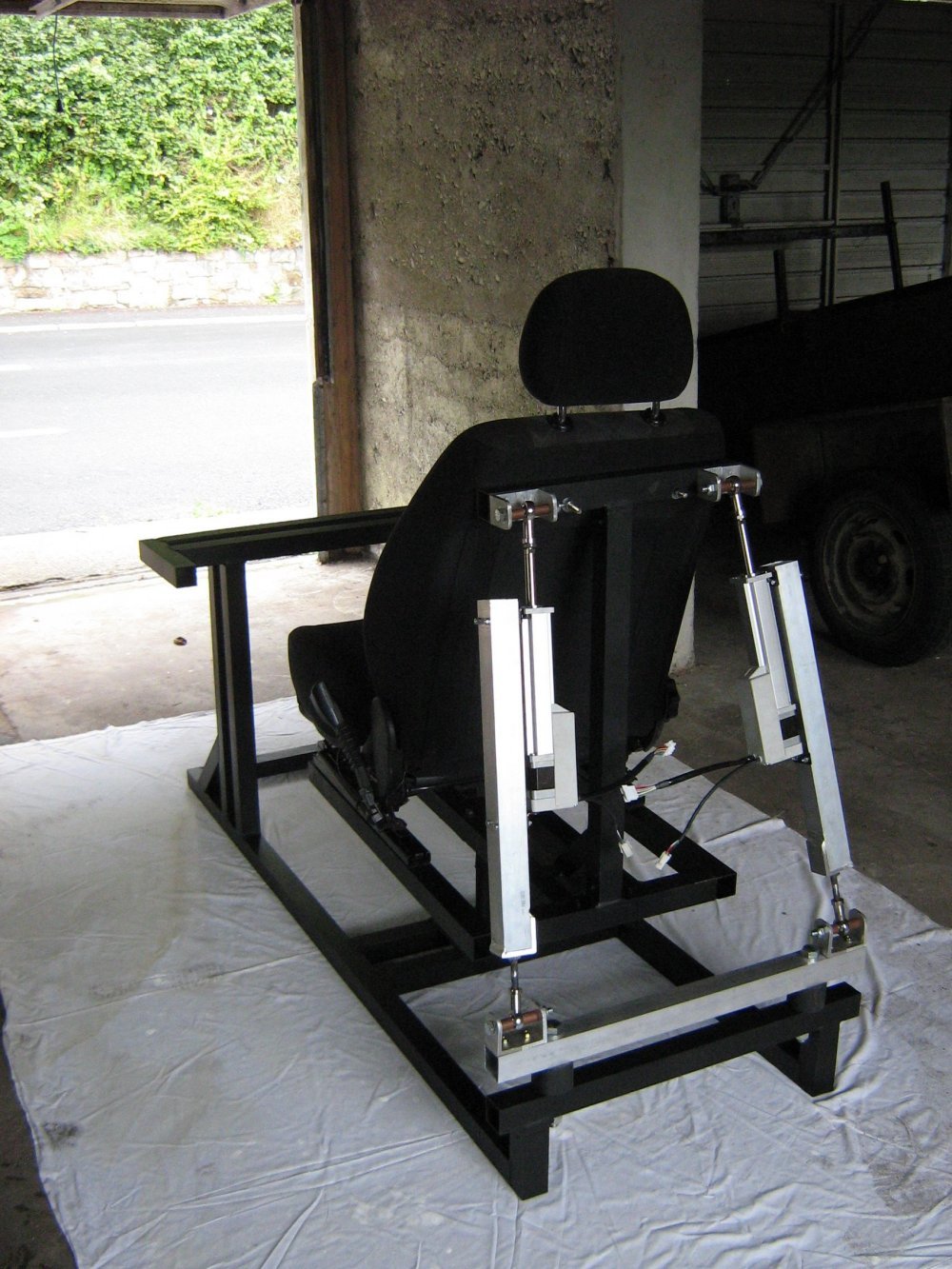

    Hopefully a simple question which is easier asked through a couple of illustrations as shown below.
    Question -
    Why is it often seen that the actuator motor/drive is fixed to the moving part be that a seat or frame? This doesn't make sense to me as it is adding the additional weight of the motor/drive and actuator plus it also means that the wires are more difficult to route neatly. But a lot of simulators do this, even professionally designed ones and so I'm wondering if I'm missing a less obvious reason for this. Is it just the easiest method?​
    Couldn't both of the above could have the actuator mounted closer to the base and then extend the actuator rod?

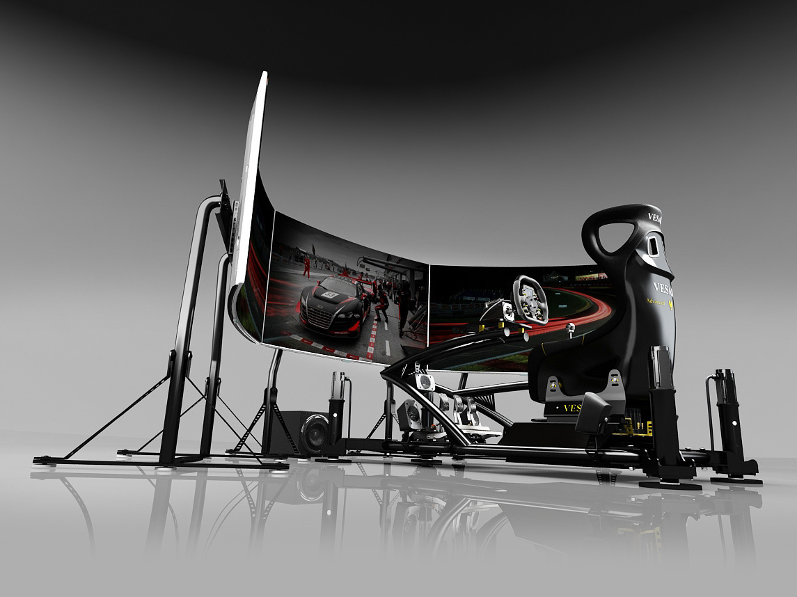

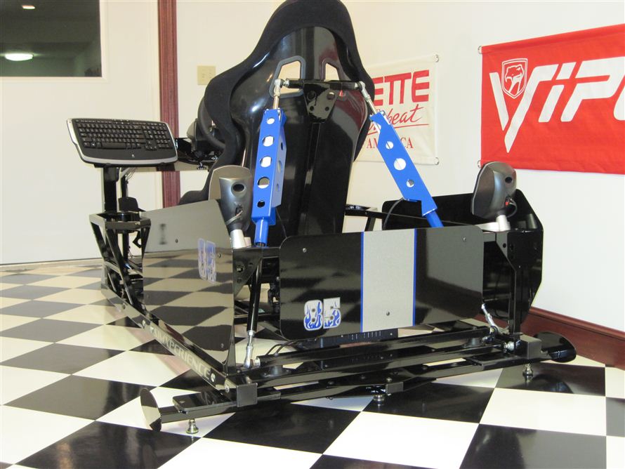

    And here's two of my favourite looking commercial models...
    But again couldn't the actuators have been mounted the other way round? The image below demonstrates how this is even possible using the largest of actuators...
