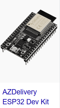

    Hi guys. tensionR is an active belt tensioner device from PT and only works with SRS.
    that's a pity because many people with diy rigs and especially with 6dof rigs might also want to use this belt system. SRS does not support real diy 6dof rigs . I had some time and wrote a new firmware for the esp32 so that access also works with simtools and flypt mover. i am very satisfied with the system. I didn't notice any differences in the function compared to the original. hope that helps someone.
    the firmware is for free .. and if you want to test it please write pm or call me @ motion4sim#4206 at discord
    here is a small video about it:
    you can install the bin with esp flash tool:
    https://www.aeq-web.com/esp32-flash-tool-exported-program-upload-bin-hex-file/

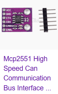

    for wiring i used an esp32 dev board with pin 4 and 5 for canbus crx and ctx and an
    mcp2551 dev board
    and esp32
    i already did not flash the build in esp32 of the tensionR system i have to check how they communicate with the can bus. please contact me before doing it for more information..
    for mover there is a online profile. search for motion4sim. the serial string should work the same way for simtools.

    Thank you very much @Thanos for expanding my post with your attendive addition. It's true and I usually don't think too much about such important things. I was of the opinion that everyone who takes $1000 in their hands thinks carefully about what they do with it. So folks please think carefully about what you are doing, if you delete the original firmware it will be expensive and you will lose the warranty. At this point I would like to point out again that the firmware only works with the external additional ESP32 and the CAN BUS transciever. So you don't have to delete the original firmware either. I will soon add a photo for the connection of the CAN BUS in the device. But the warranty is definitely out, but everyone should decide that for themselves.
