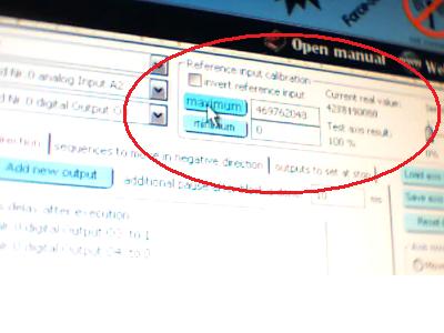

    I made my first test avex SIM1 , it works well.
    I installed Xsim2 (latest version) and took my first test.
    I use the card velleman and the relay card.
    I using as input a string potentiometers 22k ohm 20% linear .
    my motors (380v) are controlled in on / off with the card Velleman vith variable frequency.
    http://img34.imageshack.us/i/pict0159.jpg/
    later I'll add a command speed.
    when I caliber, the simulator moves in all directions and returns to center, but it varies when it comes to the center.
    I had difficulty to make the calibration, sometimes it does not center, I had to insist several times to make a good calibration.
    when I press start, the simulator moves non-stop left / right / left / right .... and front / rear / front / rear ......
    how to fix that?
    thank you for help.

    Riton, you have to describe the issue some more clearer. I dont know what you are doing there.
    Ok, the motors dont stop shaking, when you press start. But which profile have you running? Have you downloaded a profile here in the forum, or did you made a profile on your own? Which effects are you using? If you dont tell us your setup, we hardly can help you. Post your profile here, so that we can have a look on it.
    You are using the relay card and with no speed input to your frequeny inverters.
    That is why your motors are that jumpy imho.
    For now you can fix that a little bit, by increasing the max values in your profiles. Add some smoothness to the effects as well perhaps, and reduce the motor speed on the frequency inverters manually.
    But it will stay jumpy, until you will have added the speed command!
    Scottlolo69 or MboRacing may be able to help you with the Velleman and AC frequency inverters.

    I can adjust the speed on the frequency with a potentiometer, so the speed is average for the test.
    the same configuration with 1 profiler works.
    I made my setup, I did not find a configuration for my simulator.
    on the forum many people use snc5.
    I just applied 2 effect: lateral force and longitudinal force.
    but I think the problem is not here.
    I have not Started the game! juste by pressing start without games, the simulator moves left /right.....
    i think it's a problem with calibration or pots??
    thanks

    I tested with this version, I have the same problem.
    I done the calibration is ok, the simulator works, front / rear / left / right center and then stop.
    that's good.
    in the center action how many time i can put in the center action? i put 0 and it center and dont move, i think its good.
    then:
    with or without effect apply,its the same problem .
    if I press start the simulator moves without stopping shaking around the center.
    if I move my potentiometer motor position with my hand, it move , and follow the pot position.
    I think it does not stop in the center position and why??, i dont now
    is it possible to tell him to stop at the center?
    I do not even master the profiler 2
    may be , i have a bad setting on the setup outpout ....
    thank you

    When i am right, you have to tell the profiler the steps in both direction e.g. from 0 to 100000 in the synaptrix dialog.
    Did you already made that?
    Its well described here in the manual:
    http://www.x-simulator.de/wiki/Go_here_ ... ix_control

    I do not know if I have done things:
    for the x-axis:
    I turned the pot to the minimum 0 and i press minimum
    I turned the pot to the maximum , 4294967295 and I pressed maximum.
    I did the same thing for the Y axis
    I always have the same problem.
    when I press start, the simulator is controlled, the output of the velleman card is activated
    i have no effects :(

    If your pot seems to be fidgety you have to reduce the sensitivity in a later step.
    my pot value moove a little ,but when i moove the sensibility its the same problem.
    I spoke with scottlolo, he have the same problem.
    the other person uses Xsim 2 simulator with a cylinder or a motor?
    they should have that problem, they also used potentiometer as me.

    In your first video I see fast changing values from your pots (starting at about 0:35). I think this might cause your problems.
    Place your sim to center position and make a short video of the shown area with both axis ... 20sec. should be enough.

    with a joystick input, in place of the potentiometer, the values of position are fixed and the problem is the same.
    i make a vidéo with pots in input for you, and i make another with joystick........
